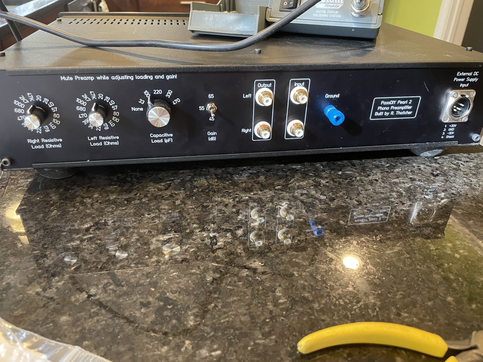

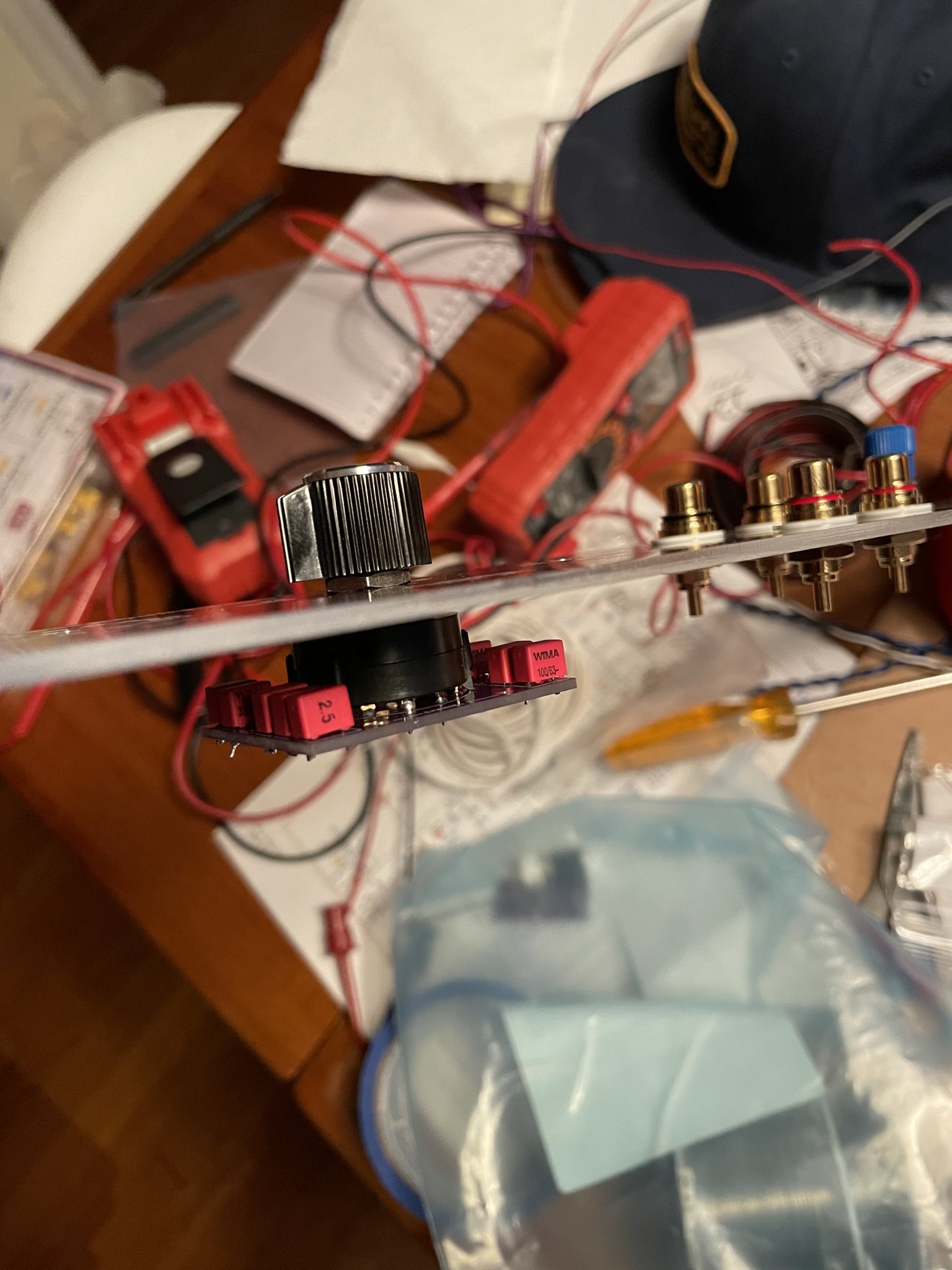

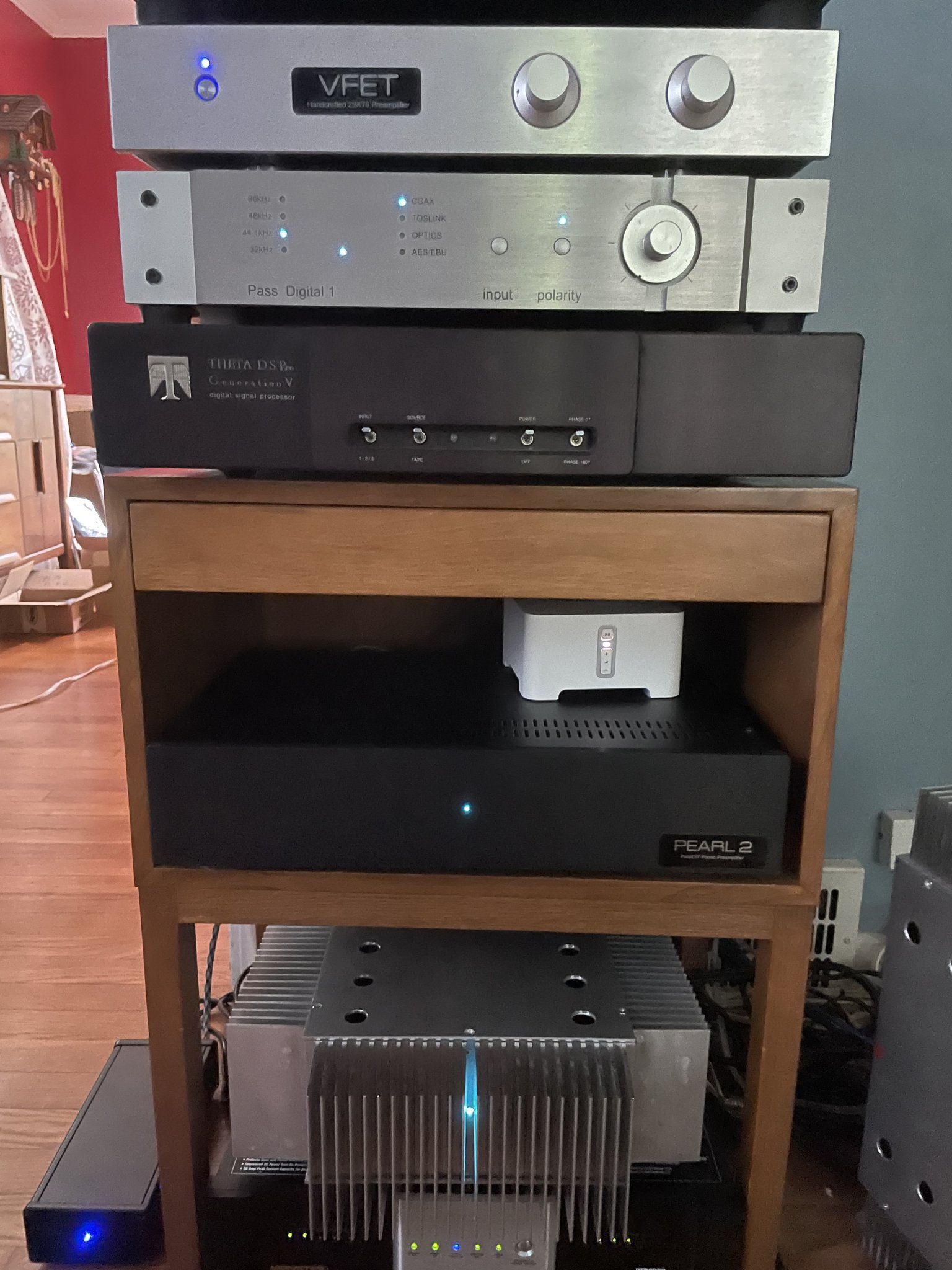

My Pearl 2 is done and singing! It’s running with a MM cart now, and I’ll try it on my big system soon with MC. The loading switches will be fun to play with on my MC cart.

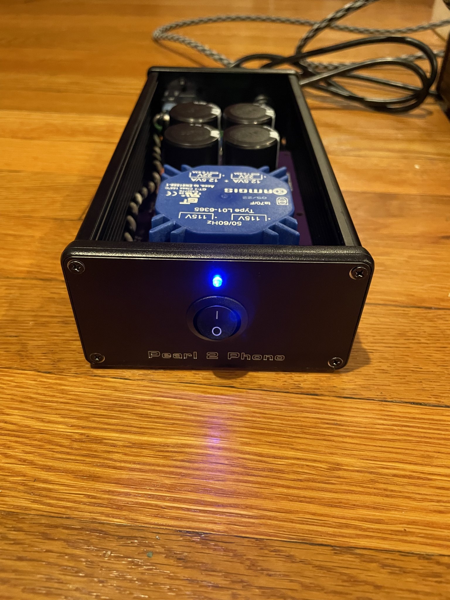

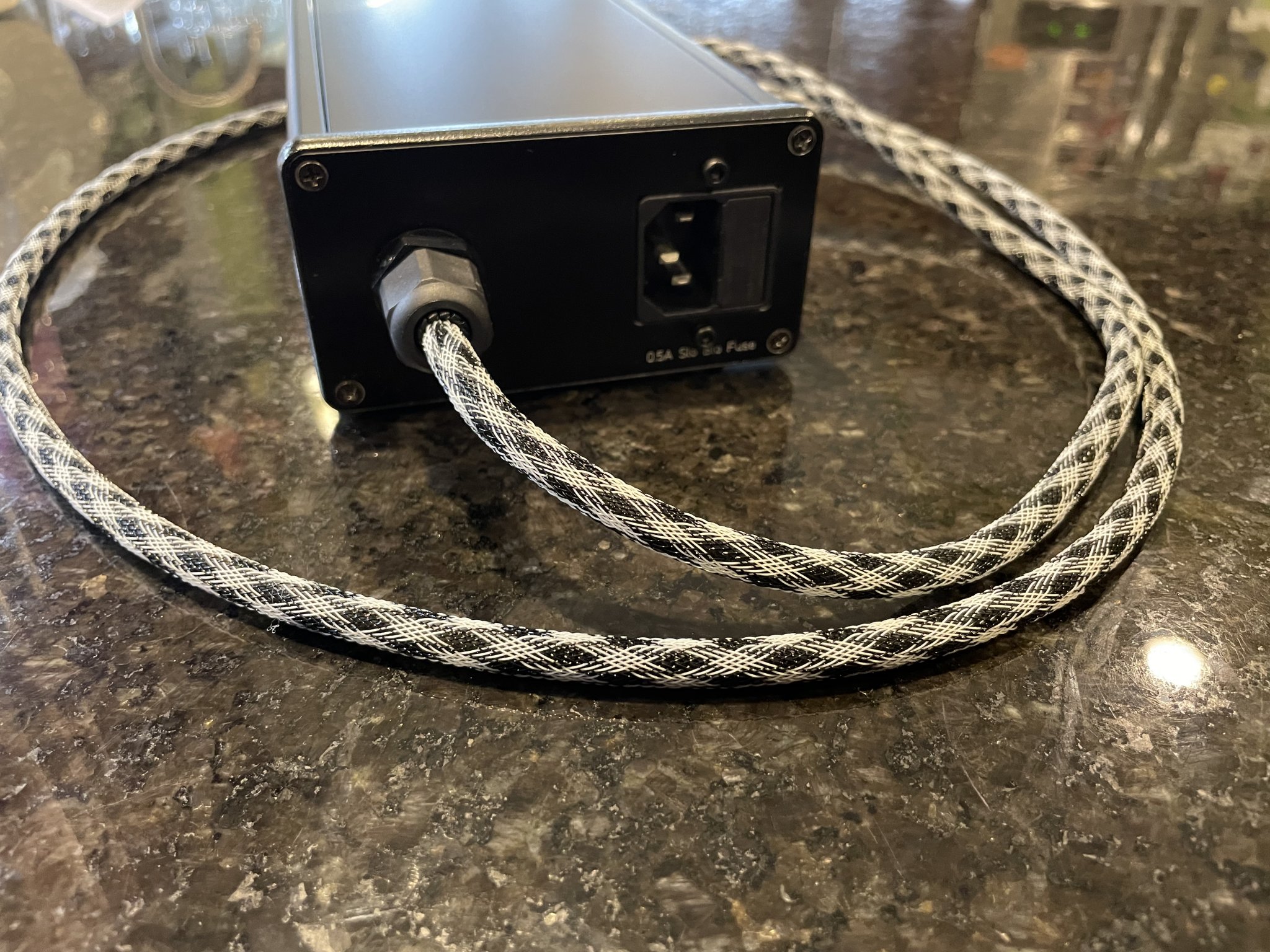

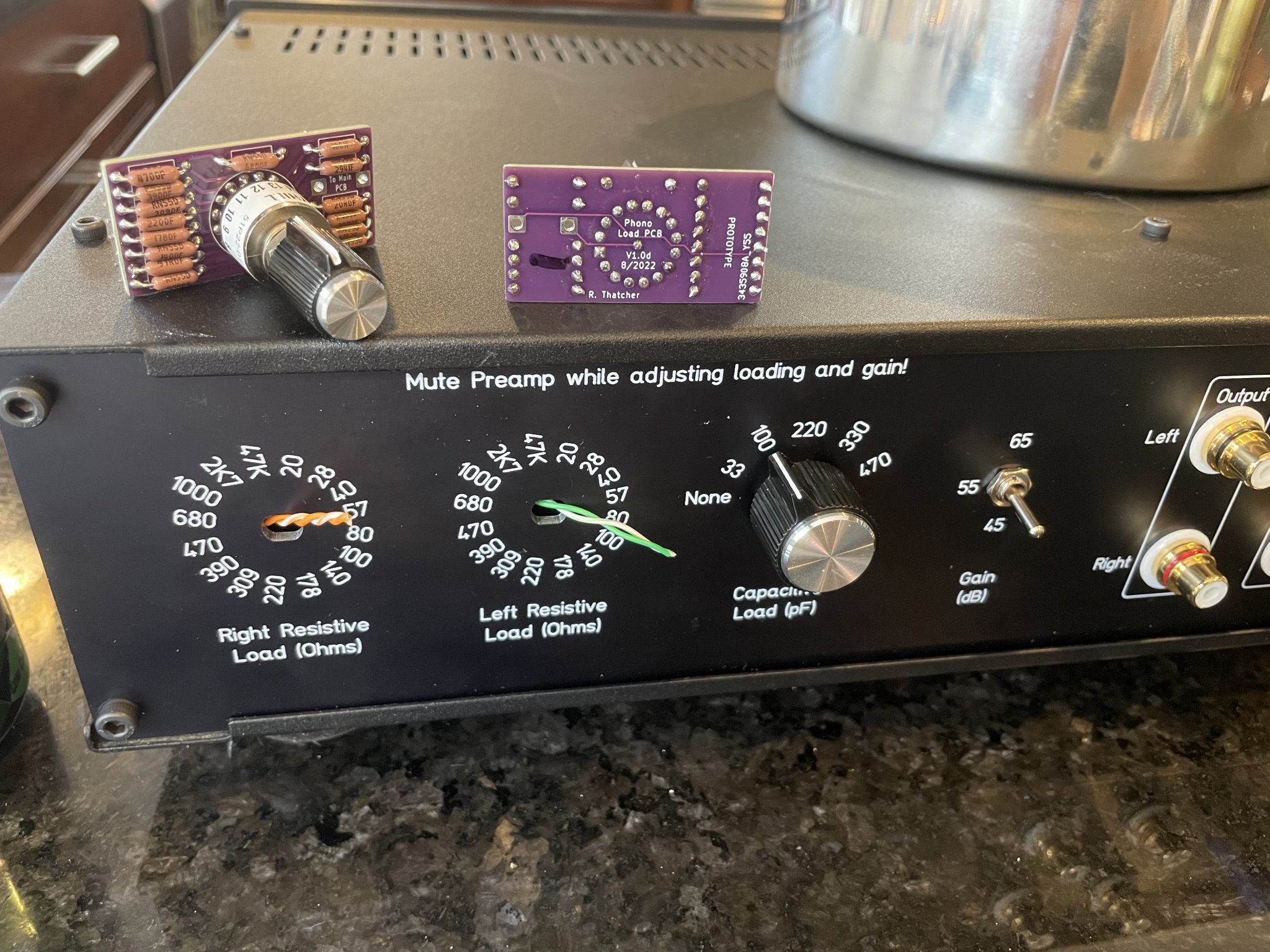

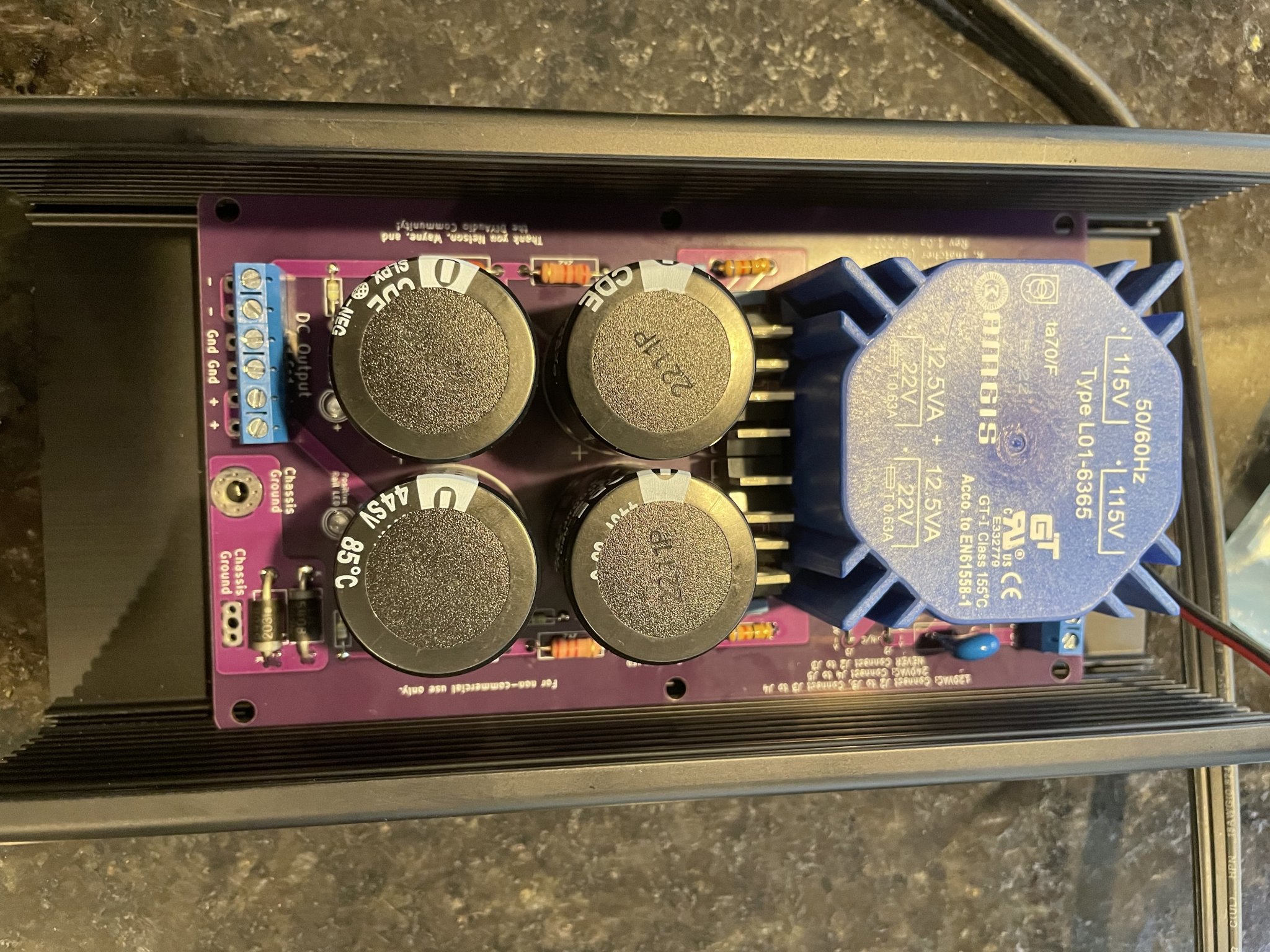

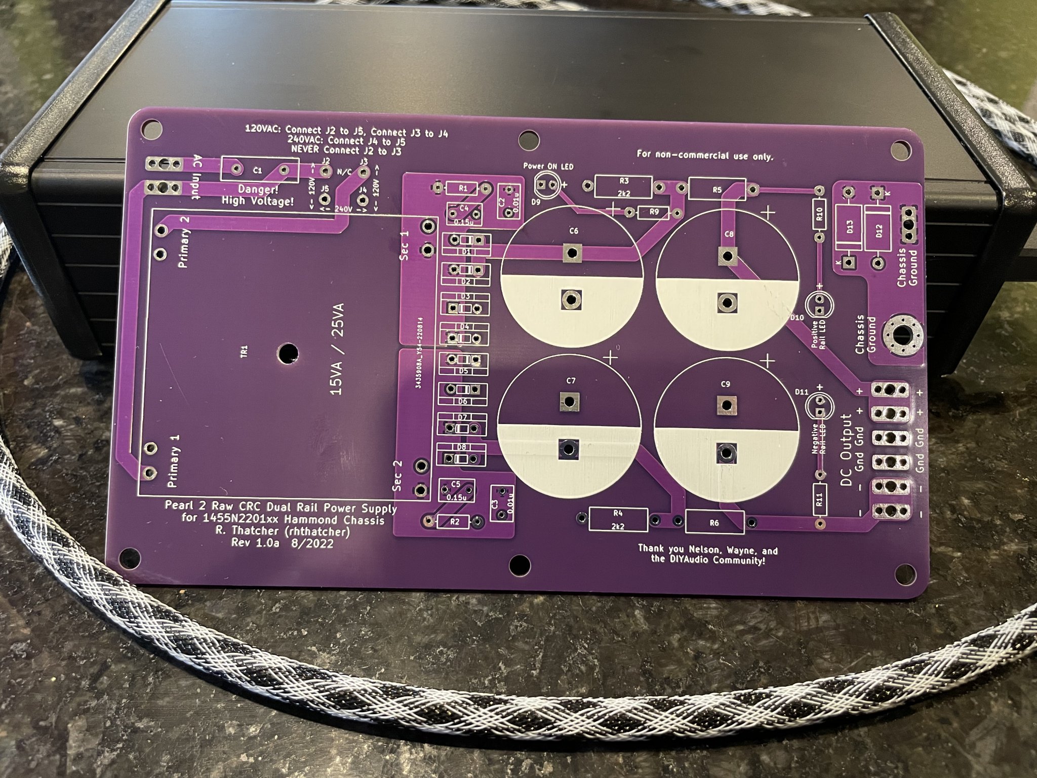

I made a CRC PSU with snubbers that fits in a small Hammond chassis. It’s workable, but I can think of a couple tweaks to the board. If anyone is interested in the R or C loading boards or PSU boards send me a message. I have extras.

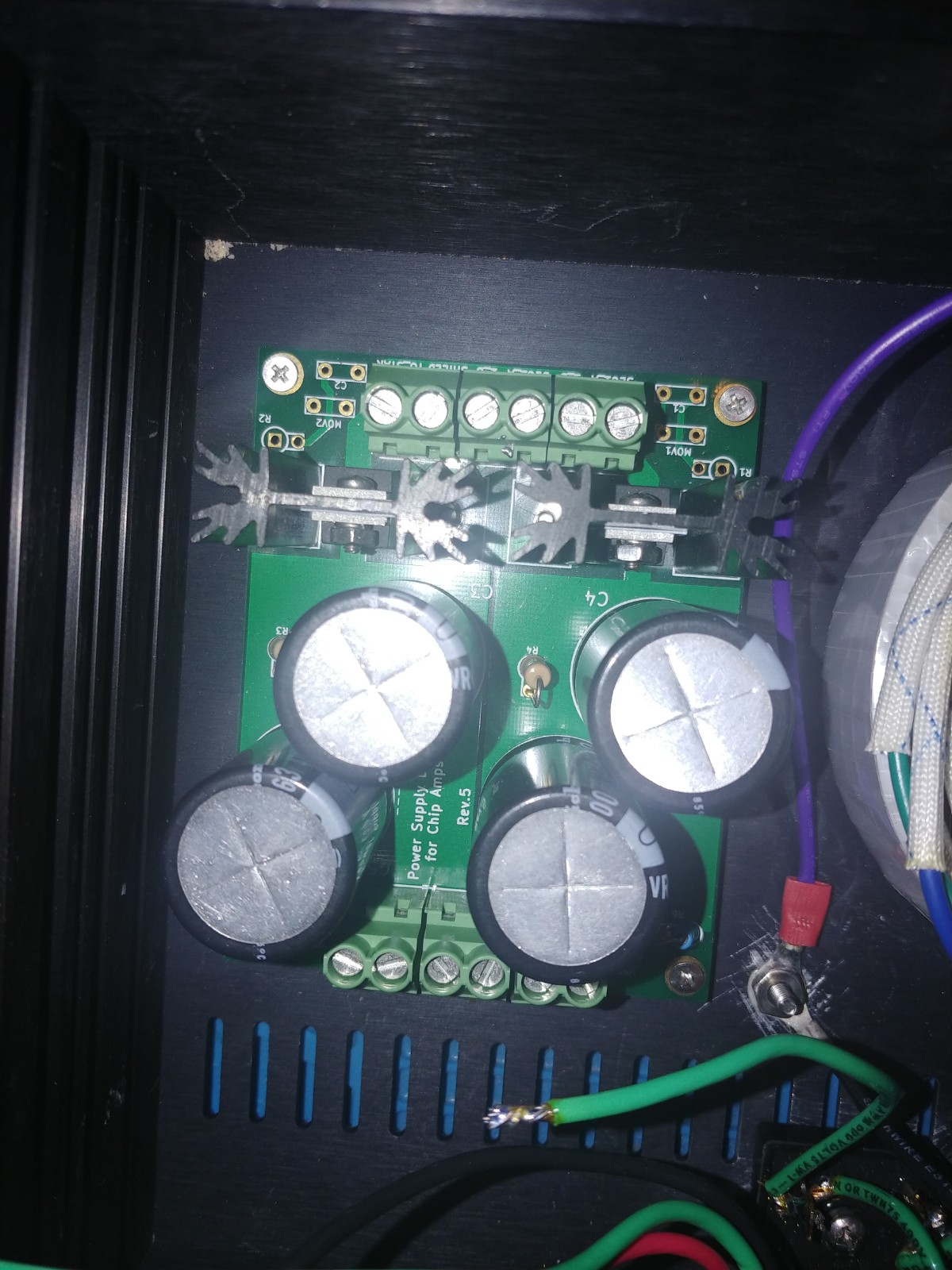

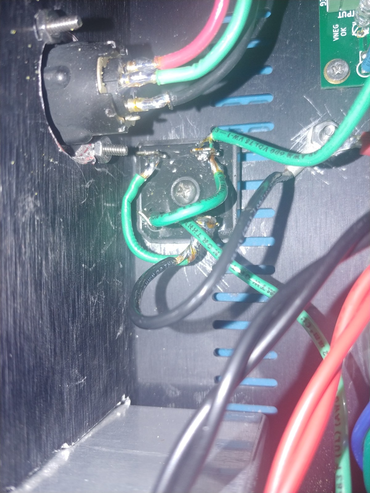

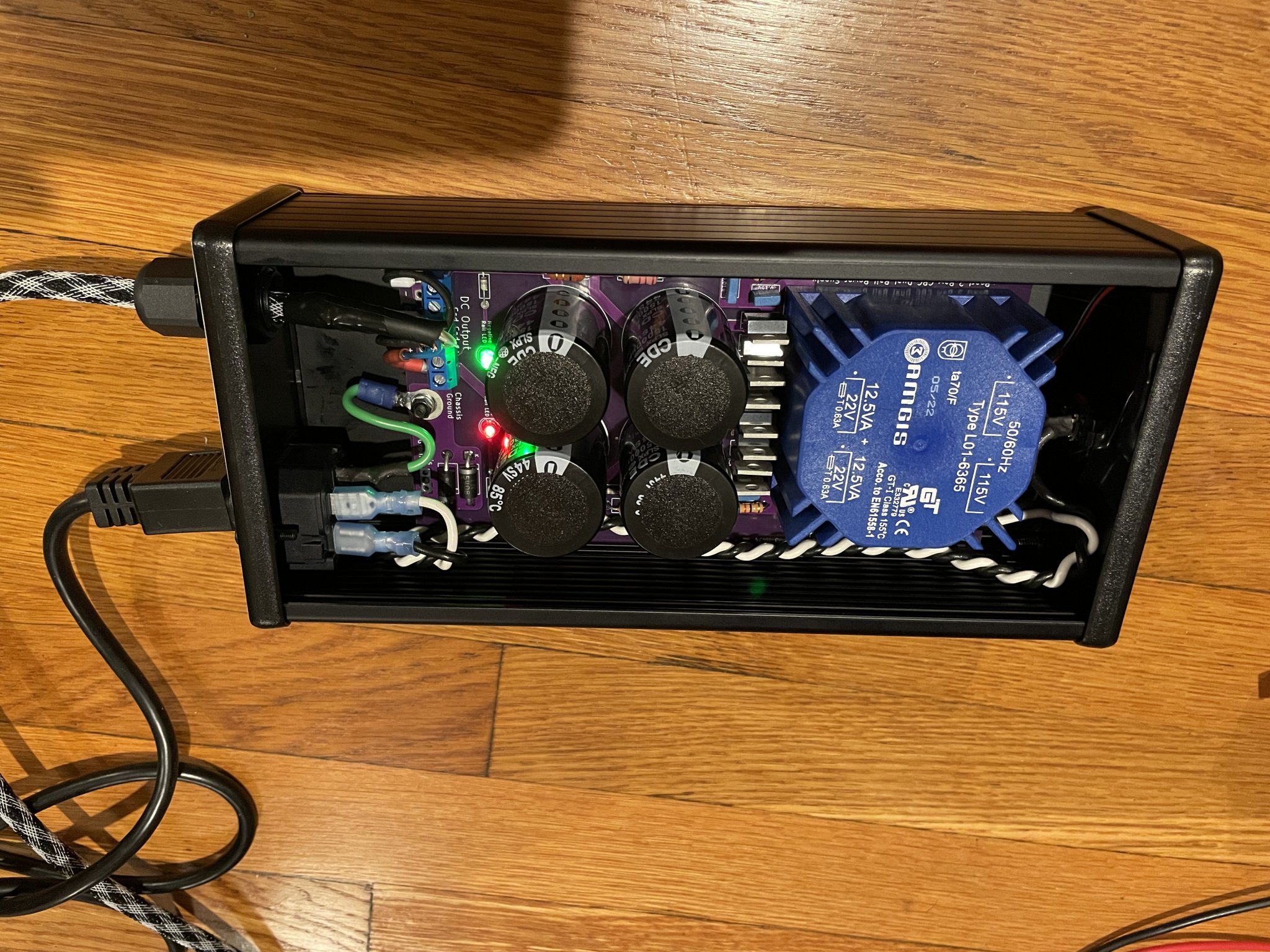

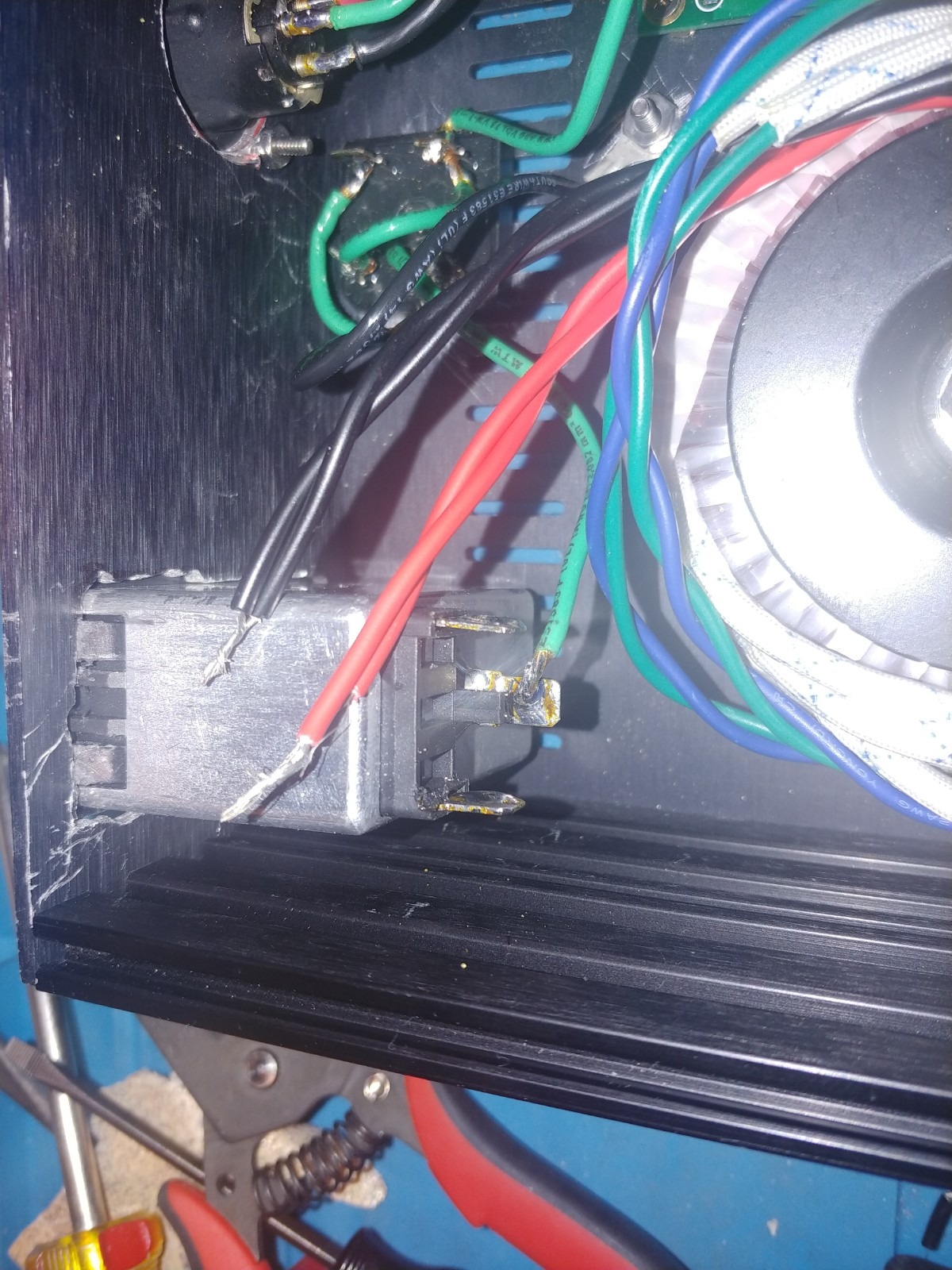

SOS! I need help. I was able to complete the phono section of the pearl 2 with no problem. However, I have hit a wall with the PSU. I have reviewed the various PSU's posted on this thread but none seem to give me insight on final wiring. Attached are photos on my progress. Can someone let me know if my layout is correct and if I am missing any components. any help would be extremely appreciated as the pearl project has been sitting on the shelf collecting dust.
Thanks.
Thanks.
PSU board input is nicely labeled, as is the output. The ground breaker bridge connects to “to star” or PSU GND.
Primary lead wire to AC live, trail to neutral.
Check PM
Check PM

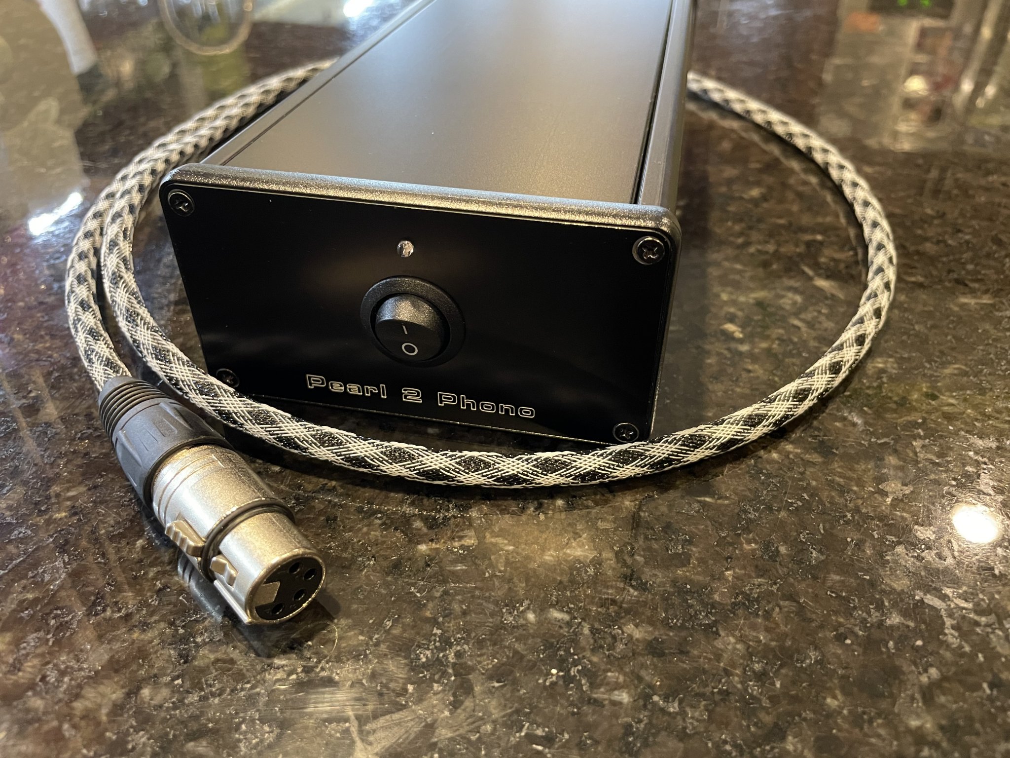

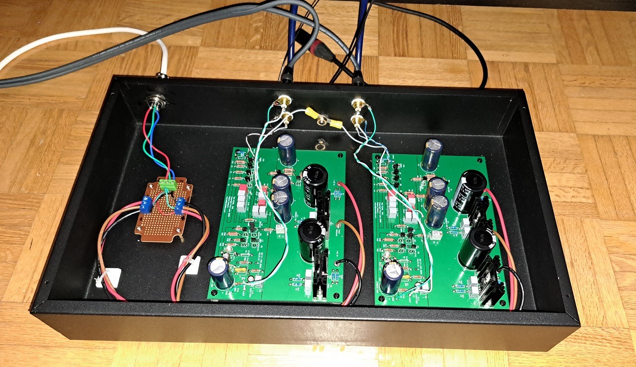

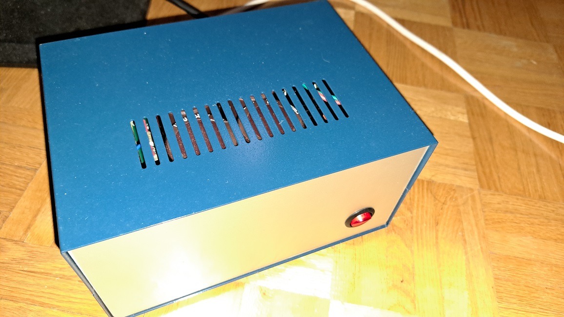

Here's my basic cheap and cheerful Pearl 2 build, which I have been working on and off (mostly off) for a quite a while. I used machine pin headers at the gain and loading resistor locations. The main chassis is a Hammond steel case and the external PS is housed in a recycled project box.
The build process was unremarkable though I did discover that if you leave out R14, the output is REALLY low. 🙂
The gain is the standard 55dB and so far so good even with my cartridge's spec'ed 0.25mV output. (This was not a surprise since I've used the same cartridge with another phono at a similar gain and it was adequate for me.)
I have a set of the original PCBs and matched jfets from PassDIY. But since I had this irrational fear that I would blow up my first attempt at building an MC phono preamp, I ended up ordering some boards using the Gerber files on PassDIY and used some low-ish IDSS (<7mA) 2sk170BL I already have.
Thank you Wayne for this wonderful project. And thanks to Jim for the very helpful build guide.
Dennis
