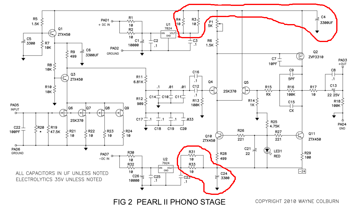

Voltage Change Question
If I change the voltage of power supply from 24V to 20V, do I need to change parameters in Pearl circuit? Because I use shunt regulator instead of linear regulator. Voltage drop of my shunt regulator is very high. This circuit cannot produce 24V.
Shhhh, don't tell anyone you're doing that. You will need to change the LM3xxx's so that there is at least 2.5V overhead.Voltage Change Question
Correct me if I am wrong, but the relatively high voltage allows enormous and effortless overhead margin.
OTOH, I run the "Pearl Minnie" with one of Jan Didden's very quiet SMPS regulators -- you can use a pair of 18650's to run it for +/- 15VDC/

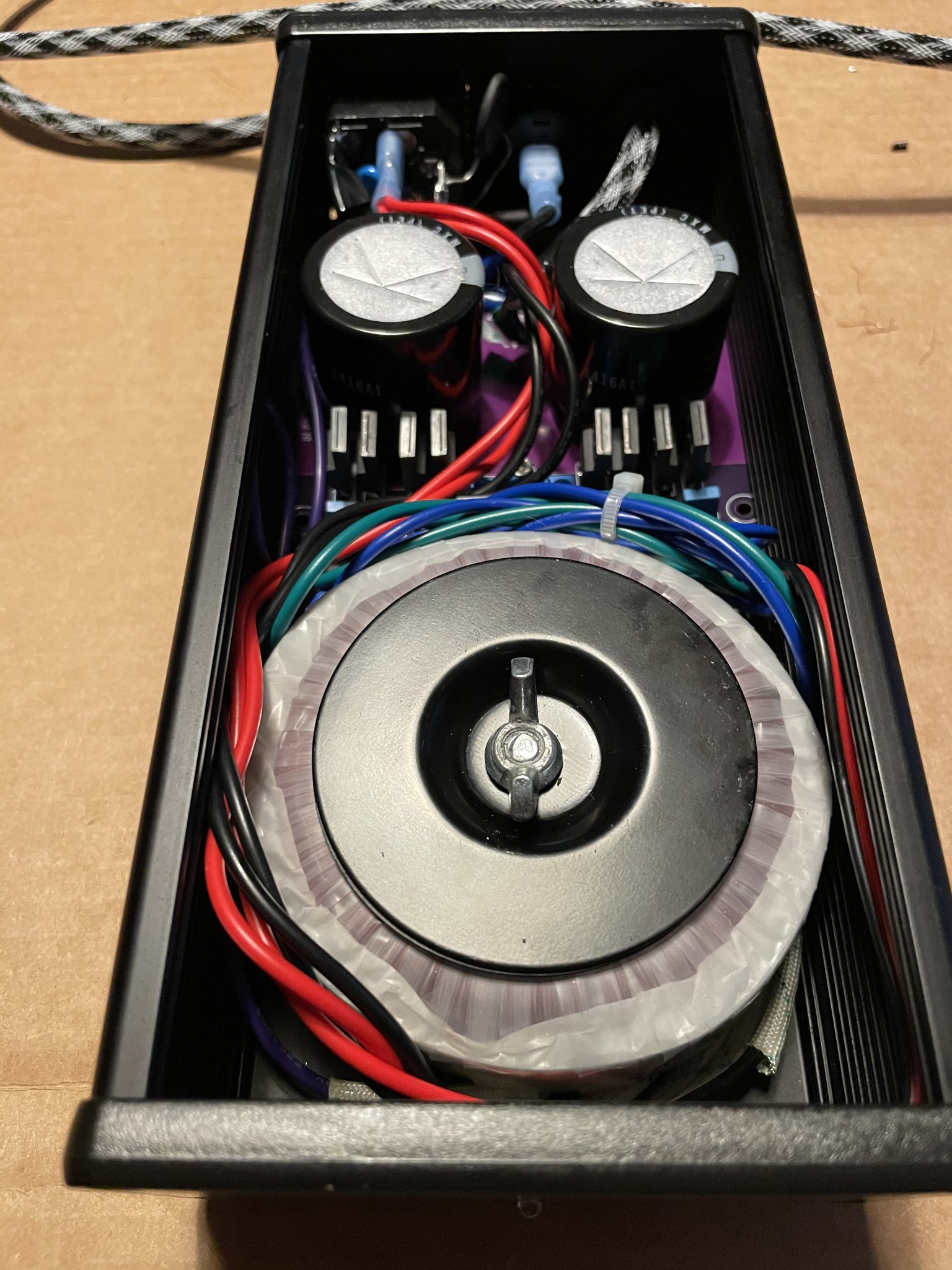

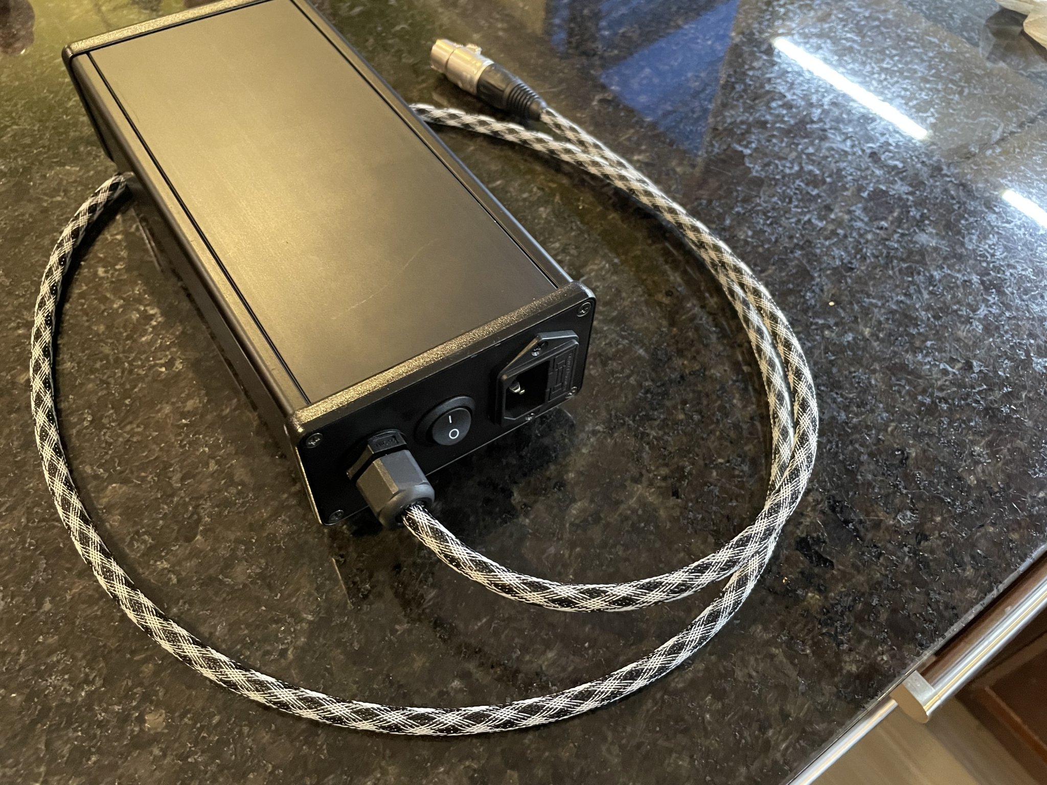

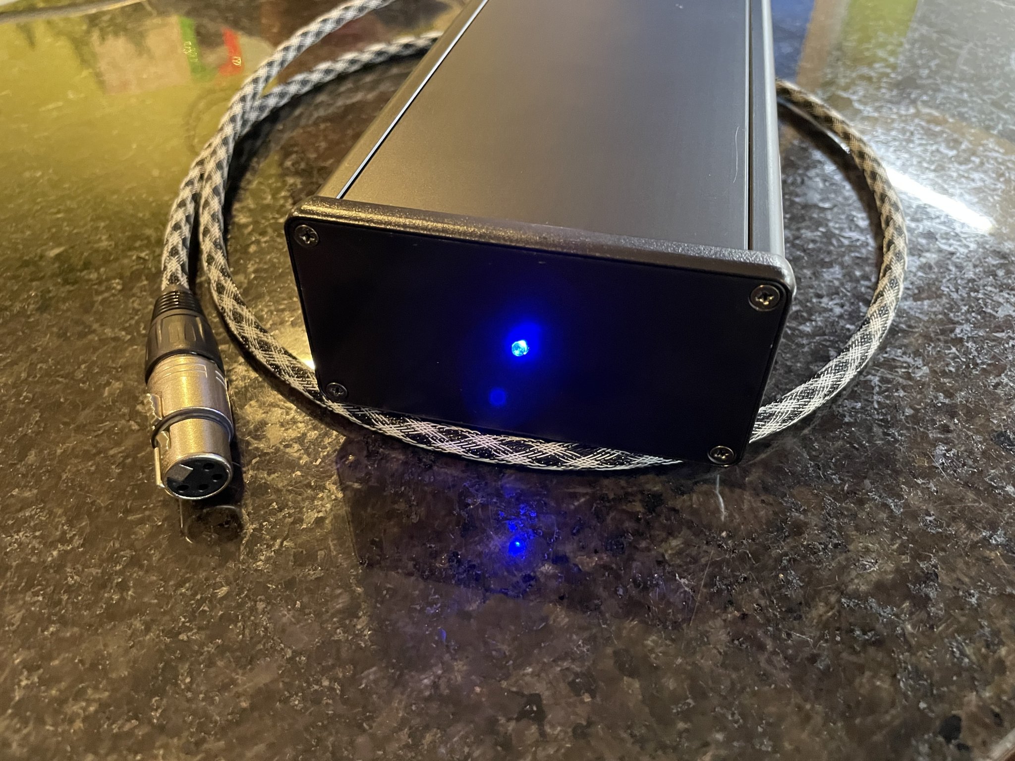

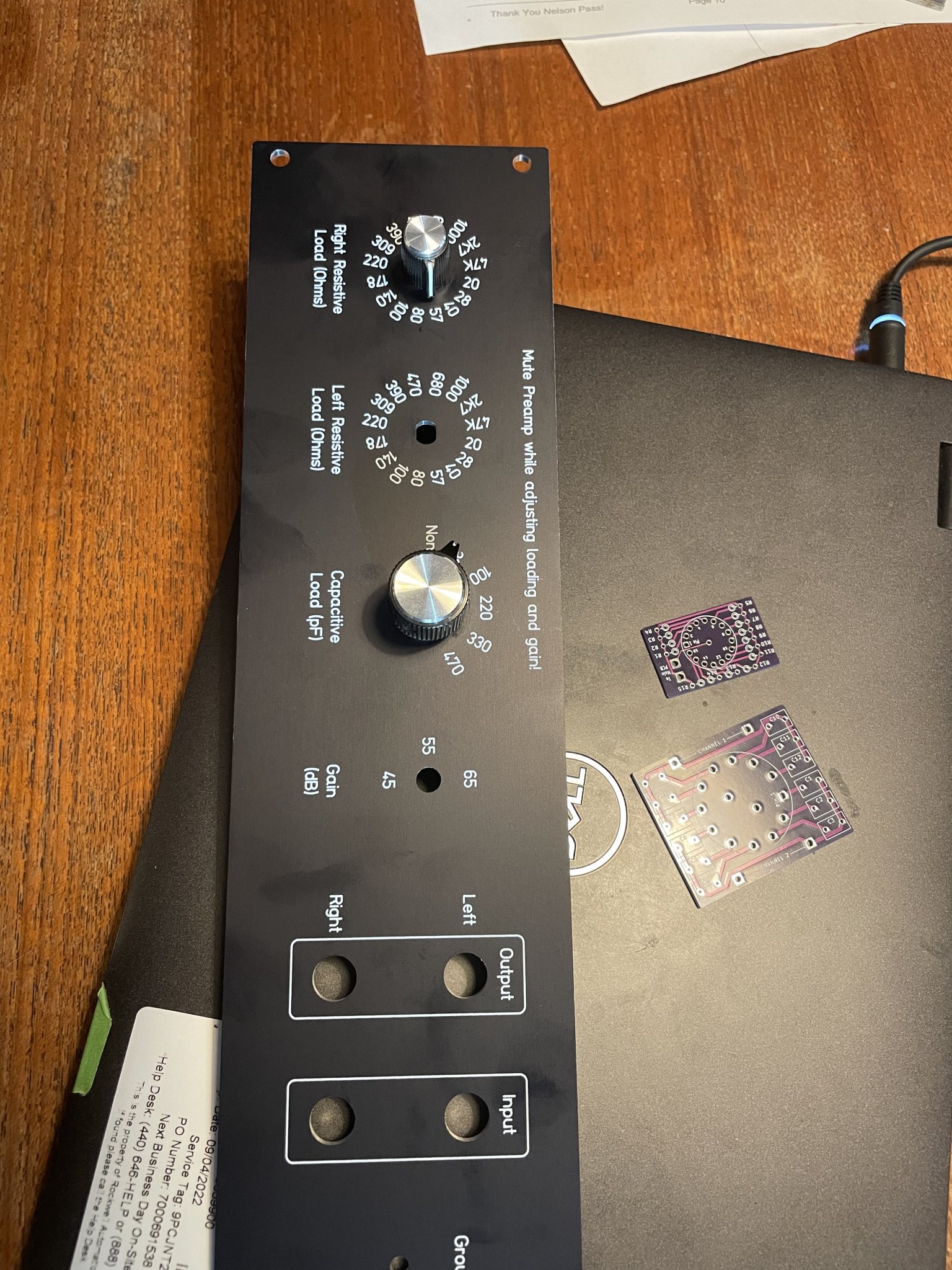

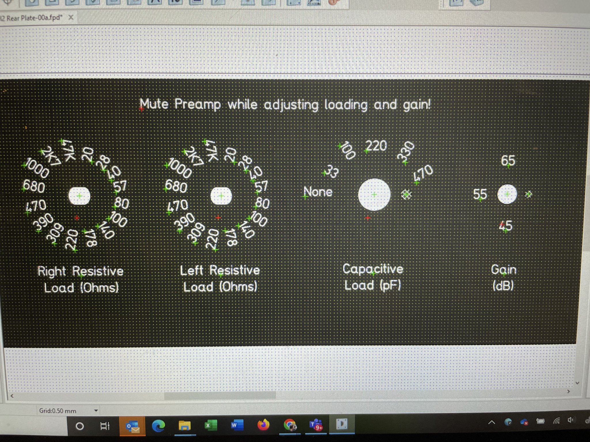

My PSU is done and tested, and the chassis is partially built. I'll get to PCB's in the coming weeks. I'm going to be making mine for use with MC cart primarily, but it will have a switch for 45/55/65dB gain.

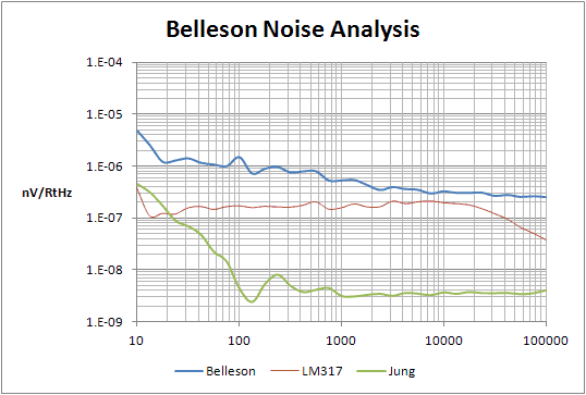

The Belleson regulator doesn't win any prizes for noise. (See attached chart, noise should be V/RtHz) In fact, if you dig way back in this thread I measured the Pearl II noise with the conventional regulators and the Jung-Didden regulator and couldn't detect any difference.Has anyone replaced the 7824/7924 regulators with Belleson or Sparkos units?
If you can't find the fixed voltage regulators, you can use LM317/LM337 with 10uF from the ADJ pin to ground. In fact, it's much lower noise than the 7824/2924. You will have to make some adjustments to the mounting as the pinouts differ.
I’m thinking of a single positive regulator for a line stage I’m working on. I’ll build the Pearl 2 to spec.Pearl2's R3 and C4 will improve the noise performance of ANY regulator you drop in.
I purchased the Belleson to compare "blindly" to the regulators in the Linear Audio article. The Sparkos weren't on the horizon at that time. If they send a pair, I can re-run all the tests (PSRR, Noise, and Output Impedance).@jackinnj - have you run similar tests on the Sparkos regulators? I don't know how similar or different they are compared to the Belleson. They seem conceptually similar, but I don't know the details.
I can say with ontological certitude that Elvee's noise reduction circuits are an inexpensive high quality addition to the pantheon of high quality regulators.

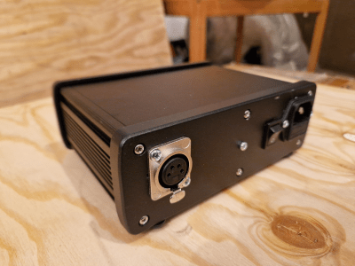

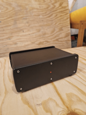

Coming along nicely. Just finished the PSU as the PCB's and FET's arrived from Pass. Unfortunately I did not see the "ugly psu cabinet" competition before I had ordered a rather nice box for my PSU
. Oh well, I guess i can hide it away anyway, and it's too small to stack components on anyway 🙂
Populated the regulators and filter components. Voltages checked out. Started populating the rest of the resistor. Very nice boards by the way!Coming along nicely. Just finished the PSU as the PCB's and FET's arrived from Pass. Unfortunately I did not see the "ugly psu cabinet" competition before I had ordered a rather nice box for my PSUView attachment 1078594View attachment 1078597. Oh well, I guess i can hide it away anyway, and it's too small to stack components on anyway 🙂

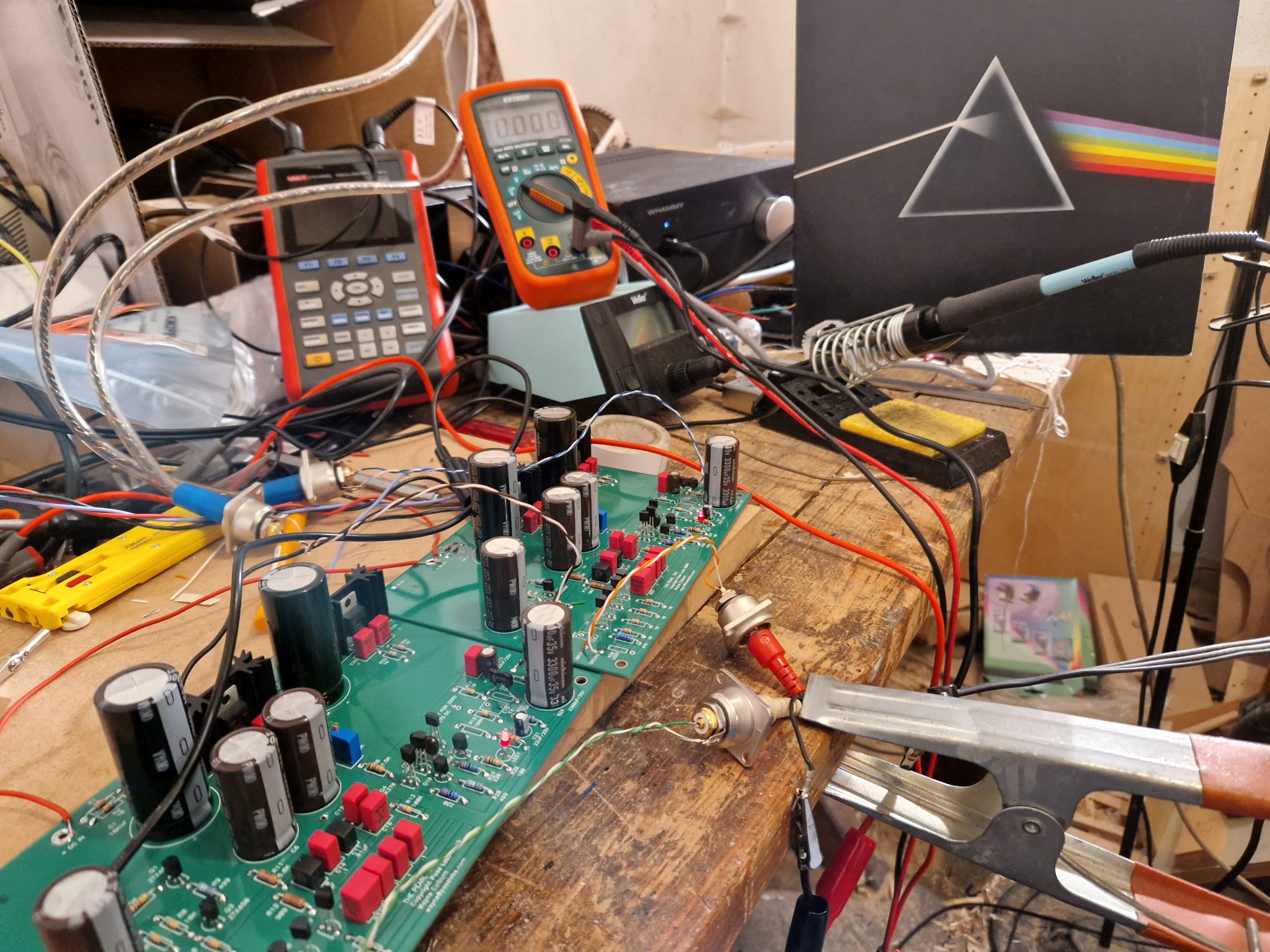

Boards done, getting sound though, shows potential but some strange noises are present. That is probably related to a big oscillation at about 7.1 Mhz occuring on both channels. The first trace of the oscillation I see is at both source and drain of Q4. Nothing at the gate that I can see on my scope. So it originates in the "output stage" it seems. So we are getting positive feedback here somewhere, now to find out where and why. I have both c7 and c9 installed, no c15 and R15 is a jumper. Bias is fairly stable around 0 once warmed up a bit. Any Ideas what to try to get rid of the ocsillations? Searching this thread it seems possibly C7 may be the culprit so will try to take that one out.
And jupp, it was the c7's in my case as well. C7 gone and oscillations gone. Now this thing is playing music already,even when just connected like this.
Sure I am getting a little bit of hum but thats to expected. Now can't wait to get it boxed up. But also need to set gain for lomc. Now testing with MM Goldring 1042. Even that sounds scary good already. Thanks to those who had posted about the oscillation problem and solution!
