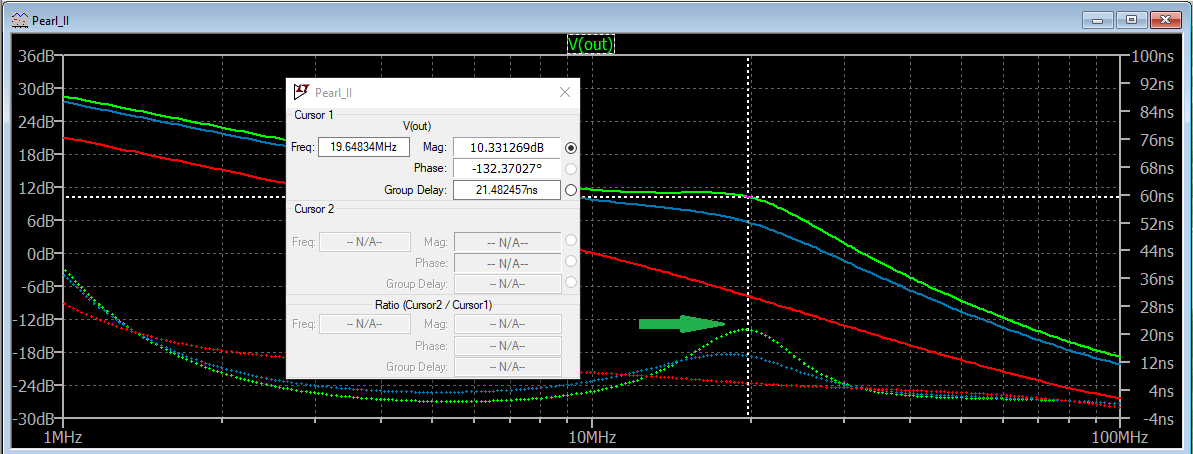

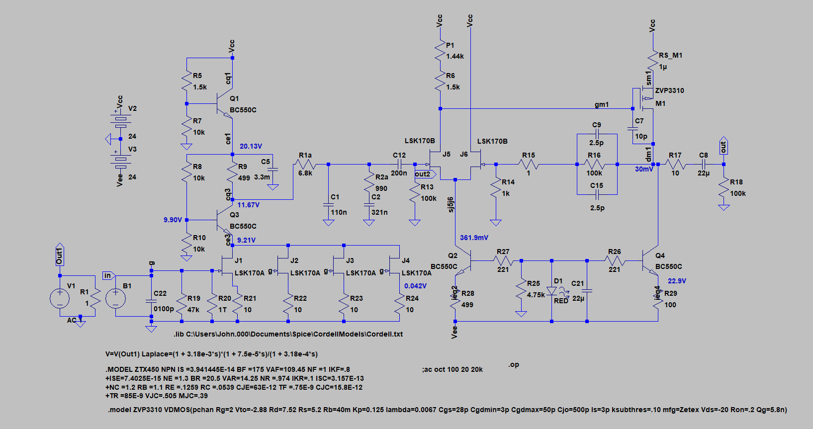

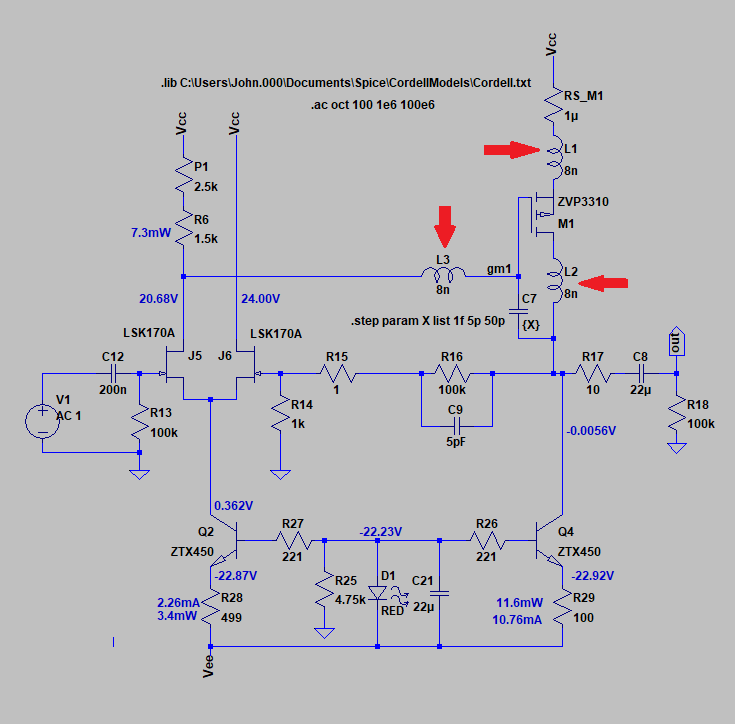

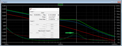

I was going through Bob Cordell's "Designing Audio Power Amplifiers" to find an example of C7. The thought came to me that the output MOS has significant parasitic inductance, so let's see what happens if C7 is simulated as 1fF, 5pF and 50pF.
Instead of plotting phase on the right Y-Axis, I plot group delay. The "Q" of this circuit at 19.6MHz is:
Q= Tg * f * pi = 21.6ns * 19.6MHz * pi = 1.3
When C7 is 1fF the output PMOS is not adequately damped. With C7 of 5pF, group delay is cut in half and the circuit is adequately damped.
This is a guess. Will put it on the network analyzer to see what's going on in reality.

What about when C7 == 10pf ?
Thanks -- what does the spice model show when C7 = 10pF (the value that Wayne had us put in) ?

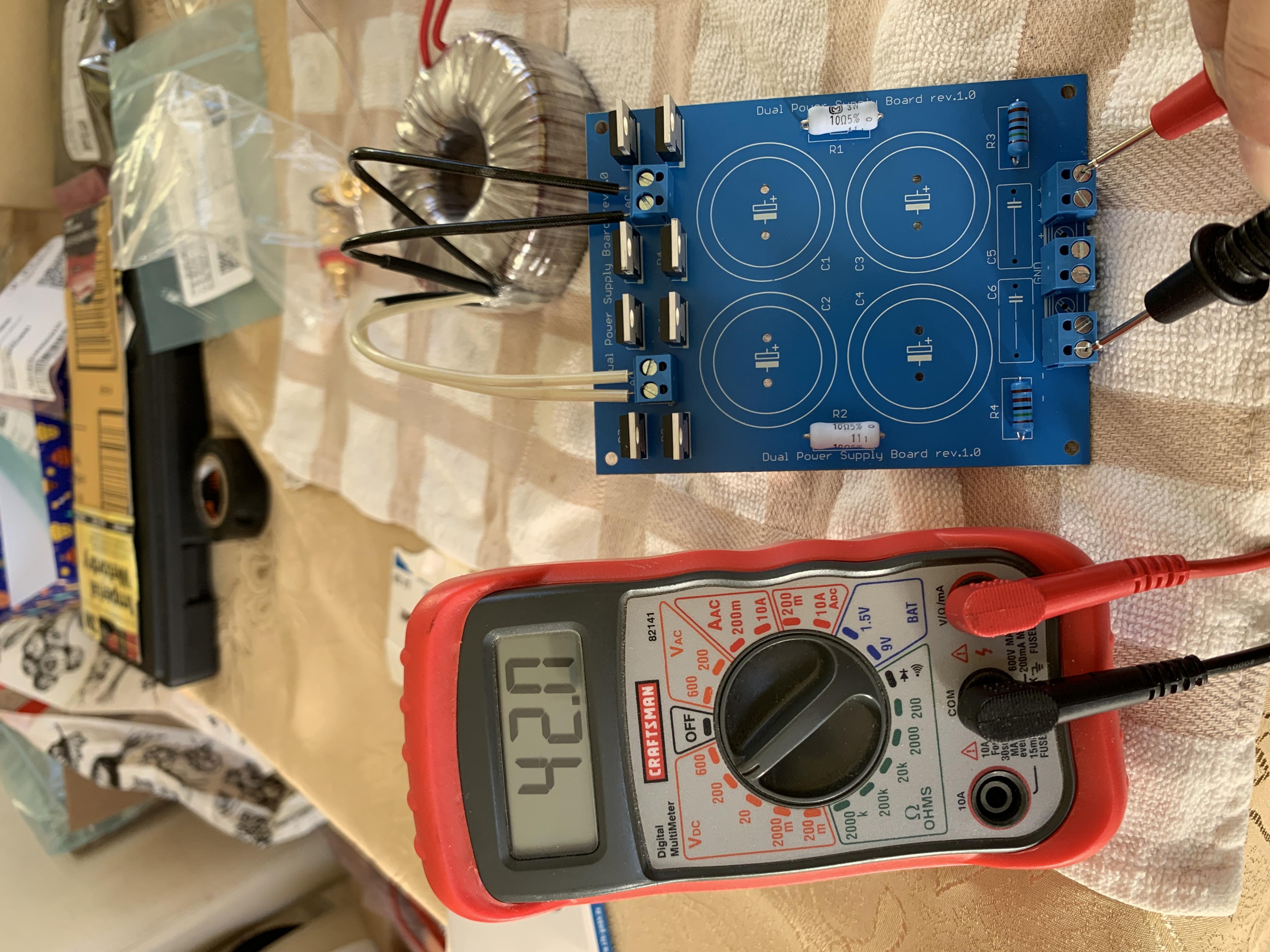

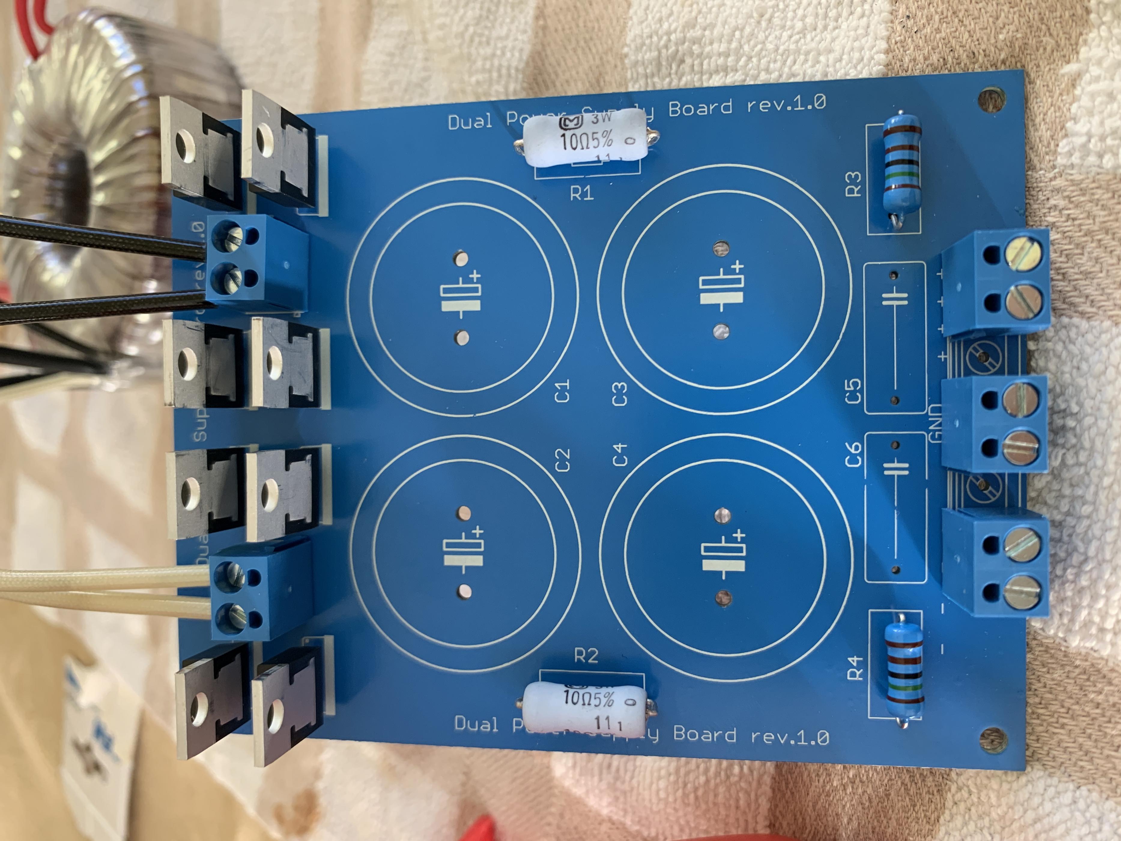

I made some progress guys with the power supply but I have a issue - still missing the capacitors. I have received some parts from Digikey and only today when started to solder I noticed when unwrapping the capacitors that they sent me the wrong stuff. Instead of Cornell Dubilier 50V / 10.000 uF @ 105C they sent me Rubycon 35V / 15000 uF @ 85C. I will write them, hopefully will work out because they sent me the parts from US to Europe.
So I soldered all except the capacitors and LED's.
Tried to see if the thing works so far and I am getting + / - 42 V.
Am I on the right path?
Thanks.
