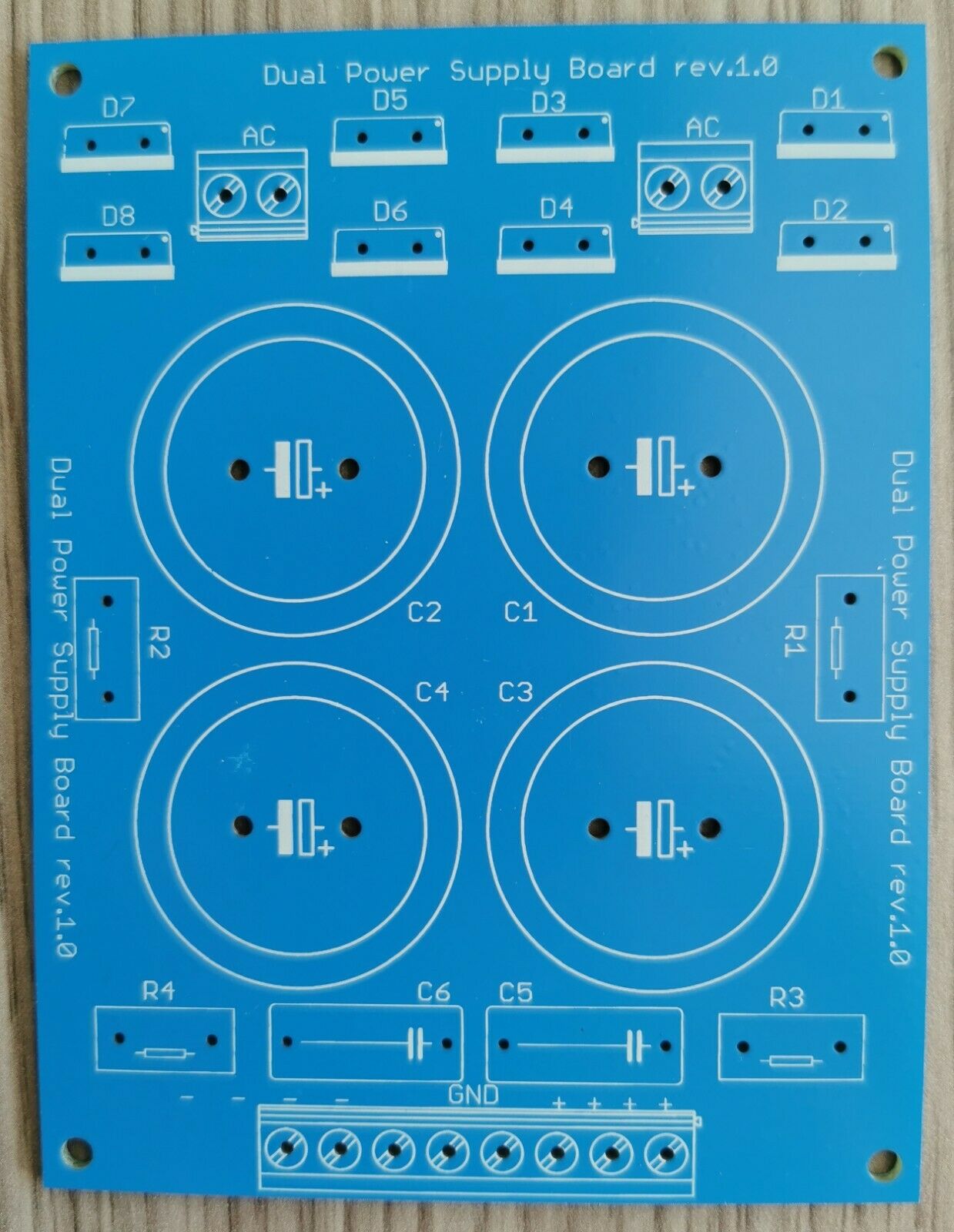

I have decided to build a Pearl 2 myself as fun and remembering my teenage time when I was passionate about electronics as a hobby. Meantime I became a mechanical engineer so I am by no means a specialist. I can solder, I know the basic concepts - capacitors, transistors, etc and how they work by cannot decide on components values..schematics ...etc.

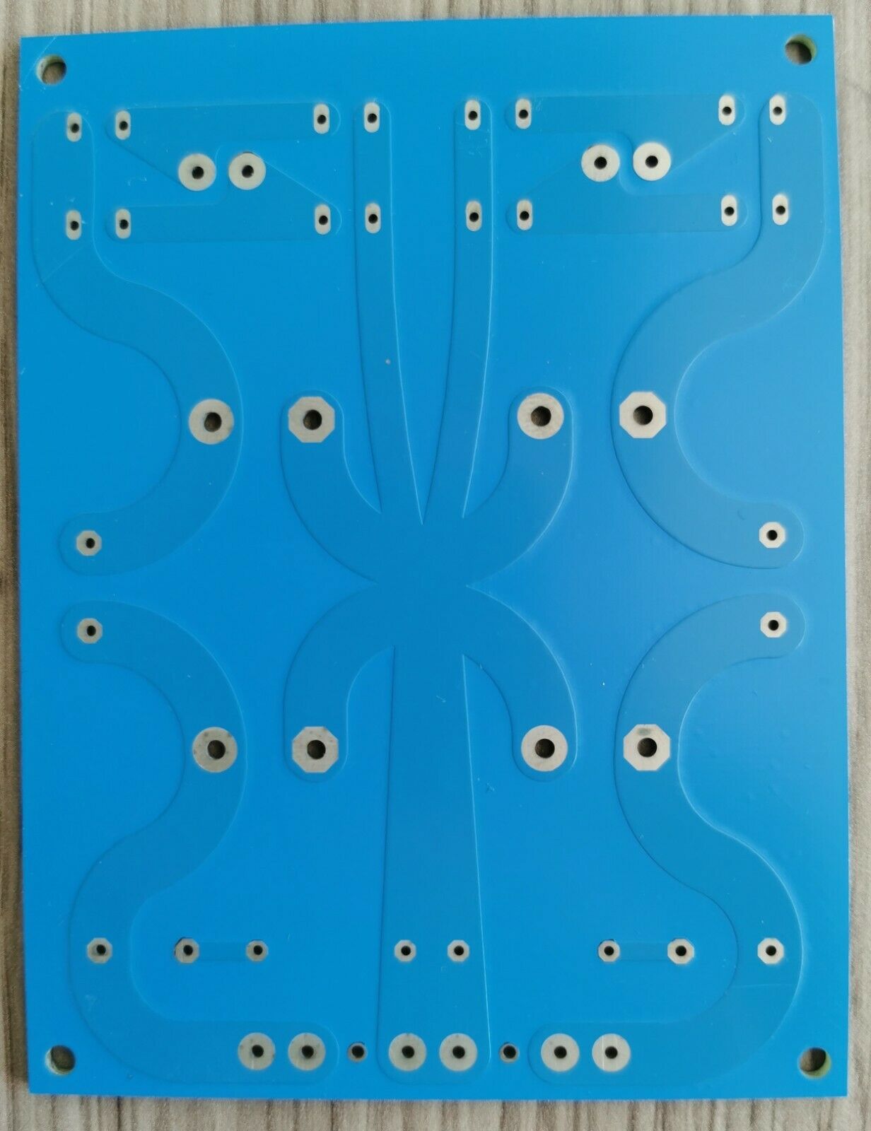

Before ordering the 2 PCB's would like to have a start on the power supply. I have ordered from Ebay a generic board which in my mind was the closest I could find compared to the original design - see attaches both sides of the PCB.

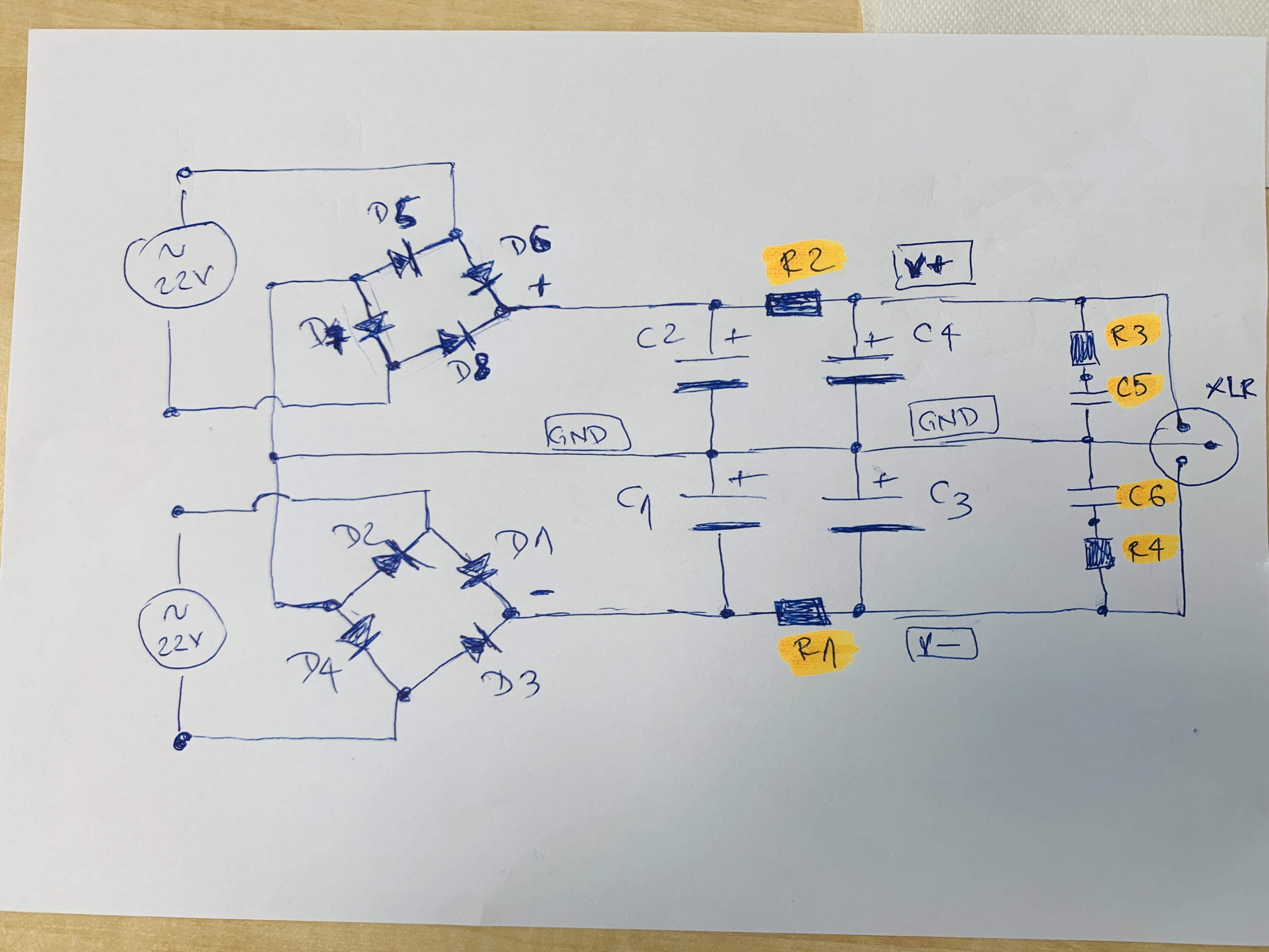

First of all - please le me know if I drew correctly the schematic of the purchased PCB.
Second - can you please let me know if I should leave out (not use) R3, R4, C5, C6 and connect with wire R2 and R1?
Third - since I have space for 4 capacitors 30mm diam each, should I stick to the original design - 2 x 10000 uF / 4 x 5000 uF or should I go with more and if yes how much?

Don't forget some bleeder resistors to drain the capacitors in case the power supply is turned on without being connected to the amplifier.
I agree with the previous 2 comments, so you could replace C5 and C6 with jumpers and use R3 and R4 as bleeder resistors. About 1K to 2K and 2W should do.
Cheers
Vic
...or use left R4 hole and right C6 hole & left C5 hole and right R3 hole for bleeder resistors, without jumpers
Yes! Even simpler

Thanks taking your time guys to reply for my help. Here is a summary of what has been proposed:
1) wrong diode drawing on lower bridge (peppennino)
2) use 3W 10 Ohm (or lower) as R1 and R2 for a CRC filtering (peppennino)
3) Leave R3 R4 C5 C6 open (6L6)
4) bleeder resistors to drain the capacitors in case the power supply is turned on without being connected to the amplifier - replace C5 and C6 with jumpers and use R3 and R4 as bleeder resistors. About 1K to 2K and 2W should do (vcec)
I have corrected the lower bridge - 1) and added R1 & R2 per - 2) - and R3 and R4 per 4).
I know that 6L6 gave me the advice to leave out R3 R4 C5 C6 so at this point I am split between directions

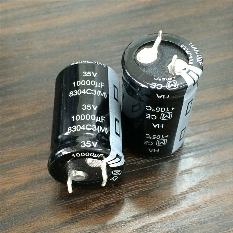

As far as capacitors after a lot of search I have found on Mouser Nichicon UKT and on Ebay Panasonic HA. Thought it was easier to find this 10k capacitors...
Which one do you think is better to use?

About caps: Why not pick something currently available on mouser and not
resort to ebay? Here's a nice one, and there are many others:

One thing about the caps is that you probably should consider those with
diameter <=25 mm because that's the spacing available on the Pearl 2 PCB
for the power supply caps. So you might as well use the same ones in both
positions.
2) I'd use use 3W 10 Ohm (or lower) as R1 and R2 for a CRC filtering
These CRC filtering resistors need to be wire wound type?
No, resistors R1 and R2 in the CRC filter do not need to be wire wound. Whatever is easier to get will be fine.
