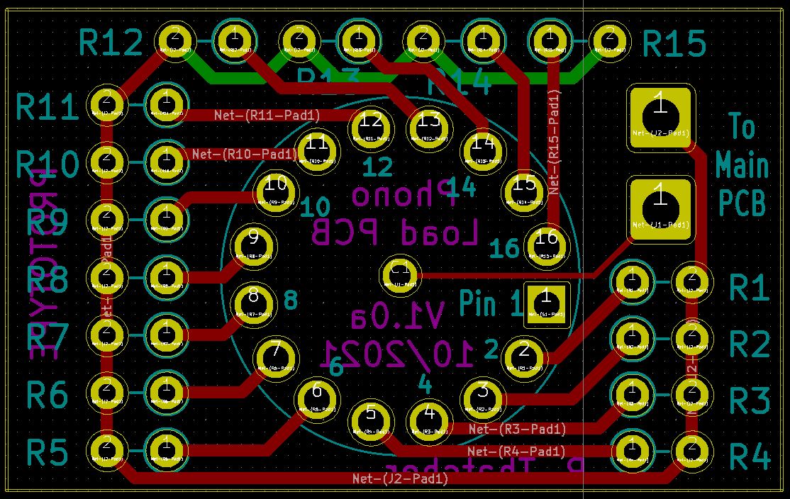

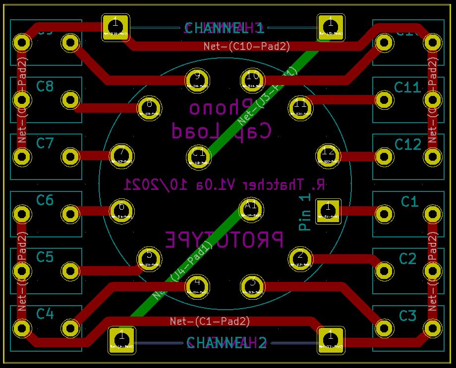

One thing I'm going to play with is the capacitor and resistor loading using rotary switches. My buddy's EAR phono has something like this, so I thought I'd build on that concept. I sent these boards off for fab last night, and the switches are inbound, too. I'll report back on how they work out. If anyone wants to beta test, I'll have extra boards.
The idea is one switch for caps on a DP6T switch with 5 cap values plus leaving one open for no cap loading.

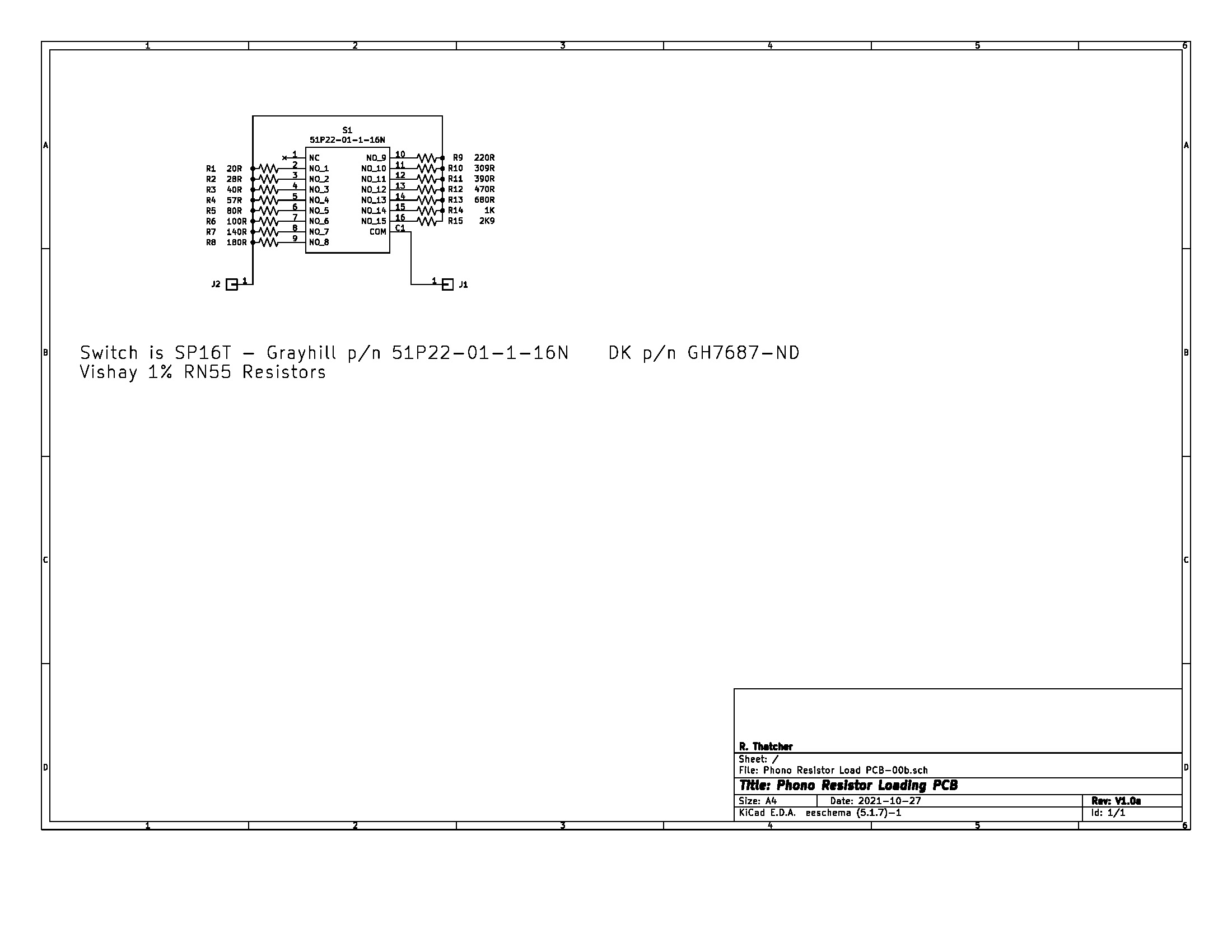

Resistor loading will be one 16 position switch per channel. All resistors are parallel to the 47k5 on the main board. 15 resistors on the switch + one open position for 47k5 loading.

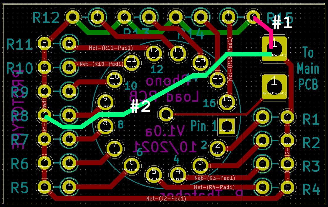

Mark - nice catch! I wasn't thinking to do that at 1AM when I finished... It's easy (and cheap) to throw a few more boards into an existing order, so I added those traces. And while I was at it I made a new wider version with updated resistor footprints. So I'll have vertical and horizontal resistor PCB's to see which I like better...
