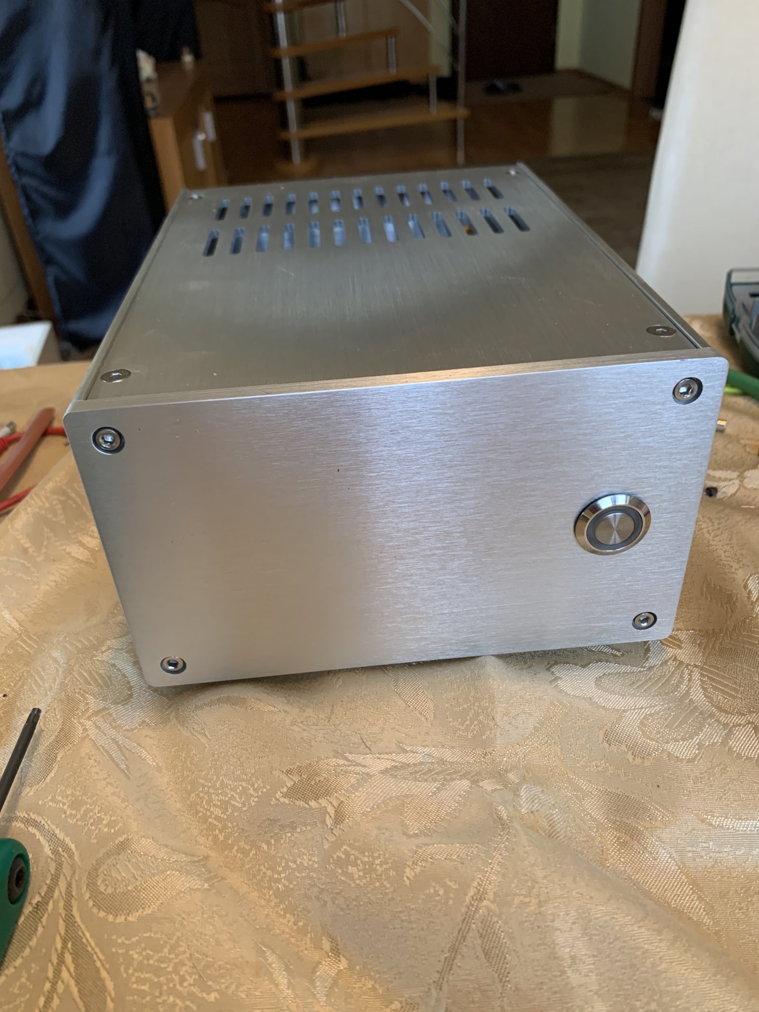

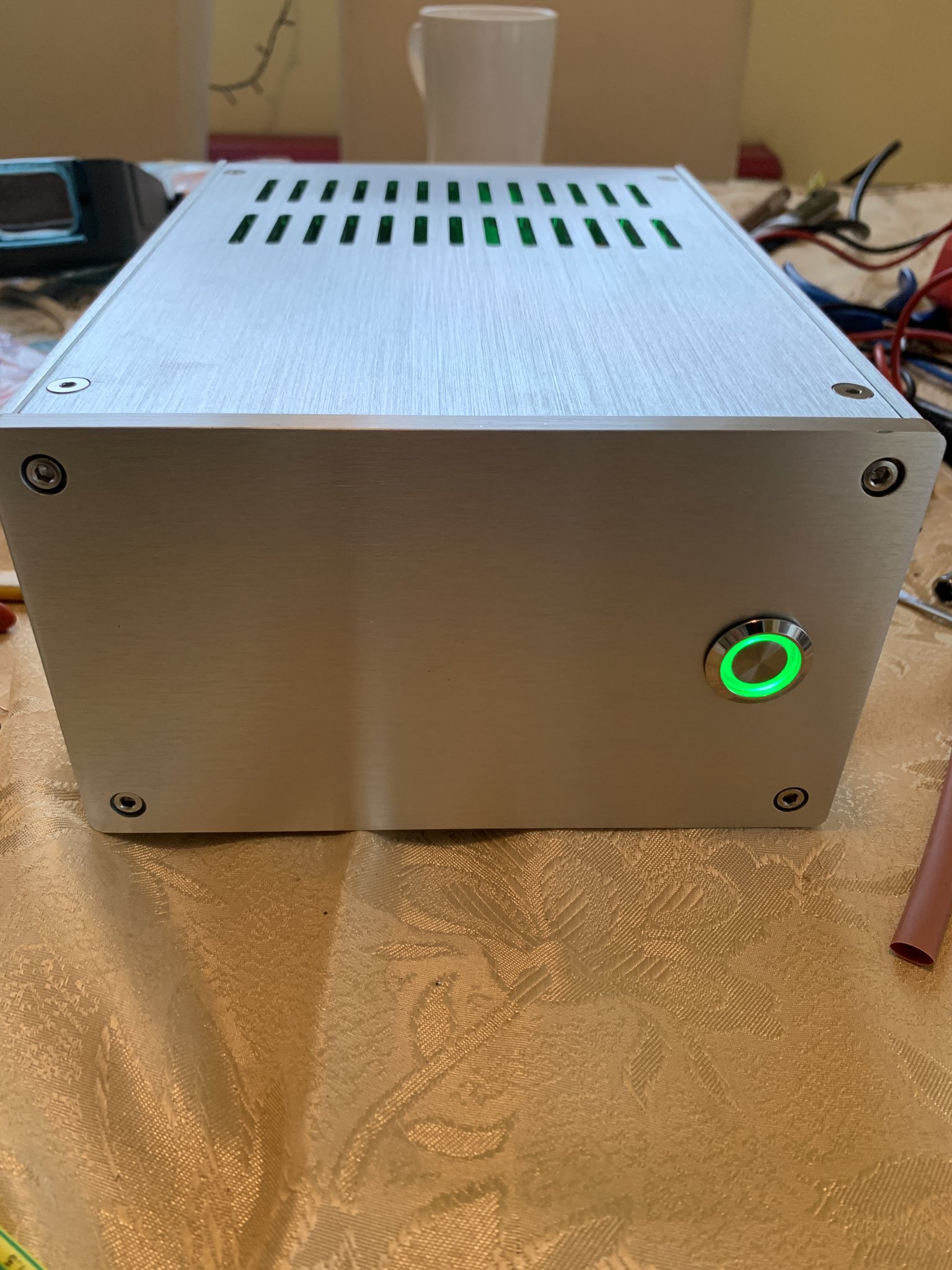

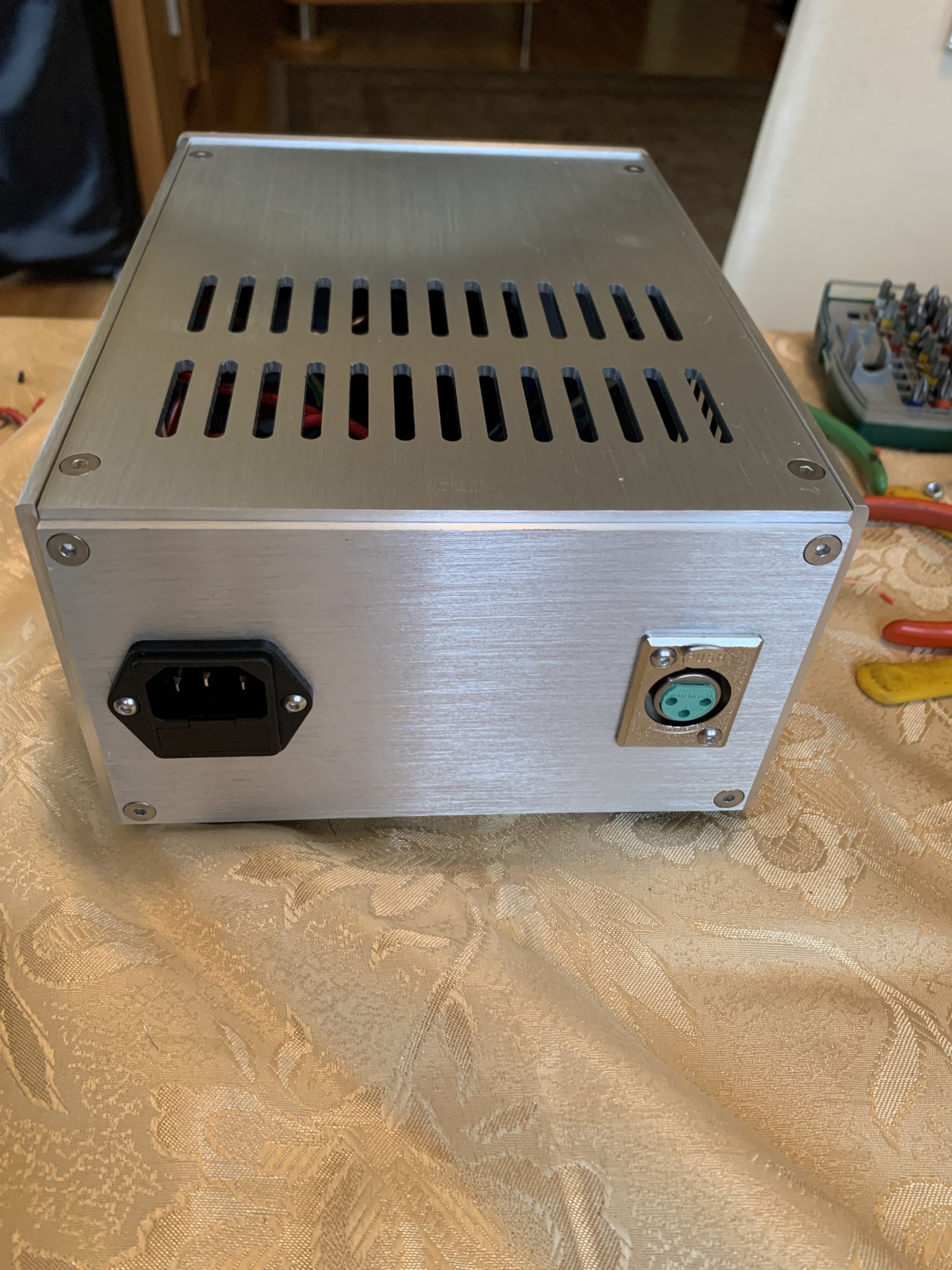

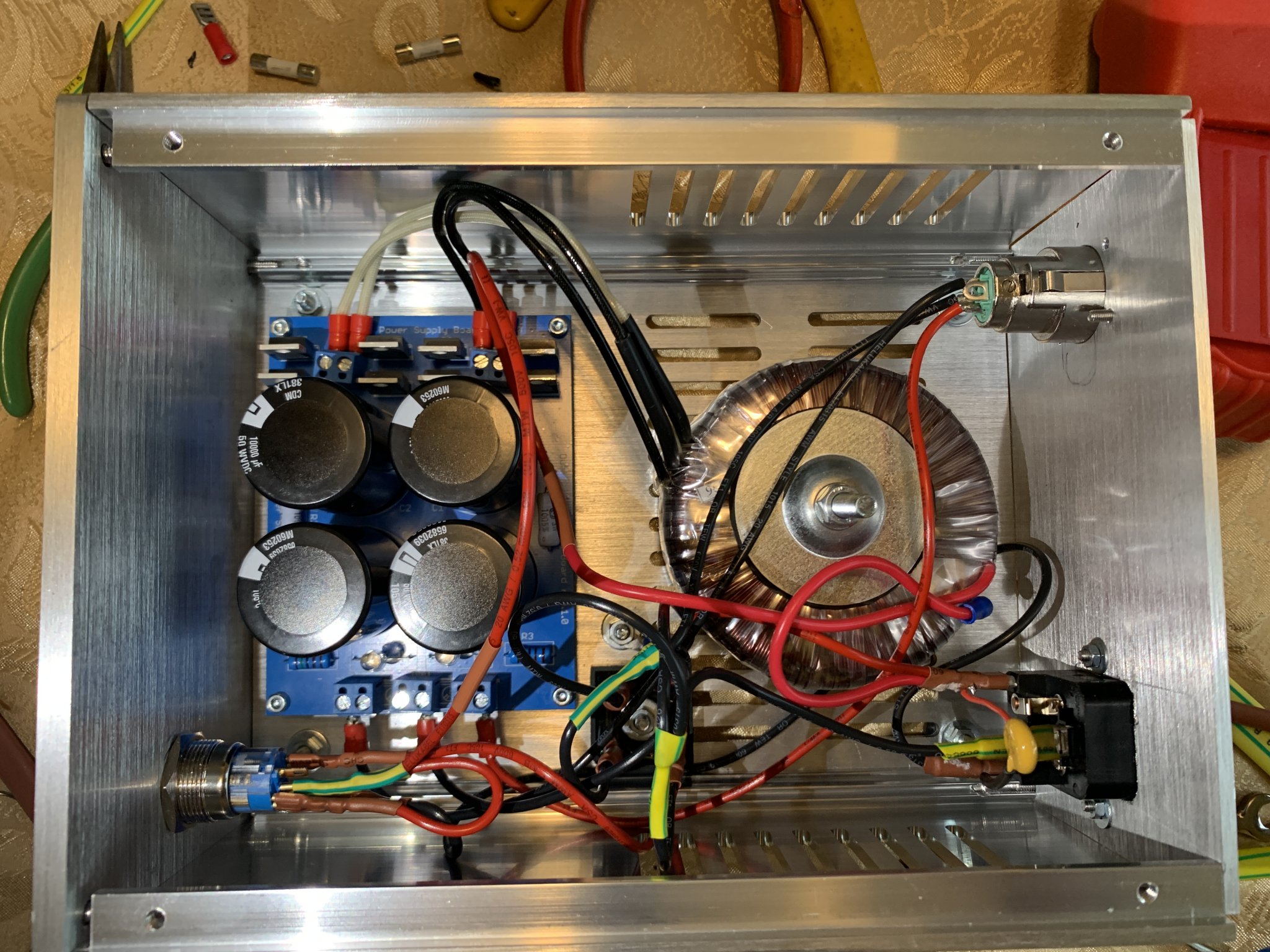

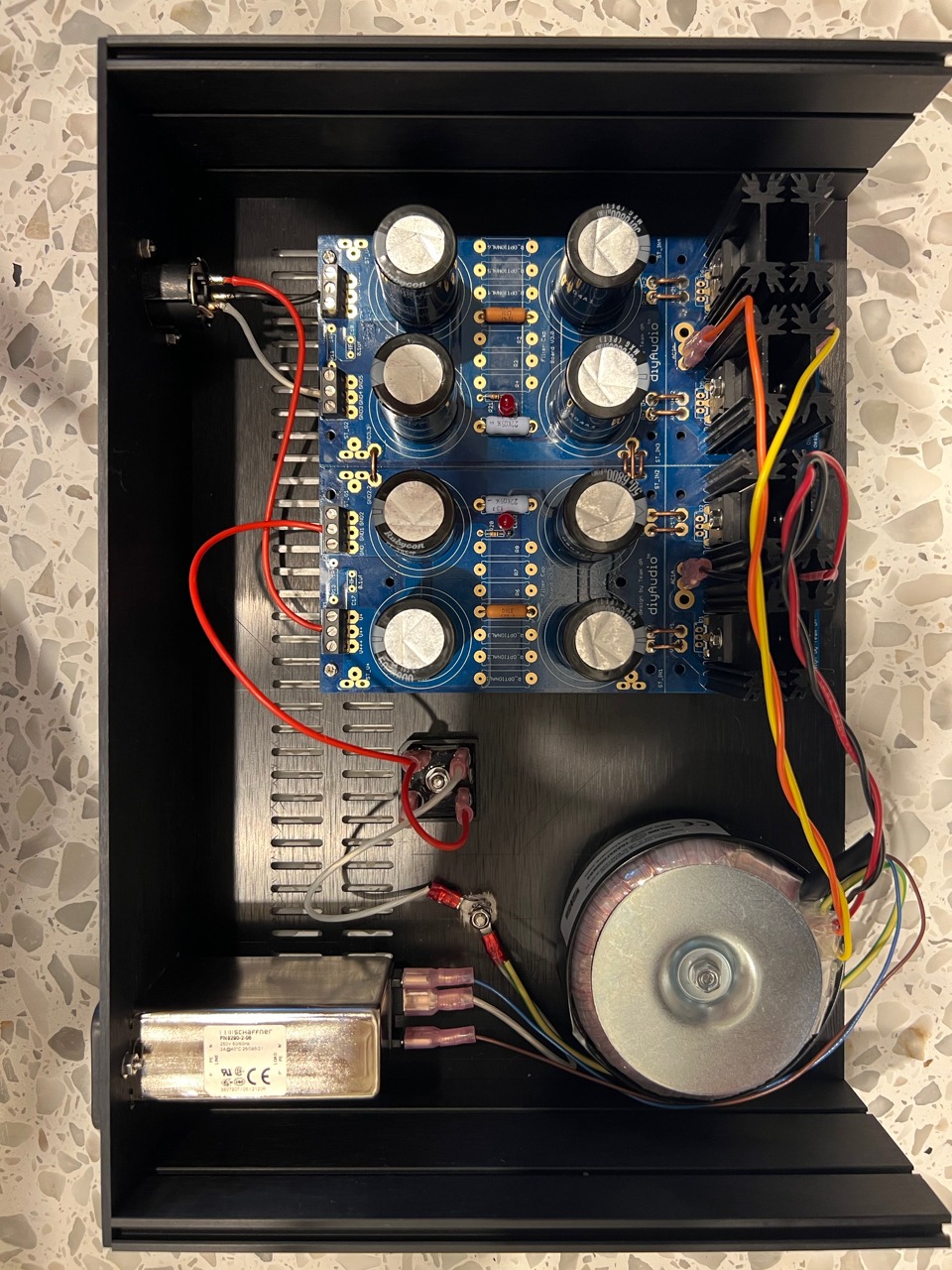

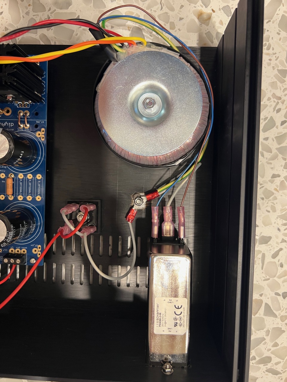

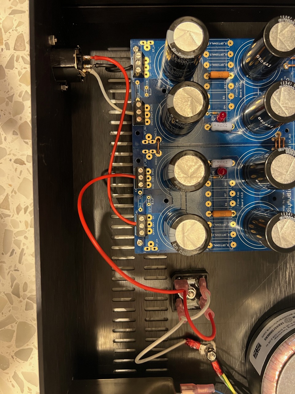

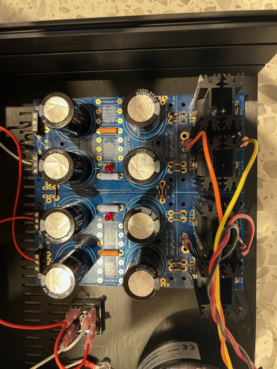

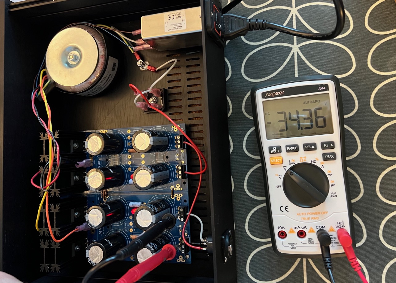

I've finally finished building the power supply with my son, taking longer than expected. A really neat project and great learning for people who have never built anything electronic before. I have not switched the power supply on yet, I would like to ask the community if anyone sees any major blunders with the wiring in the attached photos before I plug in and test the voltages?

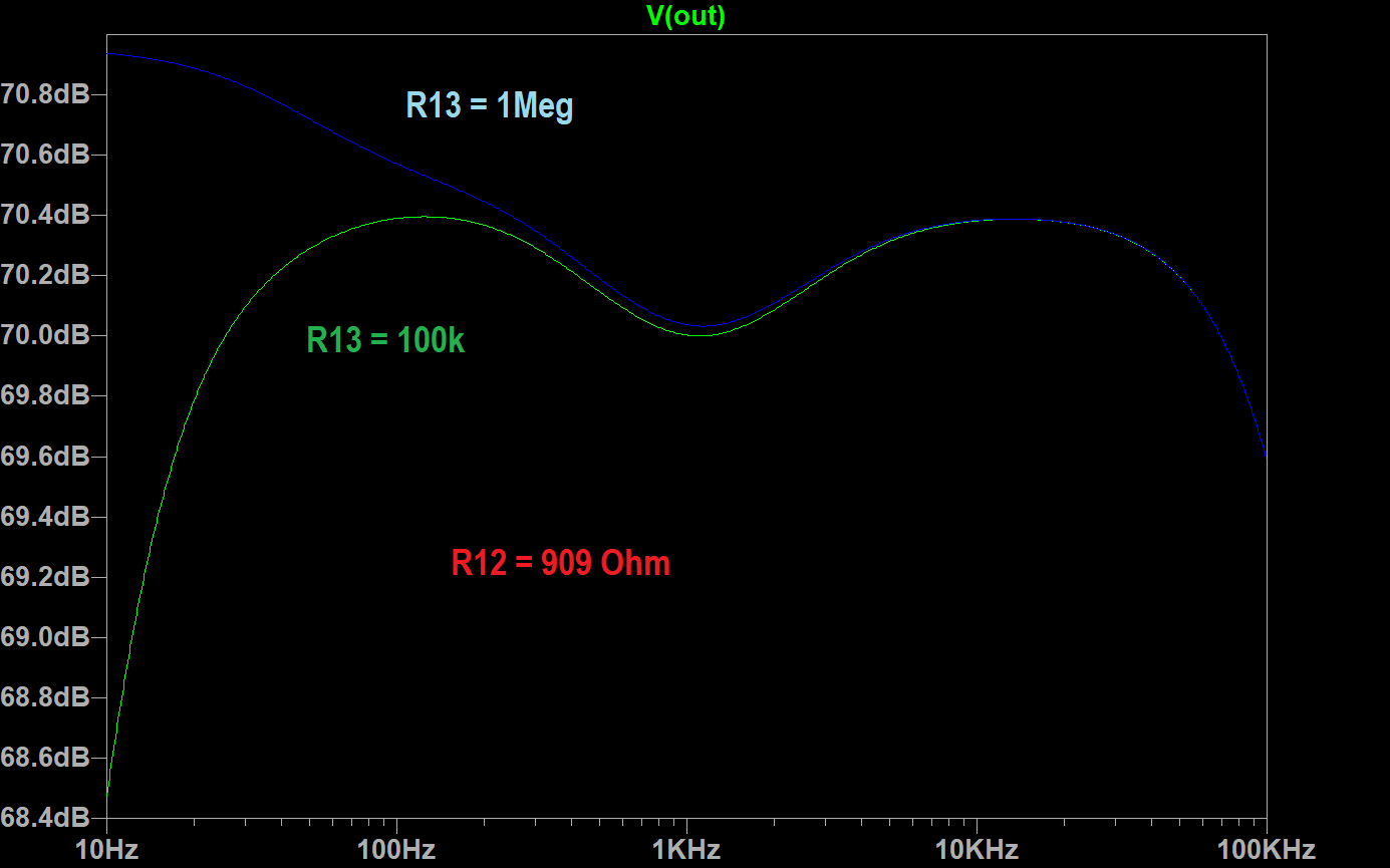

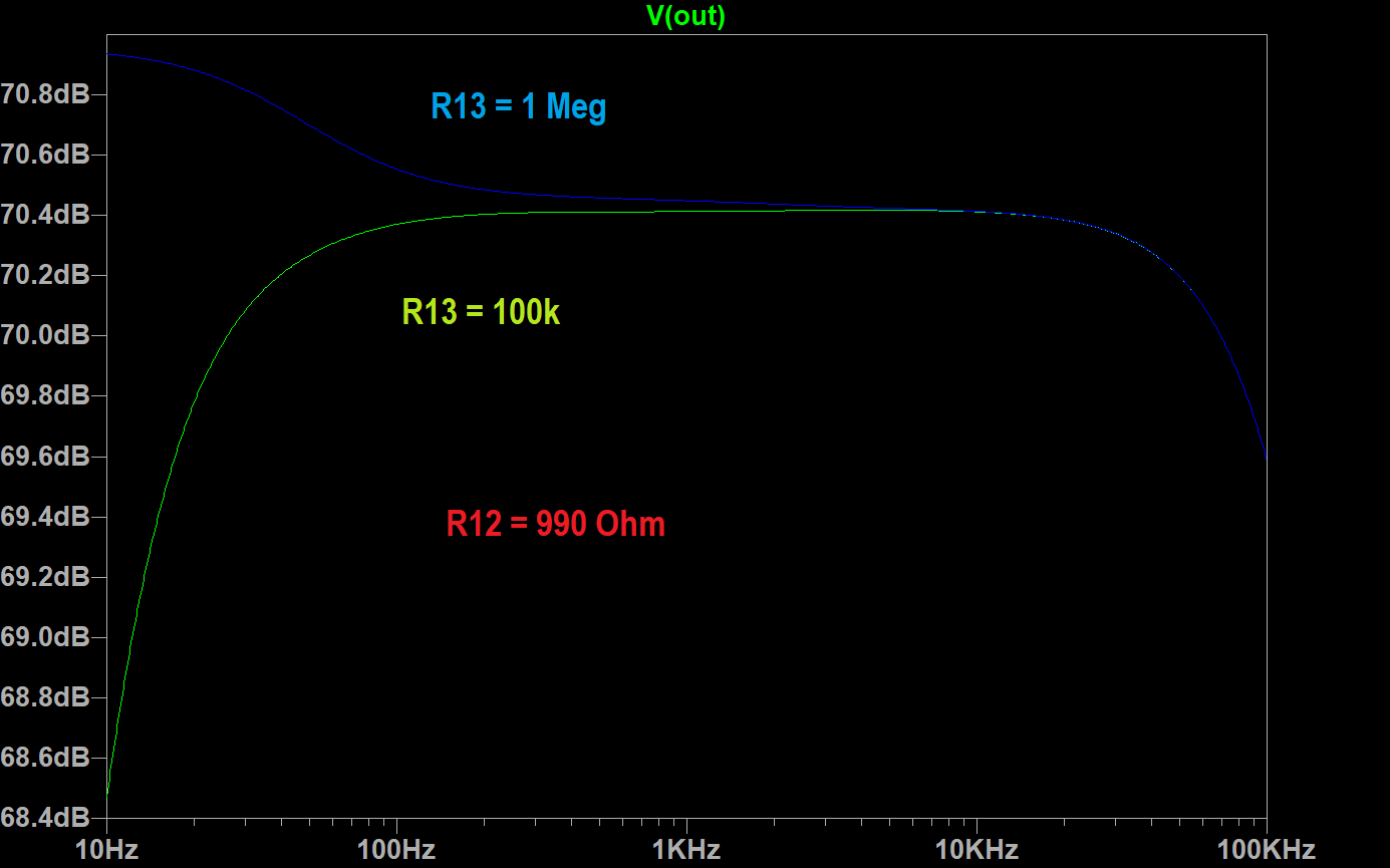

I don't think that's correct. The error is R12 which, on the schematic is 909 Ohms, a typo I believe. The correct value should be 990 Ohms which can be derived from two parallel resistors. See these simulations. Buried in this thread are my actual measurements, also done on an AP SYS2722Be aware all who have built or will build this phono preamp.
The RIAA response is quite a bit off owing to incorrect resistor value. Refer to the schematic where resistor R13 at 100K is actually in parallel with resistor R11 at 6K8.

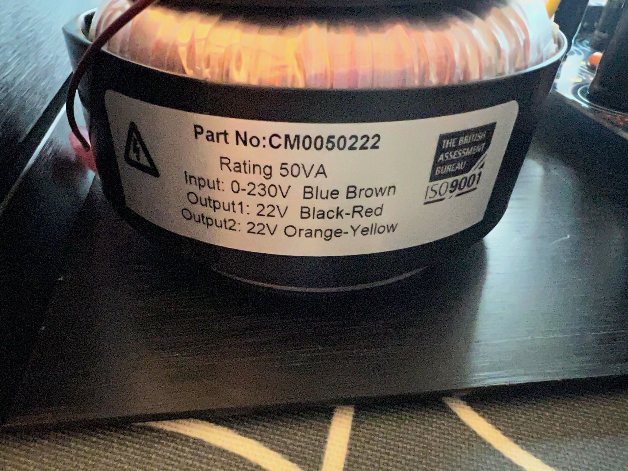

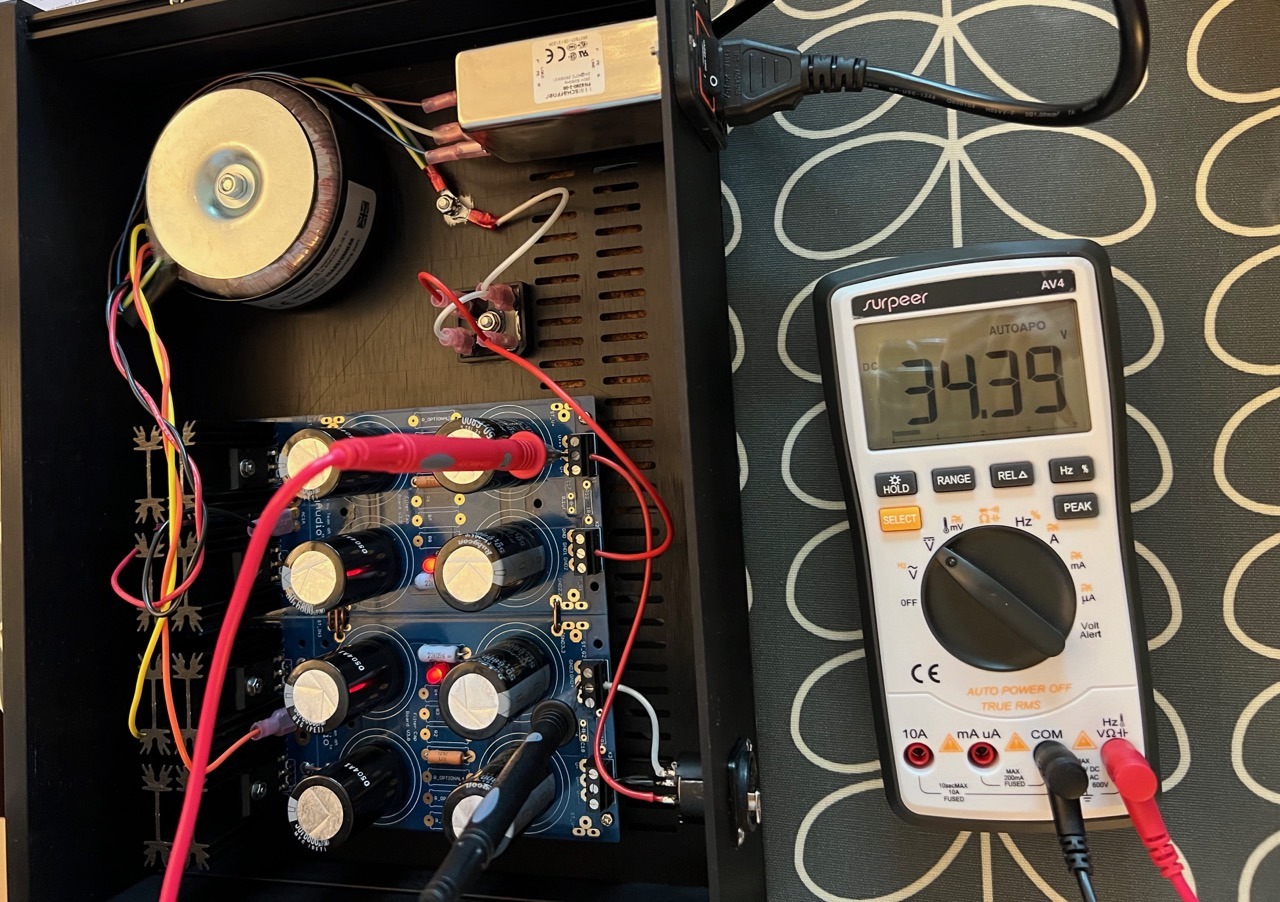

I have just finished my Pearl 2 power supply. I am getting 32.3V both sides, assume this is in the correct range?
Also, after I finished the build burned 2 x 0.5 A fuses and than 2 x 1A fuses. I admit that they all burned while playing to the power on/off button by clicking on -off - on to see the green light lit and the PS working
The 3rd 1A fuse holds if I do not play with the button... I do not know the phenomena behind, question is if I should go for a higher value fuse? I live in a 220V country.

You get a surge in current charging up the electrolytic capacitors at "turn-on". This can be mitigated with a Amphenol Thermometrics "Inrush Current Limiter" -- when cold the resistance is high, limiting the charge current. As the ICL heats the resistance decreases. I think that some have used the CL-60 which is readily available at DK.I have just finished my Pearl 2 power supply. I am getting 32.3V both sides, assume this is in the correct range?

Yes! Sorry...my mistake.Assume you mean +/- 32.3v..

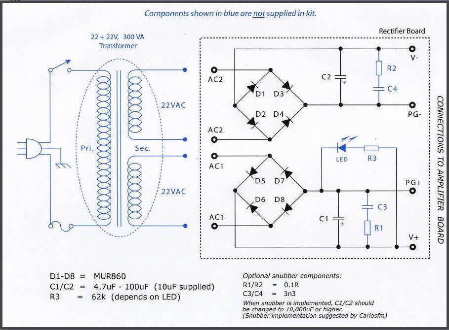

It's optional. See the schematics attachedFor 6L6, Peter Daniel, or anyone else who has used Peter's PSU board, is the LED required as part of the circuit, like it is on the Pearl 2 board, or is the LED space provided simply as an option for a power on/indicator light?
