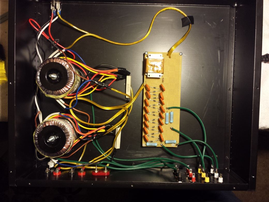

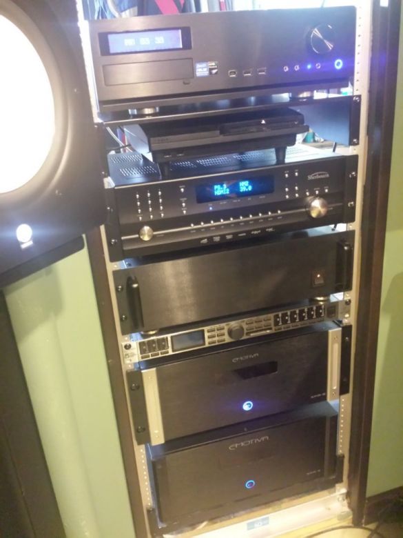

With the help of Jer, I was finally able to get my electronics package together, and I'm happy to say that it is a marked improvement over the old step-up/bias unit I had been using. Much louder and more robust, 5.1kv! (with a tap at 3.13, waste of time) Running it with my old flat panels... the XPA-5 is running the show with absolutely no problems, (the thing sounds great, and isn't even breaking a sweat..)

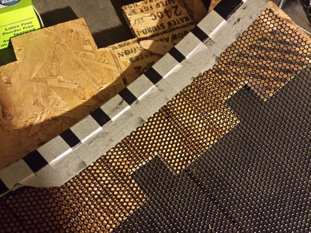

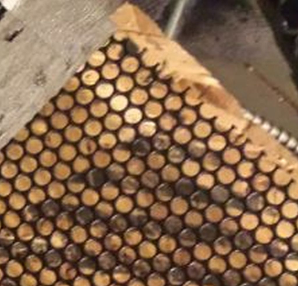

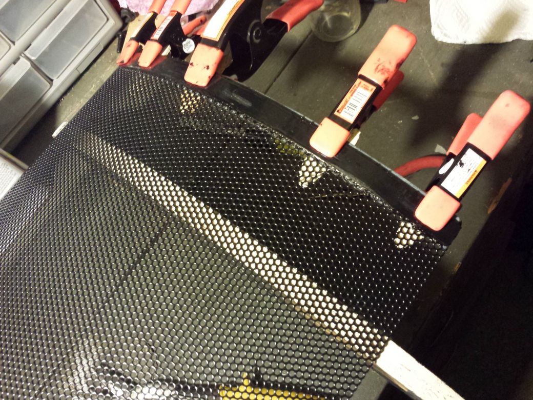

The other thing I've been working on is adhering the metal banding to the upper and lower ends of the perf-metal, and while doing so I ran into a bigger miscalculation than I had anticipated.
I sized up these metal bands and thought that using 45 mil tape on them, and using 63 mil for the sides of the panel would work, but between the powder coating and the adhesive (I used urethane) it was much thicker than I thought. I ended up having to order yet more VHB tape (this time 25 mils).
Thankfully that is going to work.
Just a note: If you have the money, save yourself the trouble and order your perf with the 3/4" margin intact (no perf).
Some pics, and sorry for the blurred ones. Note: Between the taping and the clamp method, the clamps work much better..

I hate to mention this so late in the game!!!
But, I hope those points don't cause any issues!!!
Otherwise, The Stator's look Very Nice !!!!!
jer
They will be wrapped double sided style, I'm not going to worry just yet.
