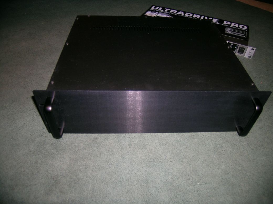

In the meantime, I took possession of an empty enclosure that I ordered from Par-Metal, it's a rack-mount (3R) unit that will house all of the associated electronics my new build will need, take a look at the attachment:

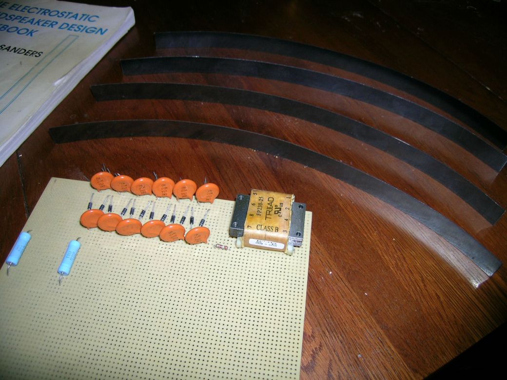

Well I've been getting everything together at a snail's pace, but that's OK, as my trafos won't be here till late Jan.

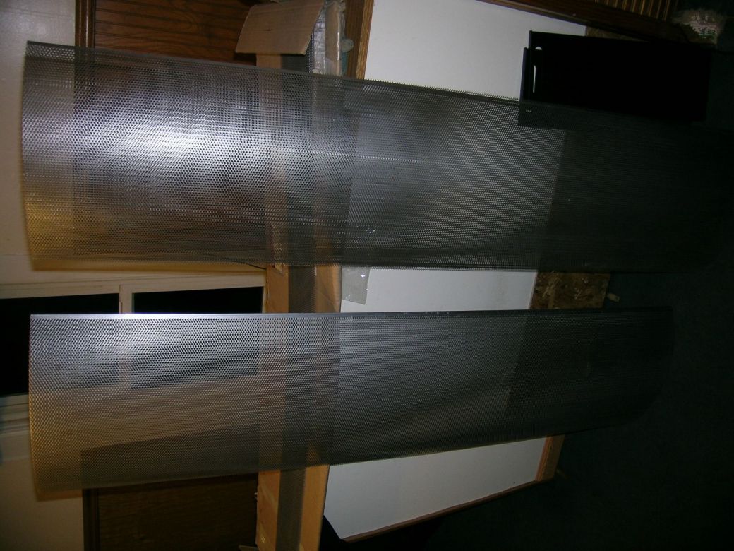

I eluded to the fact earlier, that I was going to order my perf metal with a remaining margin, that is not going to be the case as it would have cost me an additional $120 to do so...not gonna happen.
I decided to find a different way to facilitate a solid perimeter, and it came in the form of material known as "common banding" around these parts...
Yea, that's right, the stuff they use to bind together pallets of merchandise in order to ship it. This stuff is easily obtainable, and can be cut with common shears.
I originally wanted to epoxy it to the panel before powder coating, but unless you special order high-temp epoxy, common epoxies will only withstand around 350F, and powder coating ovens are usually 400F.
So I'm just going to have this banding powder coated at the same time as the panels, and epoxy later. On the plus side, this stuff is easy to bend by hand and should provide the necessary surface for the VHB tape to adhere to...
See pic:
You can also see in the foreground my soon-to-be bias supply, that will have taps at 3.8 (or so) kV, and another at 5.1kV.
I had my panels curved by a skilled metal worker, who made sure that they were exactly 30 degrees, cost me 56 bucks, but I think it was worth it> see pic:

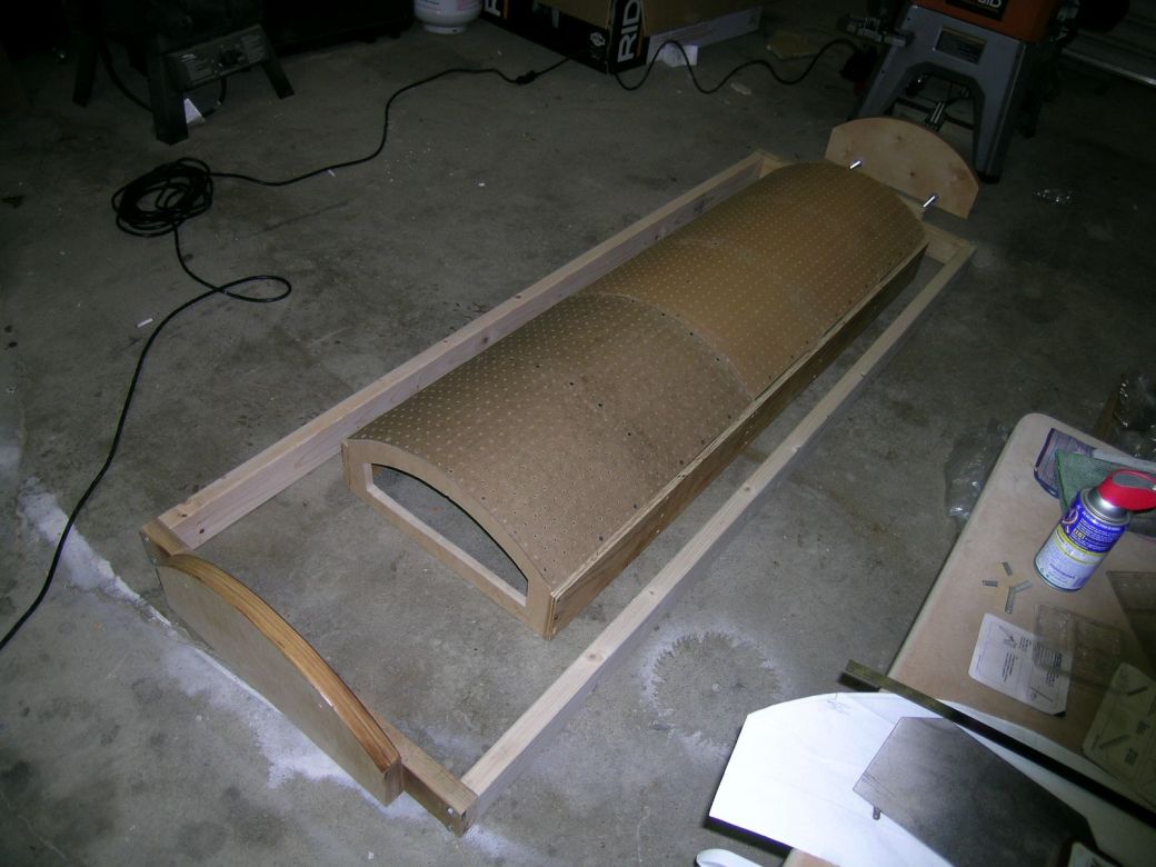

I'm almost done with my stretching jig too, the cookbook calls for one that is 50-70% bigger than the actual ESL. See pic:

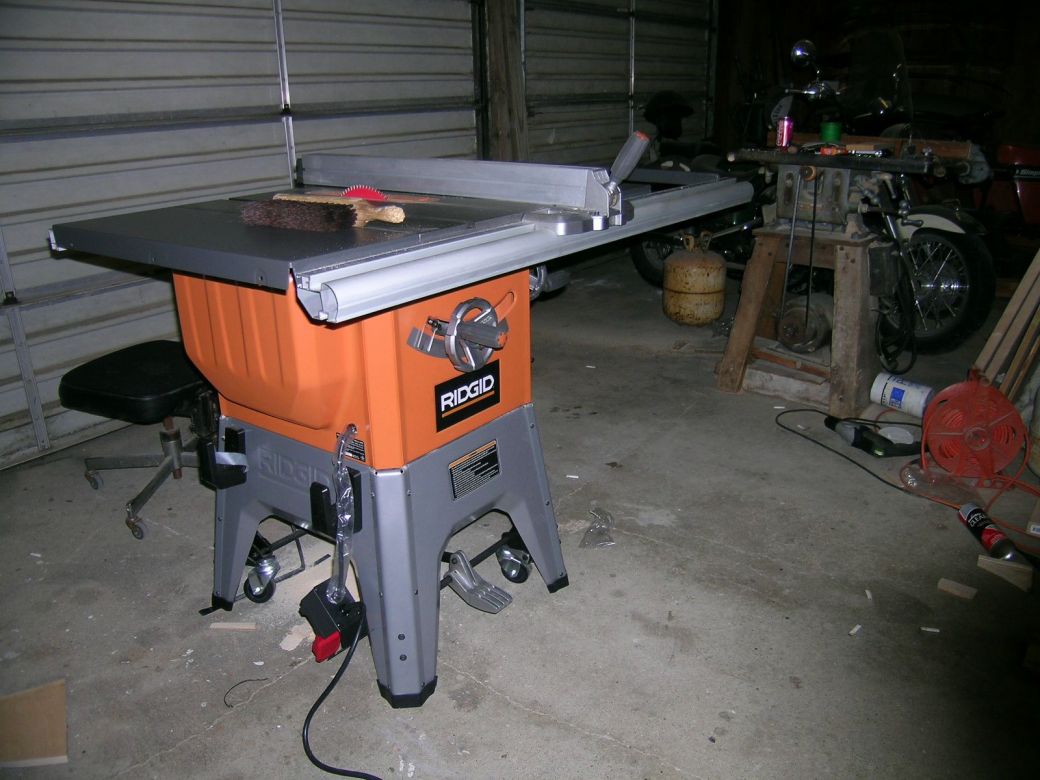

Finally, did any of you guys ever notice that when you decide to embark on a new mission, that you current equipment just won't do..haha
Pics of the new table saw, with the old POS in the background...haha, and also pics of the new XPA-5 I ordered for driving these new ESLs.
Cheers
-wreck
