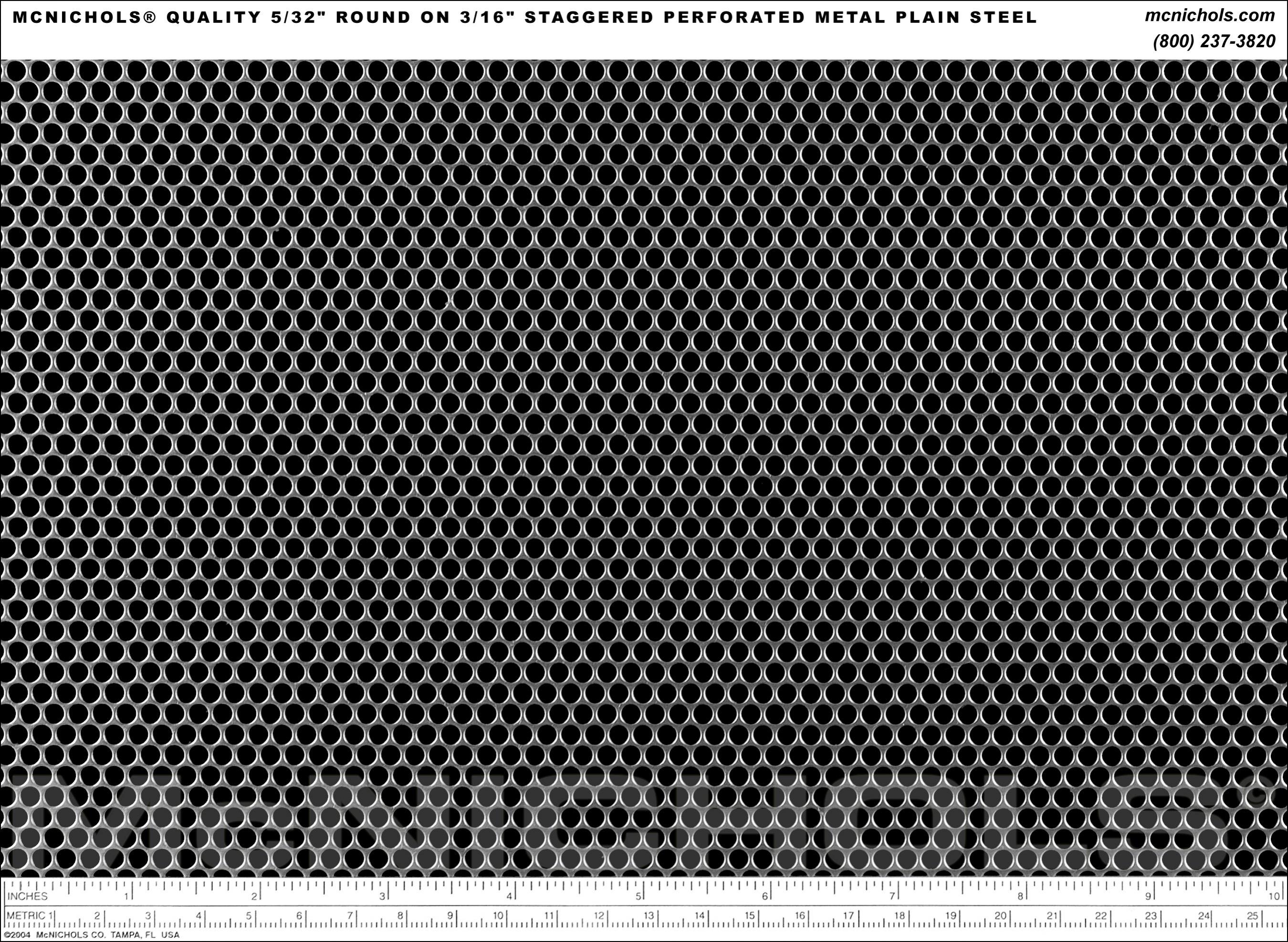

I was digging around in the McNichols catalog a few days ago and found some 63% open perf sheets (18 gauge) that were $155 for a sheet 36" by 120". I asked for a quote to ship it to me cut in 4, and they gave me a price of $230...WTF? That's not including the $20 shipping and handling... Really? You guys want that much to set it up? Yikes!
I looked up gauges in inches on Wiki and it says that 18 gauge is .05 inches, then I looked up 20 gauge and that stuff is .0375 inches, but at a cheaper price ($112), so I imagine that 20 gauge would be about $190 or so, much better.
That is if 20 gauge is going to be OK for ESL construction.
If I plan on using a fair amount of paint/powder/insulation, do you guys think 20 gauge would be OK?
It looks a lot like MLs X-stat perf, only not quite as open, but real close.
I attaches a couple of pics for visual reference below:

Forgot to mention that the McNichols perf I posted last night has 5/32" holes on 3/16" centers, are those considered too big? Enough to negatively affect field density? If anyone knows or has an opinion, please respond, thanks.

The 5/32" to 3/16" pattern is a good choice. If the perimeter is perforated also, You have to treat the rims, such that no sharp edges remain, which are prone to flashovers.

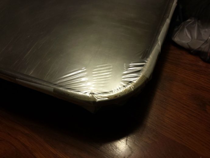

Tried to test heat-shrink-ability today and the hair dryer I tried to use pushes too much air, doesn't get hot enough.
So I lit up a cig, and hovered it over the surface about 1/4".. that worked, as you can see the 2 small strips within the wrinkle smoothed out.
See attached pics:
This is obviously impractical, and I'll try again tomorrow with a 2400W heat gun at work.
For the record, this is standard "C" Mylar, as opposed to the "heat-shrinkable" Mylar. Note about that stuff: they claim 50% shrinkage while dipping into boiling water, I think that would send the diaphragm right into the back stator on a curved ESL, not good, and I think this standard stuff is gonna be just fine, but we'll see...
See attached pics:
