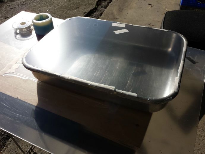

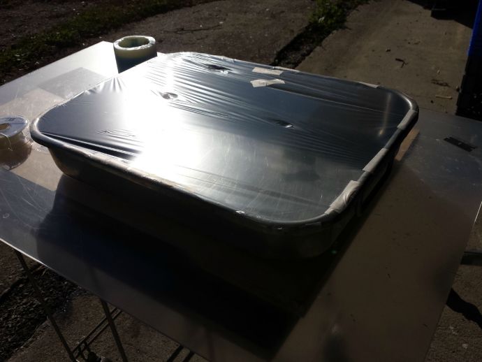

Hey! Thanks for the info once again, I did another test with a heat gun today.
Firstly, I was incorrect with the wattage I thought it was, instead of 2400W, it was actually 750W/1500W. The 1500W setting burned through a (non-pictured) test piece straight away, but the 750W setting worked a charm! see attached pics:

Hi Calvin,
I understand that this method of heat-shrinking is not meant for further tensioning a curved panel, but just for removing minor ripples, as is noted in this builder's blog: https://sites.google.com/site/eslarray/home/project-history
Why did you state what you did about heat-shrinking "C" mylar? Do you know of an unsuccessful attempt, or one that turned out in disaster?
Like I said, I would be using only mechanical tensioning on my curved panel, and working towards flawless results *unless* there was some mild ripple of
some sort, then... and only then, would I try heat to remove them. Any further thought? Or experience?

Heat treatment of one of the standard films in a curved panel will ineviteably lead to the unwanted hour glass shape, with the membrane closer to the back stator than the front. This happened the guy from the link. Also his panels are less curved than intended.
If You want to try heat treatment, apply heat only locally to small areas.
Still this introduces inhomogenities in tension and possibly in the membrane's shape. But it may be less bad than strong wrinkles.
The long vertical rims and the four edges are most prone to wrinkling.
For the wrinkling edges there are two counter measurements.
First is to use a streching jig/film length quite a bit longer than obviously required. The second is to place the first spacer close to the rim, so that the first top and bottom segments are quite slim with a clearly lower d/s ratio.
Wrinkes along the vertical rim are more difficult to treat as they will likely pull the membrane towards the back stator.
As a mechanically stretched membrane will settle over the coming months, there's a great chance that the wrinkles will occur again.
So it is best to stretch the membrane wrinkle free in firs place.
Rather replace the wrinkled stuff at once, than correcting wrinkles
In R.Ss Cookbook they present a method of heat treating the membrane whilst glueing it to the stator. But I doubt that one would be successful first time. Also it looks as if it were a messy procedure and not a very consistant too.
For flat panels matters change and heat treatment is wholly recommended.

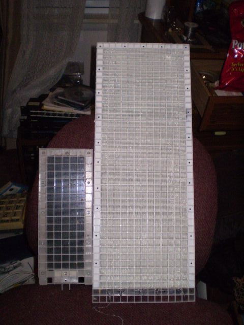

The reason I mention this is that when I built my First set of working panels (not the experimental ones I did), I built two different sizes.
One was roughly 4 times larger than the other.
The reason for this was to test, The more surface area the more efficiency theory.
It took only one 2' X 4' sheet of plastic grating material ($10) to build both sets.
I never got as far as being able to test with measurements as life's crisis interfered with a few things at that time and slowed me down a bit (all of 2006 and 2007).
Also, I didn't have the proper measuring equipment back then that I have now.
But, I had a good ear and a SPL meter, scope and signal generator.
So, That was better than nothing at all!!
One of the main things that I had difficulty with at the time was having suitable transformers to drive them with.
At the time I was using some small 6V6 pp OPT's and by about 2004 or so, they finally gave out and shorted.
So, My whole project was put on hold and I started searching for transformer core material to build a pair of suitable transformers.
When I got back on DIYAudio in 2008 to see what advances in ESL technology may have progressed, It was finding Jazzman's ESL's that really got me going again, even though my passion was still stronger then ever.
That is when I started using the Power Toroidal Transformers in reverse Technique in 2010, as they weren't readily available when I had started just a few years earlier.
Anyhow, During the A&B testing of my two sized panels I had found the typical things like the wider panel had slightly more bass as expected and such.
And a slightly more output maybe, as I had no woofer system at the time and was running them full range as the extra bass made them seem louder.
But, The one thing that I did notice was that with the larger panels I had to hold my head in a vise more so in order to enjoy the stereo image, or, without some kind of phase distraction from only very slightly moving my head.
With the little panels it was not so bad and was much much better as I was able to move about freely (slightly) without the stereo image being altered at all (or very much)!!!
The deficiency in the bass part was one thing and I knew that would be solved by adding a woofer.
But everything above about 300Hz sounded exactly the same between the two as they have no coloration whatsoever!!
Except, For the stereo imaging issue and that is why I favored the little panels more.
Then, I built my third set of ESL's duplicating the little ones using a better stator coating that only consisted of two layers of Powder Coating material that a local shop help me with.
This allowed me to raise the bias voltage quite a bit.
I had used many multiplier stages fed from the 345v volt winding that was found on the stereo 6V6pp chassis that I was using.
I used an alligator clip to select what bias voltage range I wanted to use.
I had something like 16 stages or so to chose from.
Once I had got them running at a very high bias voltage I could not believe what I was hearing out of such a small panel (sorry to repeat myself here).
At a very realistic volume of up to about 90db at 12 feet away, and there was bass too!!
All it needed was a sub to help it out a bit.

Since then, I started to do some heavy researching as to what I had discovered, and it all boiled down to the actual width of the diaphragm and not just the width of the panel itself !!!
The widths of my original panels were chosen as a fluke, due to wanting to utilize as much of the Plastic grate material I could without wasting any of it!!
There was no thought of the Horizontal Dispersion issue until after I had built them and started listening to them.
It took a lot of digging and reading to finally understand this and the answer was so simple that I could not believe it!!!
