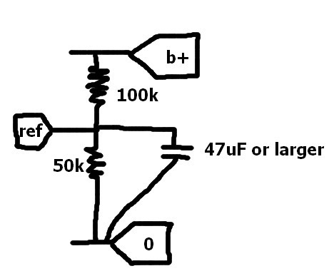

Ok So i just Solder the CT of the Filament tranny to the 1/4 B+ in the center of the Aikido PCB? I did a search and UHHHH. Tons of Info..Some added caps and resistor for a virtual CT... Here is the Bottom of the Filament Tranny I used.

Tubes 6CG7/6DJ8 and other tubes with shield=Either to ground directly or to ground via capacitor. Both methods are fine.But on Aikido user guide : "If the triode’s pin 9 attaches to an internal shield, as it does with the 6CG7 and 6DJ8, then capacitors, C11 and C12 can be replaced with a jumper, which will ground the shield. However, using the capacitors will also ground the shield (in AC terms) and allow using triodes whose pin-9 attaches to the center tap of its heater, such as the 12AU7". So tube with shield : pin 9 direct to ground. For 12xx7, to ground via caps.
Tubes with center tap of heater such as 12AU7=Capacitor only or no connection to anything.
See attached drawing.
So Ref would be the CT? ... B+ and Ground are used...Two resistors in series and ct connected in between?
Yes. Connect Ref to CT of heater transformer.So Ref would be the CT?
Exactly.Two resistors in series and ct connected in between?
I hope that is an electrolytic Cap? I have a 47uf 450v in my bin..
