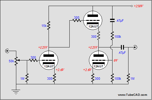

Ran across an article on using a 6U10 compactron 3 triode tube for an Aikido line stage. Has anyone tried this?
Schematic of Aikido line stage that you could use the 6U10 on.
There is a high gain section #2 in the 6U10 which could be used as the input tube once plate resistor and cathode resistor values were changed. Sections 1 and three would be used in place of the 12AU7.
OK, I remember that schematic. Are there other triple triodes out there. preferably a triple 6SN7? Any quadruple triodes?
Hmmm, a 6C10 is a triple 12AX7...it would make for an interesting two tube Jadis JP200 preamp...
