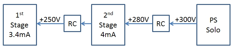

It appears to be similar to the all in one where there are separate B+ runs per channel. So you need to figure out how many mA per channel per stage you will pull. Then select a resistor to drop the appropriate voltage at the operating point.
Say your first stage runs 10mA for example and you need to drop 20V. Your R then becomes 2000ohm.

1st stage Iq= 3.4mA (250V)
2nd stage Iq= 4mA (280V)
There is a resistor table in the manual that has Resistor Values, Voltage Drop Against Current and Current in mA.
Since I have +300V going into the board, then I need to drop 20V and then another 30V for 2nd stage?
The table shows for 4mA(2nd stage):
3.9K 15.6V drop
6.8K 27.2V drop
So I need something between 3.9K-6.8K to drop 20V?
For 1st stage, Iq is 3.4mA at 250V. I need to drop 30V for this?
The table shows for 3mA(1nd stage):
3.9K 11.7V drop
6.8K 20.4V drop
10K 30.0V drop

I'm not sure thought for initial RC stage, don't you need to take into
account the current load of the 2nd stage as well? This is where I'm unclear.

So assuming 12AX7's in both input and output positions and 300VB+
1. The output stage is drawing 5mA and is the first to encounter the B+ so following the chart for R18 @ 3Kohm you will drop 15V.
2. The input stage is drawing 1mA and lets assume is now 285V so following the chart for R10 @ 10Kohmn you will drop 10V so now the plate will see 275V.
If you run the tubes hotter then the voltage drops will be greater but what I have outlined above here seems reasonable. I would start there and take some measurements. From there you can fine tune by either increasing the R in the RC or reducing the cathode resistors to increase the current.
The F3 capacitors from what I understand affect the ripple/noise in the power supply at each stage in the RC filters. 150uF would be the standard here...this part starts to get a little over my head...
