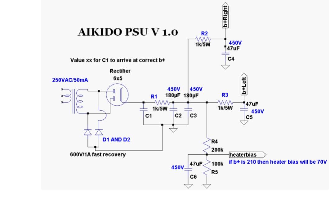

can someone help me out with the RC values for the Aikido Tetra Sans?
I'm using the PS-2 Solo set for 300V. For the Tetra Sans I'm using
both 12ax7 for both stages.
1st stage = +B 280V
2nd stage = +B 250V
There is an RC for each stage. So I just need to drop the 300V down
to 280V and then down to 250V There is a table in the manual but
it's confusing to me. It has current load values and resistor to use.
Do I add current loads of both stages to look up for the 1st stage RC values?
