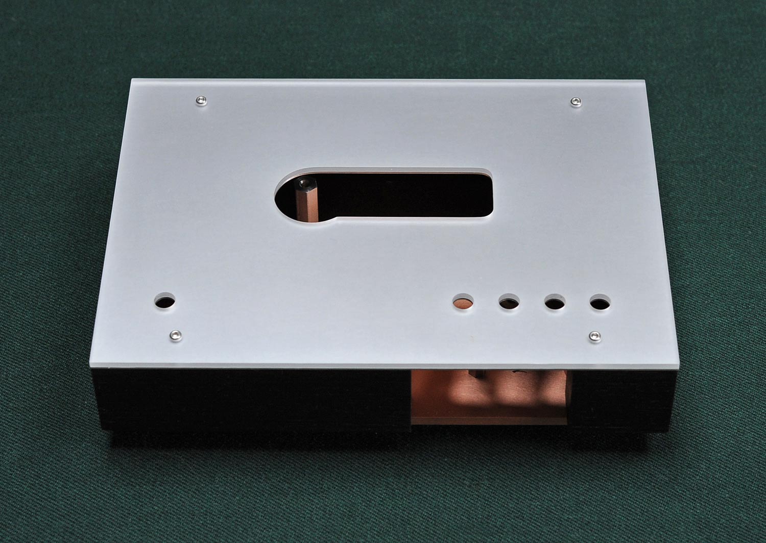

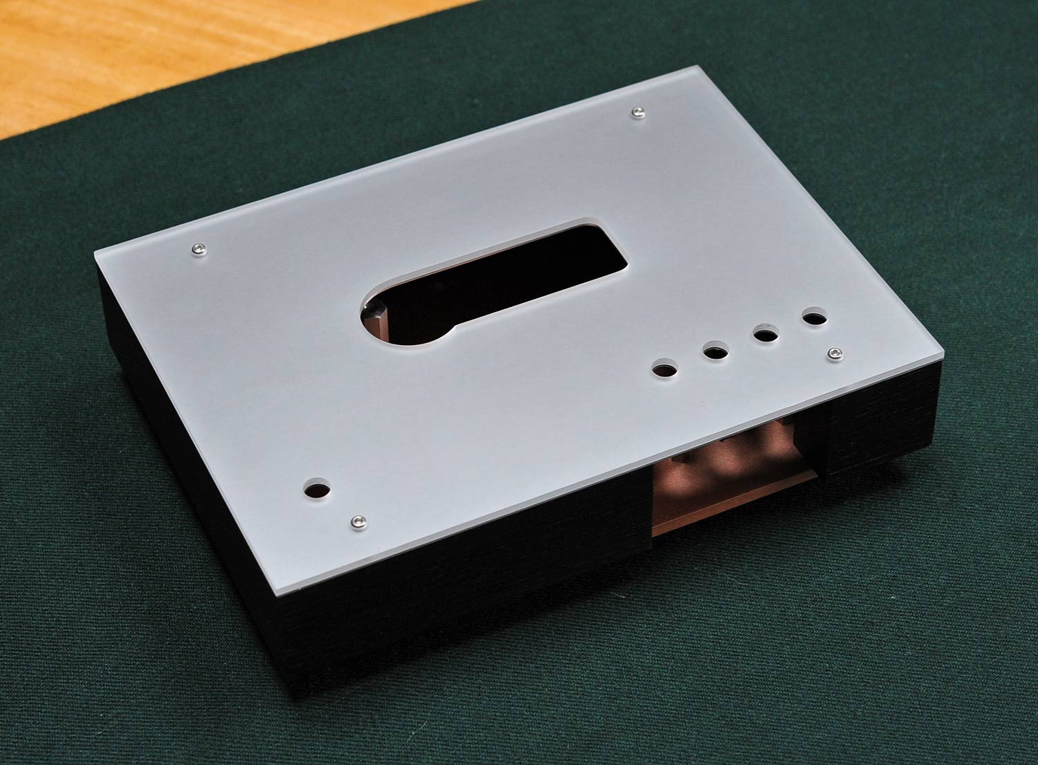

I recently used a method were thin, brushed aluminum panel is covered with 1/8" thick frosted acrylic panel. The results are quite pleasing and it does not require anodizing. I do brushing now with orbital sander (180 grit followed by scotch brite smoothing)

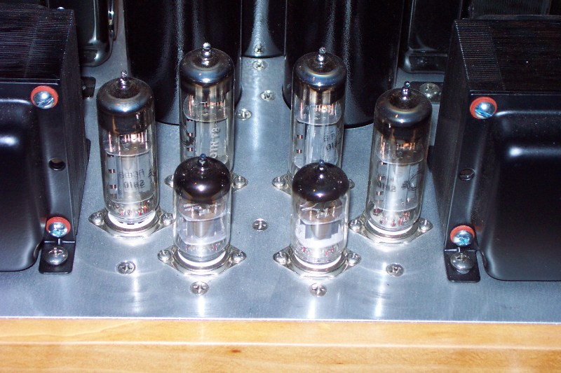

The other option I use is Krylon semi-gloss clear acrylic spray paint on brushed aluminum. If you sand with a jitter-bug sander (like the old Porter-Cable palm sander), clean with acetone, and spray immediately, it's really nice, and it won't chip easily. I'll post some pics if anyone is interested.
I'm interested 🙂
