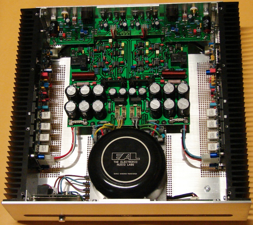

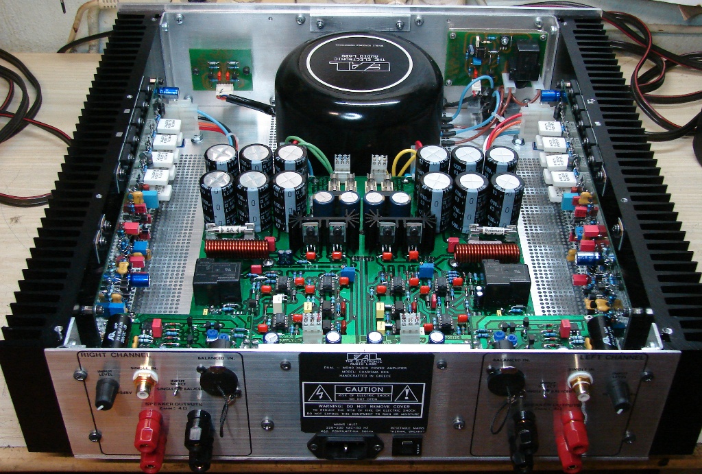

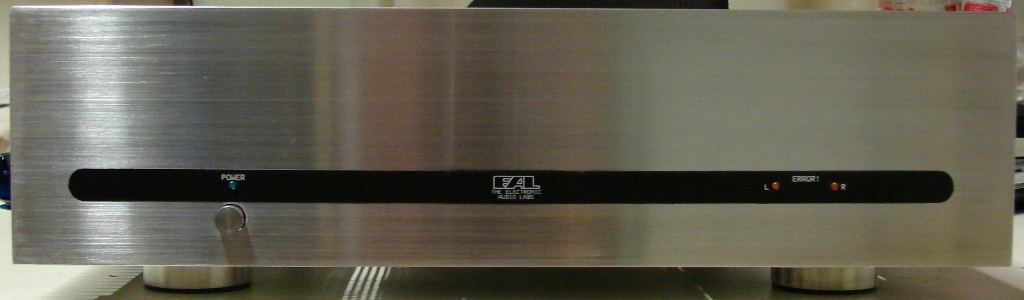

The amplifier completed
In the attached pictures, it is the first amplifier that i made. This moment i construct just the second unit, which will be exactly of the same appearance. I sold the first for 1200 euro, because some deficiencies in the external finish of ALU plates which are not anodized as well. You can see that, although the parts that i use inside are of Hi-End class, i feel ashamed to sell it for more money, because the above. 🙁
I build the current unit with more care as for its external finish, and i hope to sell it for 1500 euro.

Hi Fotios,
That is a very nice looking amp. Thank you for contributing your knowledge to this thread.
I see that on the back you have used the angle similar to what I was proposing. Your's appears to have been bent in a brake instead of extruded. That works just as well, but many here may not have access to a brake. What I present here are suggestions, not rules. You have shown another way to do the same thing that works just as well.
It appears you have attached the front panel the same way I was going to suggest. Did you drill part of the way through the panel and tap the holes? If someone plans to do this there are several guidelines that should be followed. You should use a flat point drill bit. They aren't really flat, just flatter than the other types. A 118 degree point is the flattest you are likely to find. You should use a slow spiral for soft materials such as Al or Cu, however this mostly applies to deeper holes. You should use some type of drill stop to ensure you do not drill through your panel. Do a test hole on a scrap piece first. Use a bottoming type tap to get as much thread depth as possible. As a very general rule, the threaded hole depth should be equal to or greater than the major diameter of the screw you are using. The screw length must be sized to use as much of the threaded hole as possible while still holding the panels firmly together.

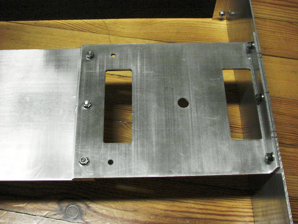

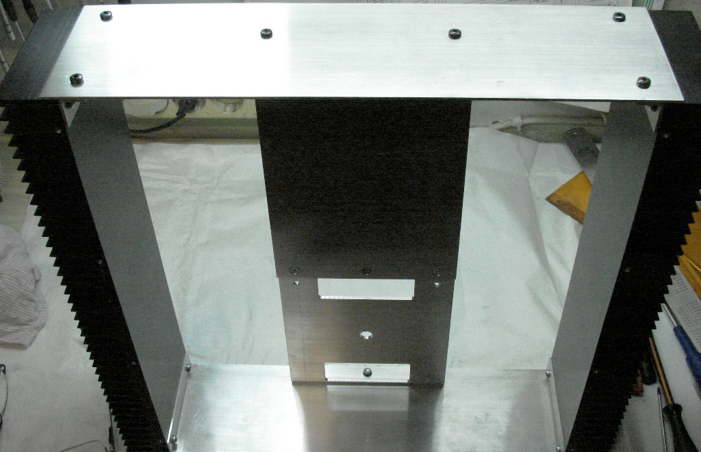

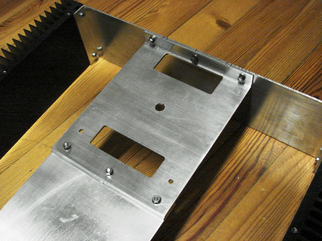

Hi to all
1) Size: I prefer 17" width like John, because is standard for most Hi-Fi devices. For the height, i prefer 100mm because i like slim line. Moreover the heatsinks that i use, are Fischer SK93-SA100 (400mm length X 100mm height). So, the inner depth of case it is 400mm.
2) Plates: The front support plate and the back plate are from 2mm ALU sheet. The decorative front panel it is from 4mm ALU sheet. The top and bottom covers are from 3mm ALU sheet. I use thick covers to support heatsinks in thermal dissipation. I have ascertained that a heatsink removed from the case can touch a temp of 49-50 deg C in idle state, instead when it is mounted on the covers the temp drops down to 35-37 deg C. It should be noted that this amplifier in pics operates with +/-60V supply rails and that the power x-former it is 500VA. You can estimate approximately the power dissipation.
3) I find the ready offered extruded angled profiles some impractical; you can't find each time the size that you want. For this reason i prefer to make by alone the angled pieces. I have a custom made bending press, but to bend ALU sheet it is not so complicated. ALU is soft. You can use a usual bench top vice. First, you cut the ALU piece in the dimensions you want. With a sharp tool you engrave the bending line enough times, say 10-15. Grip the piece in the vice at the engraved line, and with a wood piece and a hammer bit the piece until is bended exactly in a right angle. That is all.
4) For the front plate: I open holes with a 3,5mm slot drill (this which is used in milling machines and its cutting surface it is flat) and i don't open threads with tapper. I use the bolt itself (M4) to open the thread. For a 4mm thick front plate, i use a press drill with stopper to obtain a depth of the hole about 2,5mm. The bolt when screwed, push out the surplus of ALU creating thus a "volcano" around the thread. This volcano adds 1mm in the thread, thus total 3,5mm depth. In the support plate, i open 6mm holes so as the volcano can contained and i add in each bolt (M4 X 6mm) two washers and screw down. If the thread destroyed and the screw does not tight securely (a rare thing) i add epoxy glue on the screw.
I know that these things are difficult to explained with words. Some pictures are better. I will try to take and post some.
Fotios
