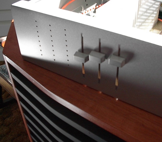

Another finishing option on raw aluminum is the frosted look:
and closer:
I did this with a random orbit sander loaded with a 100 grit disk. Holding the sander firmly to the surface prevents it from spinning (and creating swirls).
Once it is as even as you would like, clean with acetone or lacquer thinner and spray on 2-3 coats of lacquer.
and closer:
and closer:

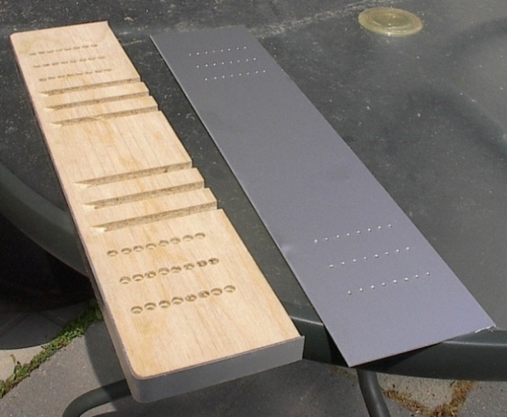

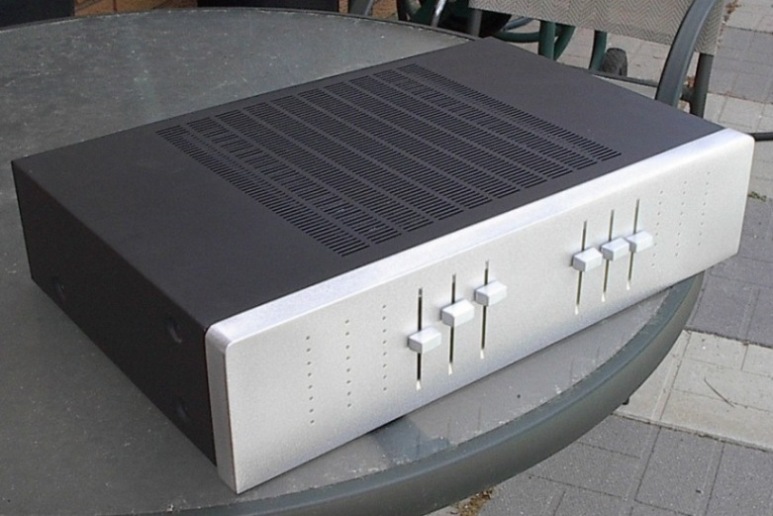

How did you make those slider slots? was it a circular saw from both sides?
It was cut from the front - clamped in place to the top of the tablesaw (careful layout!) and the blade slowly raised to make the cut.
A confession is in order though: that is not solid 3/4" aluminum...
Faked to look that way.
Slider knobs are solid aluminum though, I made those from what was left after the heatsinks were cut. Waste not 😉
