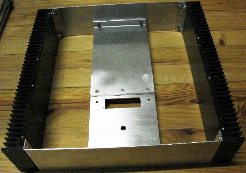

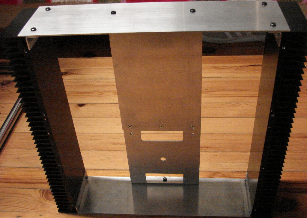

I recently used a method were thin, brushed aluminum panel is covered with 1/8" thick frosted acrylic panel. The results are quite pleasing and it does not require anodizing. I do brushing now with orbital sander (180 grit followed by scotch brite smoothing)
