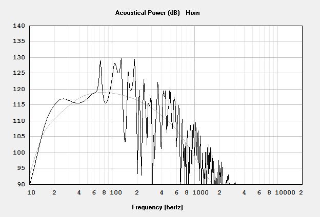

I have 4 of the Infinity 1260w drivers, and I am wondering (as others have) if these could work well in this design. I have tried downloading Hornresp, but my computerskills are horrible and I cant even get it running... Even if I did I am pretty shure I would not understand much. I am more a builder than designer. 😉 If anyone would be so kind as to help an old fart with this, it would be much appreciated.
having 4 of the same drivers, and wanting to do something interesting with them i entertained the idea of the krakken some time ago.
attached is a simulation of a krakken enclosure loaded with the 1262s and in light gray is a simple ported enclosure @ 2 cu ft per driver tuned to 20hz, so 112L. both at 2pi and both set so excursion bumps 13mm. (30V for the TH, 25V for the ported cab)
performance of the ported enclosure could be improved by making it larger, but for a quick check.
call the fireworks 😀 😀 😀 😀
What size vent would you need to tune that enclosure to 20 Hz and avoid excessive vent compression effects 🙂
