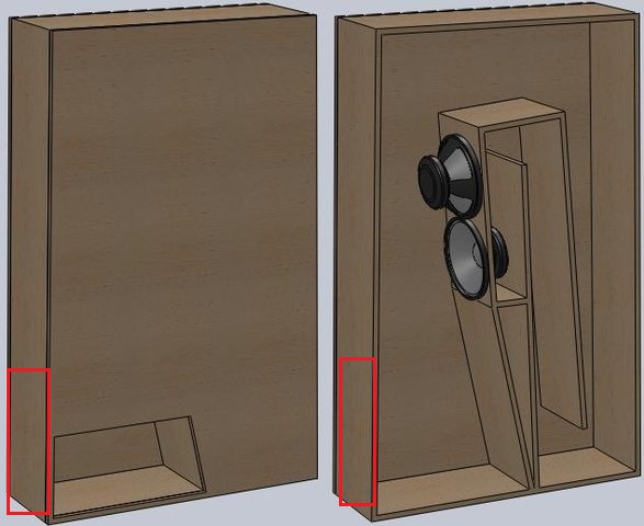

Would the Kraken 212 TH not possibly benefit from a keystone exit mouth? I want to use mine up to 50Hz - 60Hz, and it seems that the keystone exit mouth does provide a smoother response. The the following post: Keystone Mouth compared to full width Exit from the thread: Keystone Sub Using 18,15,&12 Inch Speakers. From what I read I would do a keystone shape where the bottom of the mouth is at least twice as wide as the top. What do you guys think?
Thanks,
Deon

Can the opening be placed as illustrated here..?
