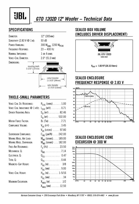

I hope the specs of the JBL GTO1264 are similar. I could swap one oversized (poorly designed) horn (32 cu ft ext) for another slightly smaller horn if that is the case!
I can't find the T/S Parameters for them though.
Either that or a 6th order bandpass design I had in order to compact cabinet volume.
Also braced 12mm ply would be an advantage

To be fair, with the significant filtering and delays required to get a TH integrated into a system, I'd expect a reasonable amount of EQ to be available. So long as the T/S parameters aren't spectacularly different, I think you'll be fine.
