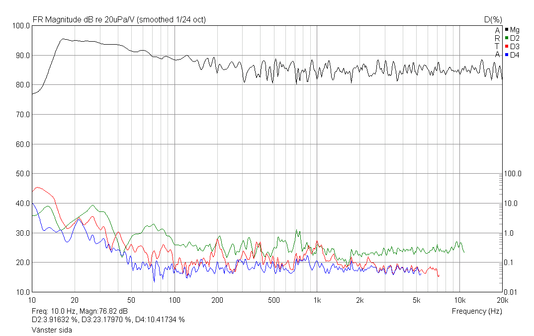

One thing I havent seen in this thread (and that hit us when calibrating my setup) is the quite high distorsion from the horn. My consultant blames the cheap drivers, and I guess that might be right.
Here is the measurement on dist if someone wants to see.

In order for my setup to get the lowest possible distorsion the consultant put a LP filter on 55Hz for the horns. Currently we dont have any subsonic filter (might add compression there later on).
I am not sure what you want to see here, but here is the complete picture for my Left "system" (meaning horn + left front speaker).
Does that help?

Yes, that looks great. Setting the LP for the TH @ 55 Hz sure helped that 55-80Hz distortion peak. Great system. 🙂
