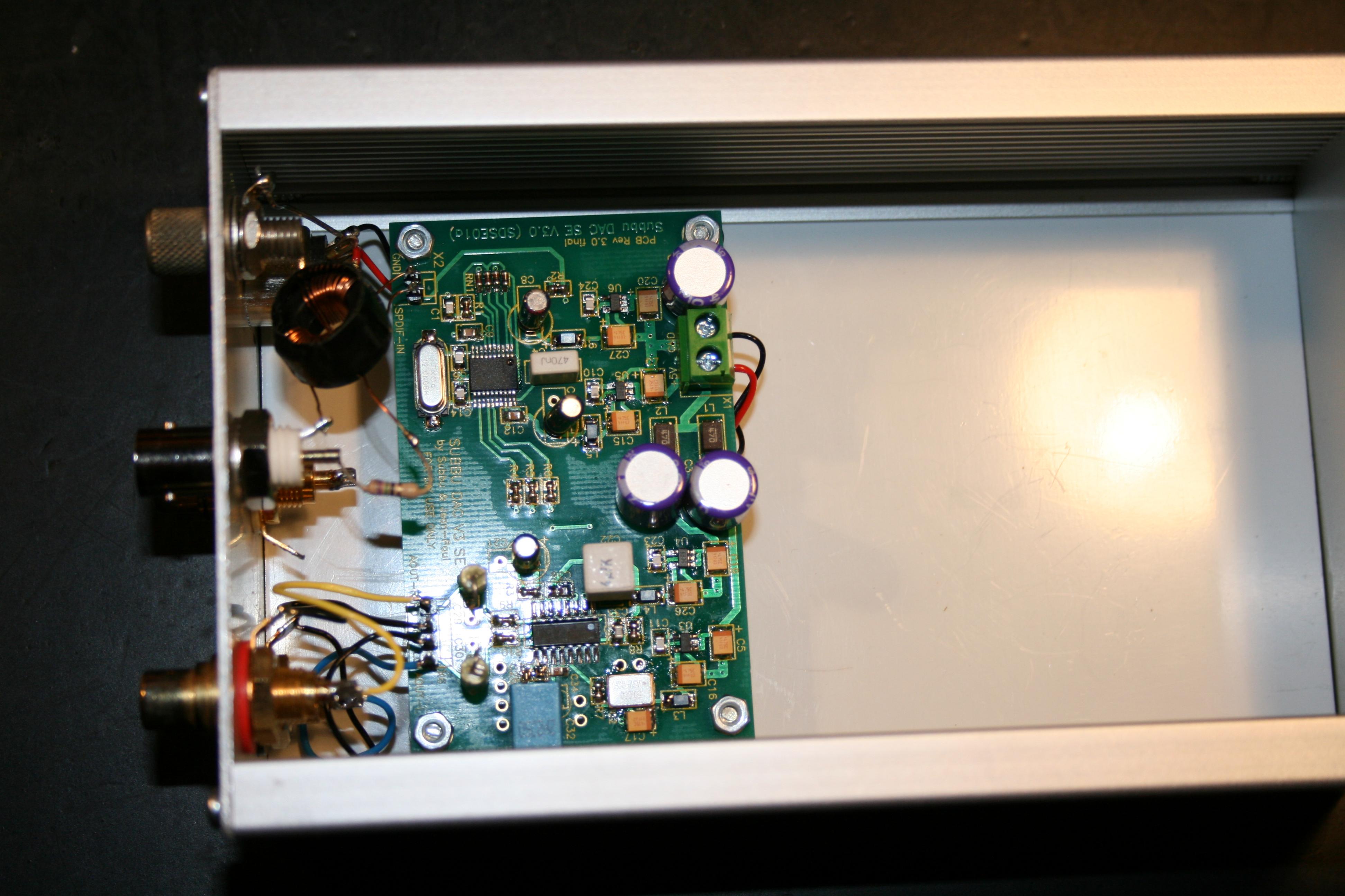

Since it was unusually cold in California, I spent today indoors soldering up a V3 board. I'm mostly done but waiting for the 50Mhz crystal oscillator to arrive. Here's a picture of the progress so far. And I promise Jean-Paul that I will clean up the solder flux before I'm done.

Looking good. I am starting up my build. Needed to buy some 2.0 reading glasses for the small parts. 🙂

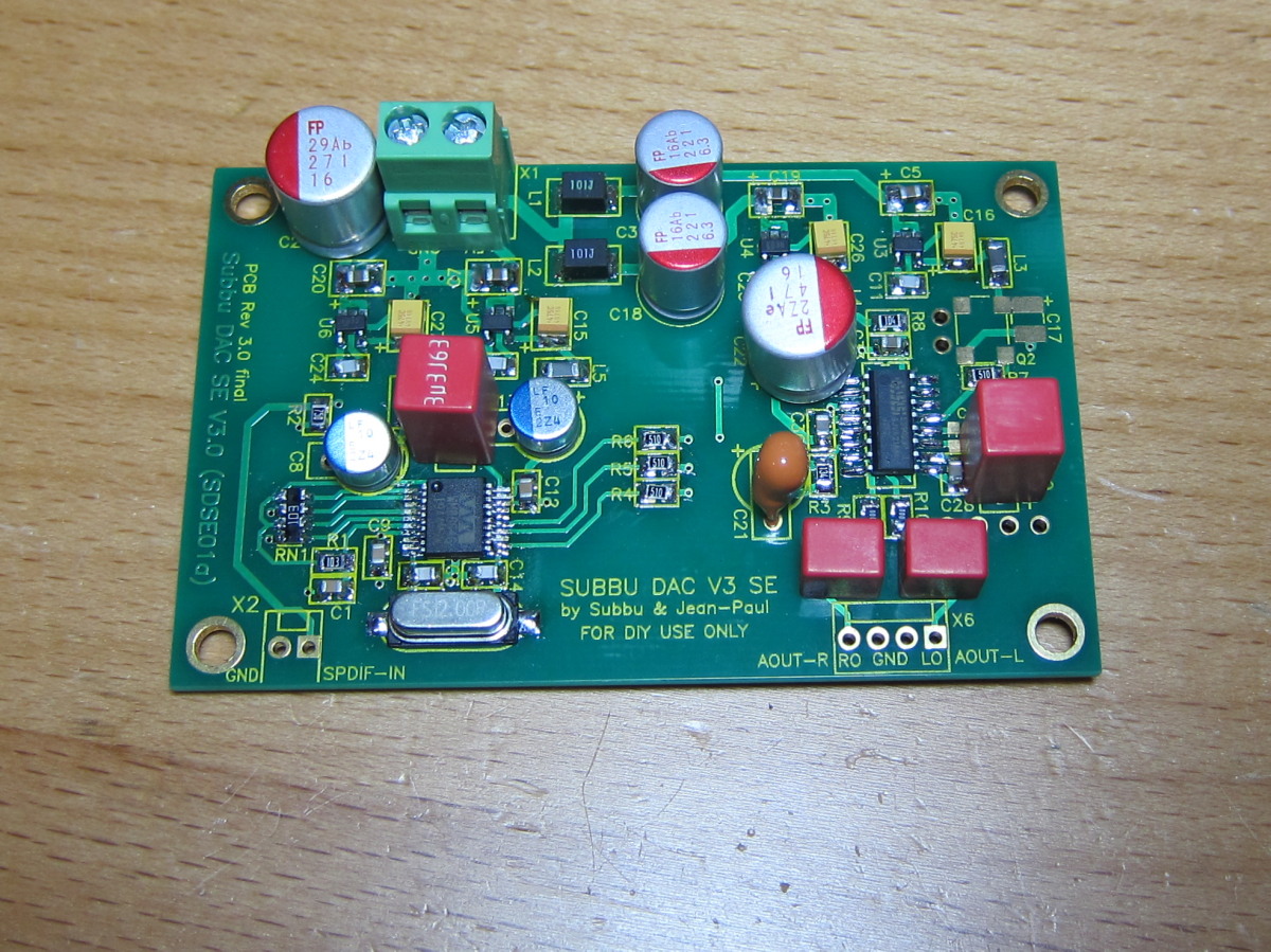

Is up and running for about one week. I did not use any exotic components - I've used 4.7 uF MKS for positive and negative rail decoupling at the ES chip. Replacement of the 1uF mlcc charge pump capacitor by and mkp (the blue one on the picture) did not affect the sound either. Sound is open, clean and detailed - but who am I to judge - just build and listen...

Paul, Could you give a little more detail please. Is the charge pump cap connected to A & B only. Can't tell if that is a bypass type setup from the photo.
C32 & C35 are bare?
C31 installed on bottom?
Thanks.

Hi Bob,
C28 is the blue cap located at the position of your picture - 1uF epcos
I've used 100nF mlcc at C34 and C36 near the DAC chip. C22 is a 4.7 uF mks (gray) and (C31-C32-C35) is also a 4.7uF gray (bottom side at the C31 pads - otherwise I couldn't mount C28 on the top side). Hope this helps - I'm not a fan of using large caps after a regulator - but feel free to do otherwise. Input caps before the mics are Sanyo Oscons 100uF. C29 and C30 are old stock Philips film caps.

Ok, I think I understand (C31, 32, 35 on bottom). I'm very happy that your V3 build is working, but my bigger concern is centered on what might be called a "standard" build. Did you establish operation with something like the BOM shown in post #113 first and then tweak/upgrade. I think there will be many of us seeking a less sophisticated base. JP has often and correctly reminded us this is not a project for beginners. However, it would be comforting to know operation is achievable and stable using at least one universal collection of parts.
Bob,
For c28 use as recommended. The BOM mentions for the (C31-C32-C35) various options - the pcb layout allows you to "mount" various types. I've chosen one MKT 4.7uFand a mlcc ceramic 100nF for each rail. The pcb-s are of great quality - I've already swapped various components without have problems with the pcb. You can always replace components at a later stage to find out what you do prefer.

Asgaard, when reading your name I remember a promise I did not keep(which is a big no no in my book normally). Just printed out your address. I assume you can still use the promised parts ?
BTW is that a self wound SPDIF transformer ?
BTW I like the looks of the board. Too bad I can't get hold of those caps here. You will have a hard time soldering the XO with the 4.7 µF in place !
