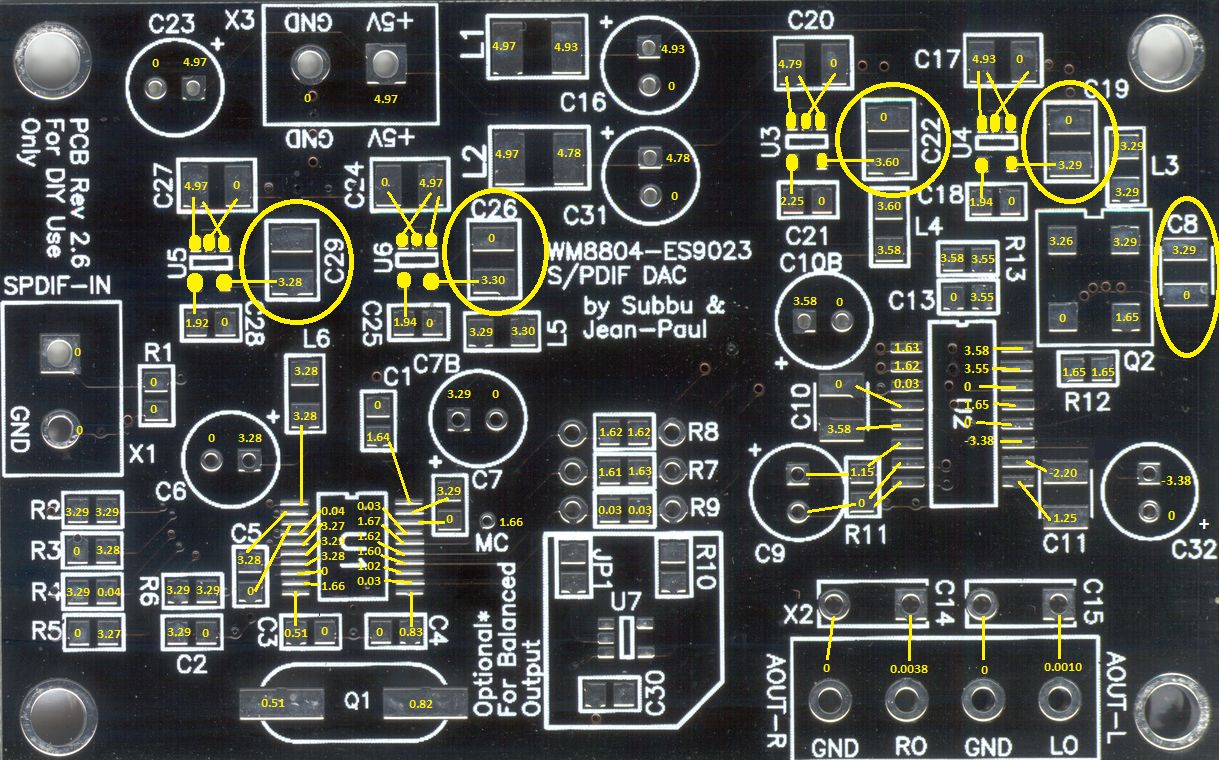

Then take measurements of the voltages on every pin of the WM8804 and ES9023 and compare it to the voltages of known working DACs. There was some discussion where this type of troubleshooting was done in the earlier thread on the original Subbu DAC. Take a look at this thread http://www.diyaudio.com/forums/group-buys/211201-es9023-wm8804-s-pdif-dac-group-buy.html and in particular posts 540 and 552. Those posts show some details on the expected voltages.

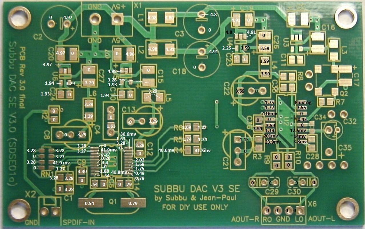

I checked voltages and I am pretty much spot on except Ess9023 pin 11 & 12 which is 1.7 and WM8804 pin 13 is 0.23V vs 1.02V whish is only big variance.
I resoldered 8804 and some suspect chips but still same result..
Are you suggesting I remove C31 completely and keep C34 ?
On a whim I removed C31, checked key voltages and connected but still does not fix issue. Henry is correct that his bom shows "c31 or c34" but the bom I have has no mention of it.

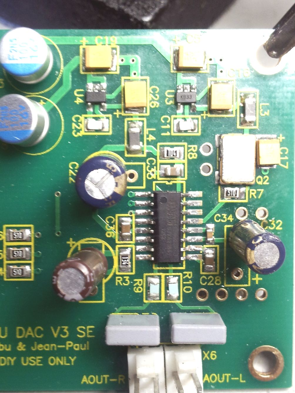

Fred, I checked Q2 and pin 1 is not connected to anything, only pin 2 goes to ground.
I'm going to order Q1 and Q2 from Mouser and see if replacing one at time fixes it.

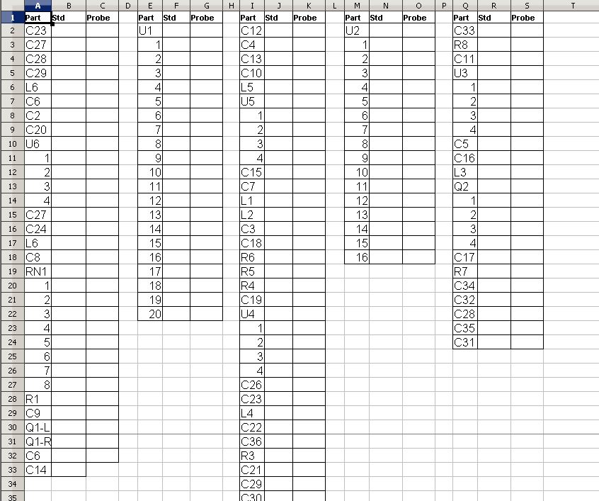

Here are my readings. See something - say something. I hope the values in the photo can be adjusted to the correct standard values to serve as a reference document in the thread's first post. Two colors were just for readability - still need some work there.
There is also a printable sheet to record probe values. That also should/will reflect nominal and actual values. The order is from top left - down. then back up in columns. A simple BOM style sheet is coming.
You've got a problem with the negative charge pump - the voltages at ES9023 pins 9, 10, and 11 are wrong. Check the wiring around components C28 and the various capacitors (C31, C32/C35, C34) hooked up to pin 11. Something is wrong there.
---Gary
I'd play with it a bit more before reordering. Try resoldering all the connections and see if that helps. Maybe there's a bad solder joint. Or try removing some of the Vneg caps (C32/C35 or C31 or C34) and see if that makes a difference. Perhaps you fried one of the small caps by accident. It would be good if you could narrow the problem further.Can't see any shorts or bridges. Think I should just order replacements for pieces in that area?
