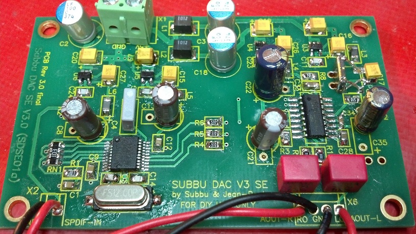

I just fired up my power supply and getting 4.94v. Connected my dac to power supply and no smoke so far.
Any suggestions for next steps?

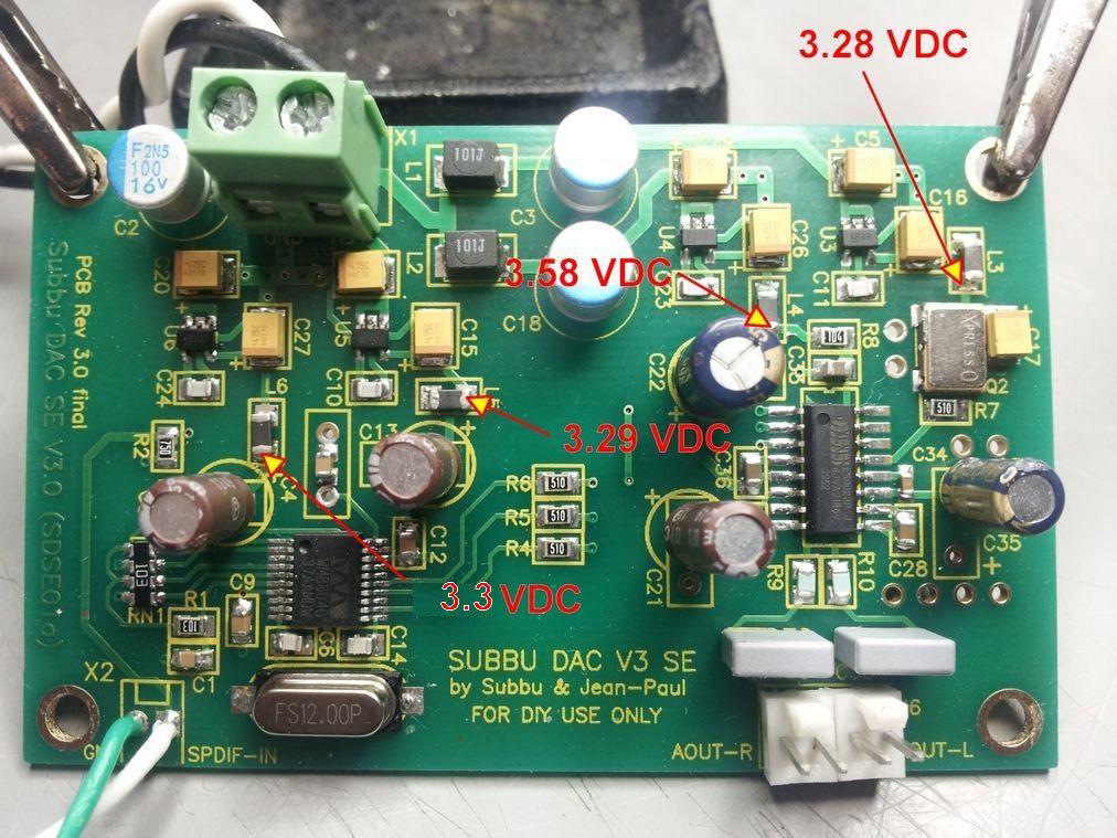

Checking the voltage at the spots on pic L3, L4, L5, L6. That's as far as Iv'e gone.

Observed the following during build when i had some problems with overheated oscillator: if the oscillator is not working on pin 11 of ES9023 you will measure a voltage <1v. When oscillator is working you measure on pin 11 around 3.2-3.3V.
Atupi, do you know which one is pin 11 if the dot on chip is left side?
I am not getting any music from output.
edit...I found a better datasheet....google 🙂
K so I am getting 3.3V on pin 11. Any suggestions?

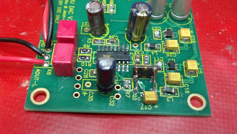

I checked Q2 and noticed that I did not have one of the pads connected. I removed Q2 and put it on its side and then added left over leads to the 2 farthest pads so all 4 are connected. Fired it up and found that L3 is only 0.8V. I checked C19 and I have about 4.5V but C5 only has 1.7V.
I reseated C5 but still get 1.7V.
Neville,
What part did you buy for Q2? It doesn't look like the right part.
---Gary
Well, I had it incorrectly positioned. I have all the correct voltages now but still no sound. I suspect I might have fried Q2 because the amount of time I fiddled with it and had an iron to it. I do have 3.3V on pin 11 of ess9023 chip so maybe there is still hope.
