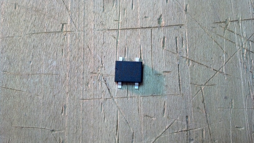

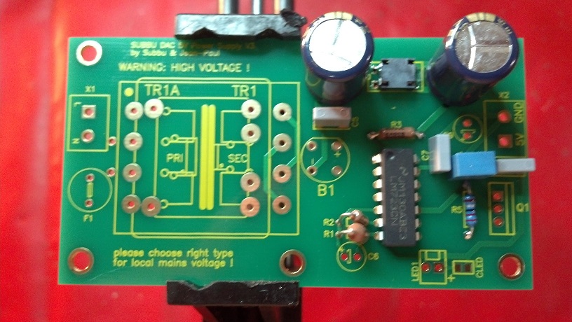

Started soldering my PSU pcb and noticed that the B1 part number from Mouser is not correct - p/n 512-DF01S. I believe it should be p/n 625-2W01G-E4. Can somebody confirm this and is there an updated BOM?
I've ordered this bridge:
Mouser Part #:
625-2W04G-E4
Manufacturer Part #:
2W04G-E4/51
but anything similar will do, so no reason to order from Mouser.

Atupi, I picked up NTE5305 at local store here.
Thx for the info and pics GaryB & bcmbob.. Hope to fire up the power supply by itself tonight.
