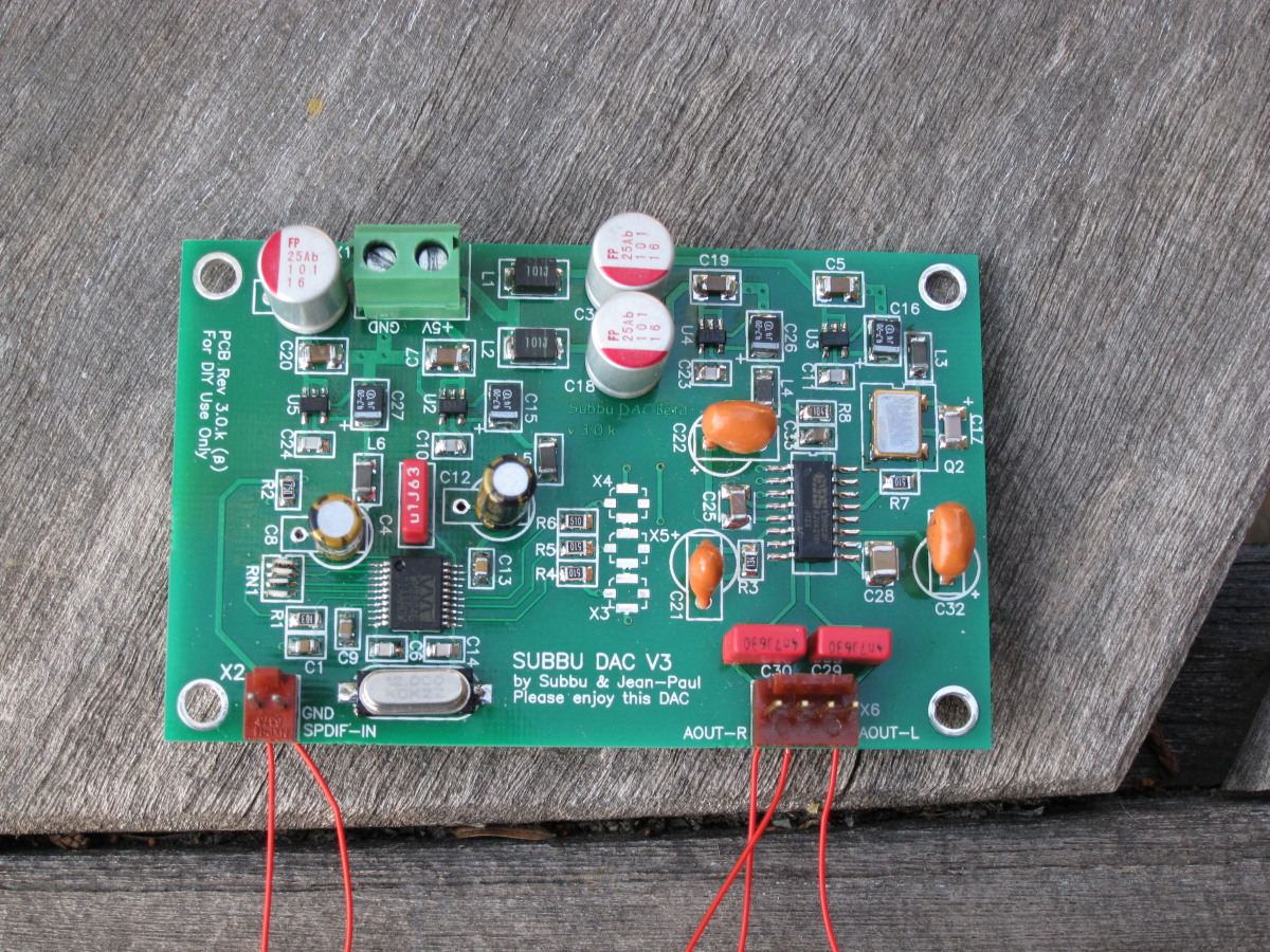

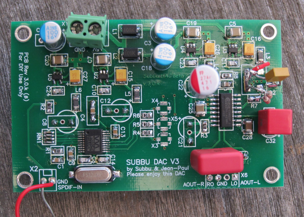

JP,
I borrowed a version of the v3 DAC from Subbu with the Alu Pearl Caps (SAL-RPM) for C21, C22, and C35. C21 10uf, C22 68uf, and C35 4.7uf. I compared it to the DAC with 470uf Polymer cap for C22 and Wima MKS2 everywhere else. The two DACs are pictured below. The sound of the Polymer cap / Wima MKS2 DAC was better than the Alu Pearl DAC with fuller bass and better soundstage. Both sound good but the Polymer/Wima DAC was noticeably better. The Alu Pearl DAC was very good and better than my original v2.6 DAC build. But as I said in my previous message, the ES9023 seems very sensitive to the C22 capacitor and likes a very big value for this cap. The sound kept improving when I went from 100uf to 220uf to 470uf. I didn't see much additional benefit when I went to 560uf. The quality of C21 was not that critical but polymer was better than conventional electrolytic. Wima MKS2 was as good but not better than the polymer. For C35, the Wima MKS2 4.7uf is better than polymer in this location. The 4.7uf Wima will fit on the top of the board. You can mount the 10uf Wima below the board if you want to experiment with bigger values.
---Gary

Did the SAL-RPM caps have some hours of duty when you compared DACs ?
BTW both DACs have different XO's it seems ? Am I right ? Comparing is difficult then.
JP,
You sound like a skeptic, which is probably a good thing when considering audio tweaks. I did mention that the XO didn't make much of a difference. I also retrofitted some of these changes in my older v2.6 DAC with good results. I did this because I was dissatisfied with the sound of the v2.6 DAC after completing the v3 DAC with polymer and wima caps. And my v2.6 used Black Gate NX for Avcc and NEG. It also uses a standard 50Mhz XO. Adding the bigger polymer cap for AVcc, the 4.7uf Wima for NEG, and a 10uf polymer cap for Vreg raised the sound level to a good degree. I also added the bigger SPDIF input cap (3.3uf Wima) but didn't bother changing the other WM8804 caps. Sound quality was close between the builds at this point, so I think the XO isn't a critical part change. Regarding the hours on the SAL-RPM caps, I don't know how long Subbu had played it but I ran it in for at least 48 hours before doing serious listening. Probably longer but that was 6 months ago and I don't recall exactly.

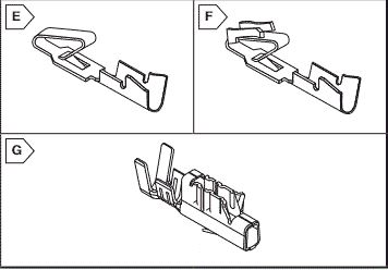

BB, That's exactly what I was looking for. I just finished a battle with header pins on another project where I eventually had to solder directly to the board/pads. All the available connection methods have their drawbacks. I have found the the small female side of the pin style easily loosen with a lot of on-offs. A dab of RTV helps. I'll probably use a solid fix or pins at the final build. The block may help some during all the activity in the build test/phase.

Terminal blocks certainly help in the test phase and I don't think that they are any worse than KK crimp terminals and headers. It's just a matter of preference. As you say, hard wired solder connections are the best for the long term.
Mouser has them, I found the gold plated variant (which i don't use myself) in a few seconds:
26-61-4040 Molex | Mouser
They will have the tinned version too but you will have to scroll around yourself. Never mix gold plated headers with tinned plugs or the other way around. just just both with the same plating material.
BTW hardwired soldered connections are in fact worse then crimped/screwed connections but that is another story.
I would agree that mixing dissimilar contact metals should be avoided, due to the galvanic and thermocouple effects amongst other things. Designing for the minimum number of interfaces between conductors is also a good thing. "High pressure" crimped connections can achieve an airtight connection avoiding surface corrosion and possible diode effect etc. But, if the header pins are soldered to the pcb tracks you still have a soldered joint, not to mention the friction joint between the crimp terminal and header pin.

With DIYers there is no permanent install I thought ? I burned my fingers too many times thinking I would close the case and just use the device but then ... a new PSU, a new revision DAC PCB, new caps etc. etc. Using Molex KK for some time I can tell it is way easier to replace complete PCBs or to do service on the boards. They are just good connectors for this task. Of course there are knockoffs that are not as good but original ones are fine.
Thanks BackinBlack for neatly steering away a possible disaster regarding discussion on what are the best connections 😉 I hope your explanation is enough for Bob.
So are you talking about the crimp end of the female pin? I had a stock of straight square PC sockets similar to these and would make separate leads with heat shrink tubing. I considered having four mating surfaces instead of a single tab to be an advantage.
I even soldered after the crimp was done. Is that not advised?
JP. I am not interested in a long detailed discussion about connectors or the infamous "my favorite hook-up wire" dialogue. As I said earlier, most of those things end up sounding like the "How many angels fit on the head of a pin?" discussions. Been there - done that. Only seeking your best call as the designer.
