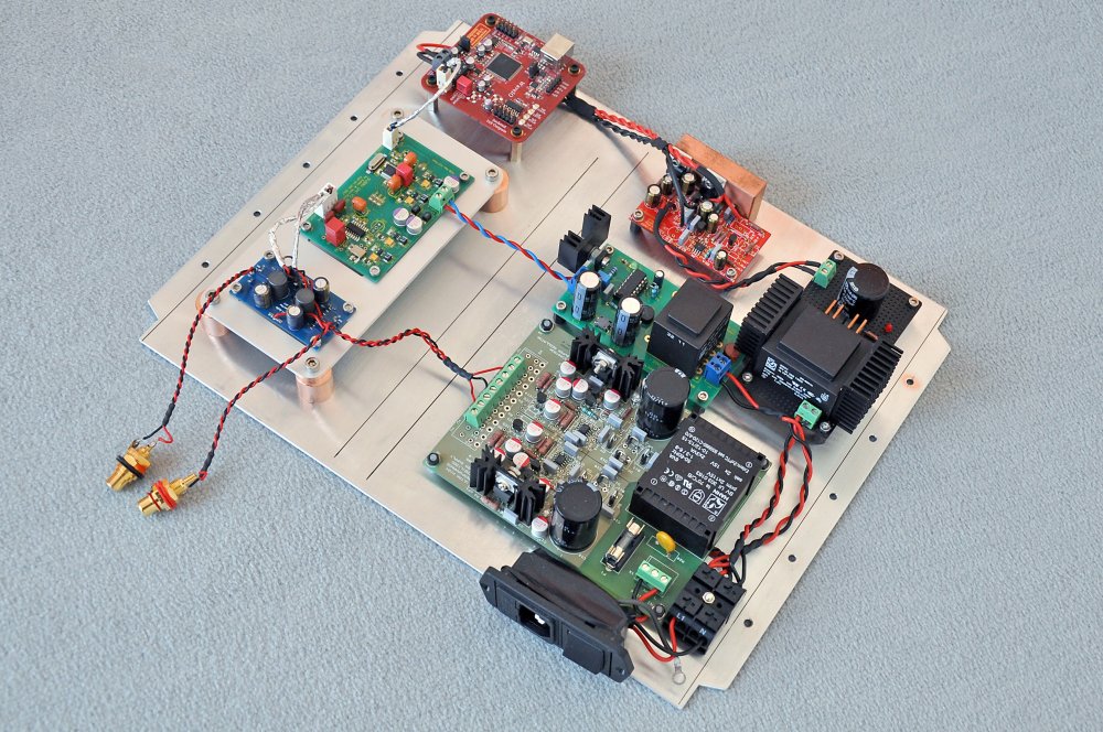

My build is making progress (casework) and is sitting on the floor as in the attached picture for months now... playing very nice and trouble-free.
As you can see it is WaveIO into the Subbu into a JG buffer with their respective power supplies. The WaveIO was a huge step up from the Hiface EVO with battery supply I was using before...!
Final wiring will be all nicely twisted and wrapped, but I need the parts of my casework first 😉
