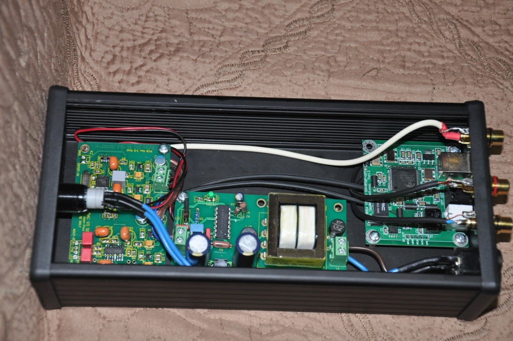

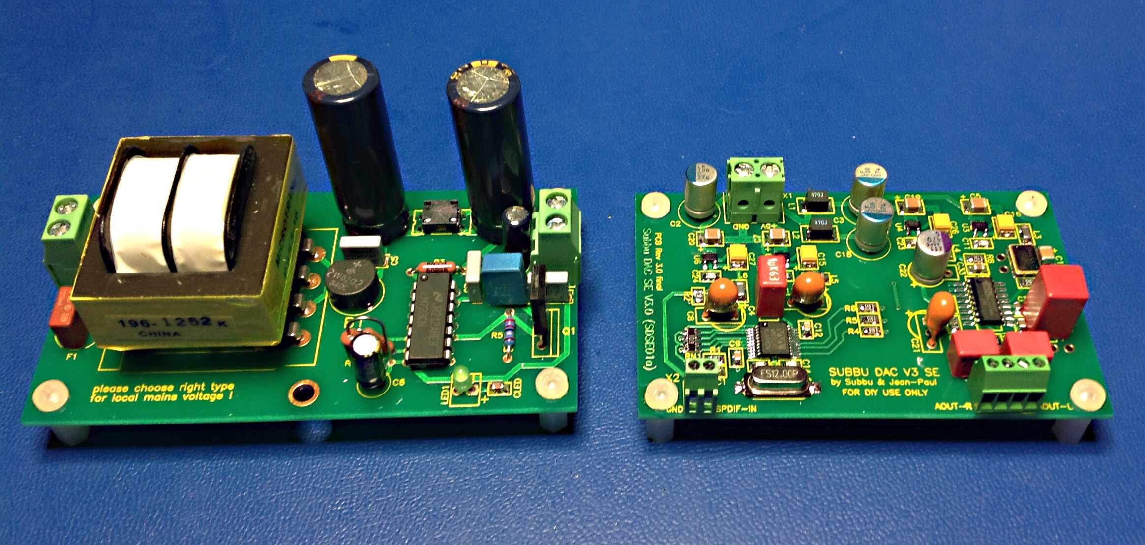

Why not to try to put the transformer farer : here it's very near the Wolfson !
Try to put the PS pcb // to the DAC PCB :transformer in the high right corner, the power wire the farer you can of the spidf plug (here put it on the right side of the box !
If you can go for a larger box with 1O cm of wire between the 2 pcbs...
If you can : go for true 75 ohms BNC plugs : both on the Subbu and your source (or stay like that if you can change the plug on your source).
(personal advisse : I found the 2 x O.1 uf green vishays on your PS gave an horrible result with me : I switched for the Wimas of the BOM)

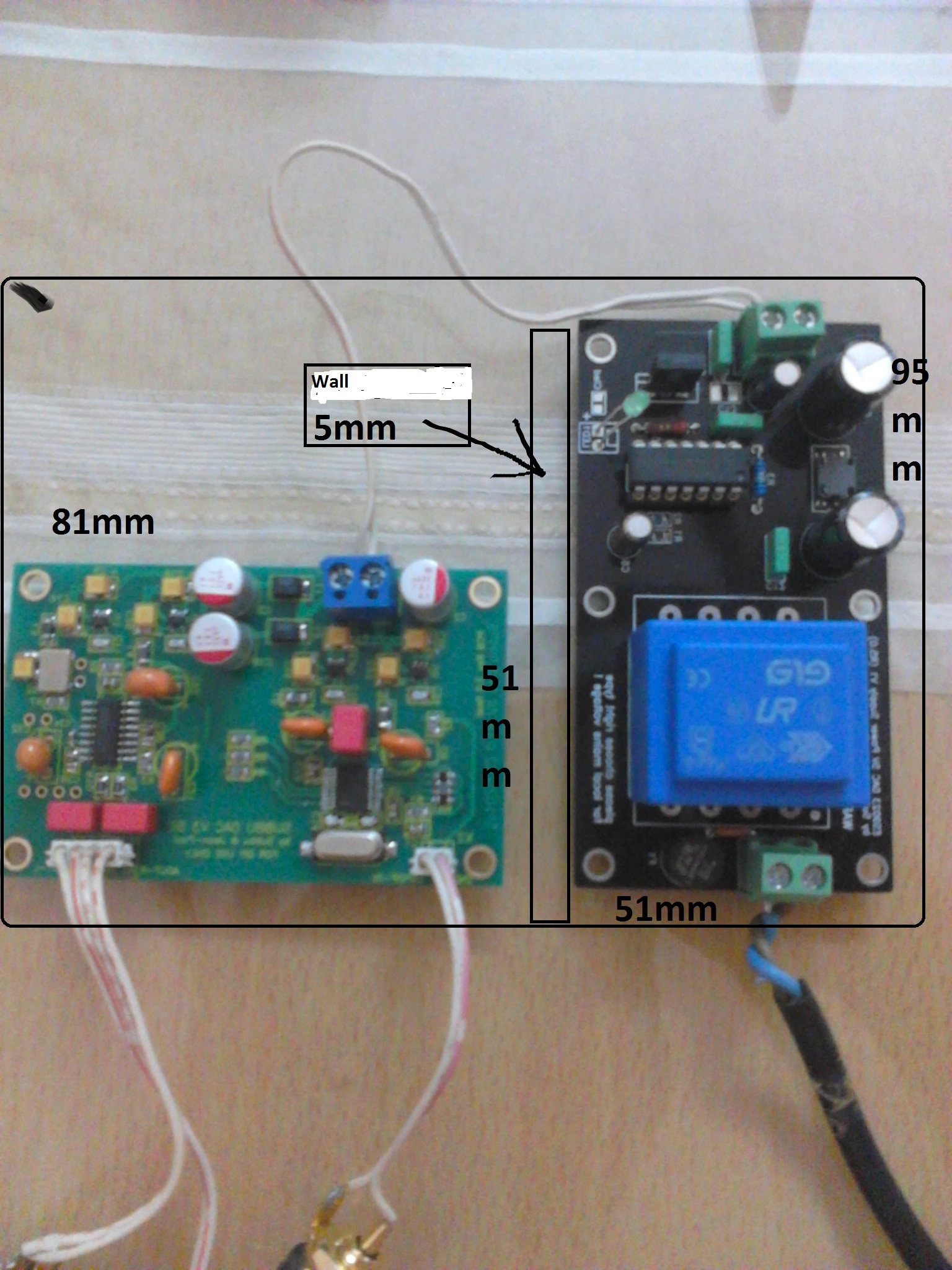

JP is this layout ok?I'll make the box out of aluminum.
It is OK if you mean with "wall" that you will use a metal screen at that spot. I do think you will have a problem making a safe conection of the 230 V AC wiring to the 230 V mains connector.
You case is a tad too small I guess. A slightly larger case will give the possibility to turn the PSU 90 degrees ( and to the upper right corner of the case) which creates more distance between the transformer and the DAC board.
I have no words for this except that you maybe can mill a second case for me 🙂 .... Beautiful ! I have thought about such cases long ago but left the idea as I could not get it done for acceptable costs.
Still be aware that you will need some space for the radius of the wiring. Better have wiring "floating in the air" than it touching the case (even if it is the insulation that touches the case). Mmm, that were many words...

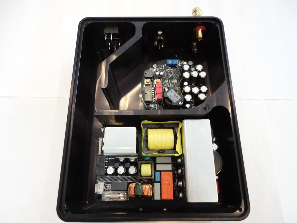

Please see picture 3 in the link you gave. 230 V AC mains wiring is close to the DAC board, in my book a big no no. I can't recall giving other info that to keep the DAC board as far away from 230 V AC wiring as possible. I also see a USB contraption of which I can not tell if it is wired correctly or not (GND).
two cents : first remove the cabinet of the dac and listen to it on a wood plate, measure it if you want, with phisically at one side the 230 V and at the opposite side the 2 V. Try to do 10 cm gap for this test with wires between the PS output and the coreboard ps input. transformer must be away from the chips... for me too close on the photograph even if the transorler is at the opposite, he is also too near from the Buffer.
And the 230 V input above the coreboard is just a no-go.
