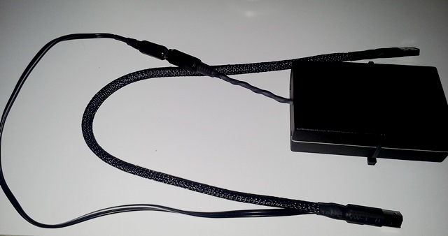

I will do some measurements ... and some mods, first what I don*t like is that usb powers it from source... pc. Not good. I have made diy silver usb cable with sepparate 5V supply and connect it on 4 Nicd batteries. Sound is more organic fuller, very analog, very good.

Puzzles me too. Properly constructed cables with copper are all that is necessary.Silver USB cable! Why?
What I don't understand is why build your own USB cable....It requires 90 ohm differential impedance preferably (though low speed USB will work down a piece of wet string, impedance wise) and home made cable is unlikely to be anywhere near....
But using silver is (unless there is a real reason) just paying homage to the wilder audiophile beliefs that have no founding in physics....
What I don't understand is why build your own USB cable....It requires 90 ohm differential impedance.

He is comparing powering via the internal PC's USB supplied 5 v to his DAC versus using a battery pack as the power source if I am interpreting his posting correctly. I would expect any sound difference to be from the power source not the materials used.
I am aware of that, my question is WHY make the actual USB diff pair cable yourself and WHY has he used silver and not copper, my question is related to that not power down the USB cable...I asked because silver is specifically mentioned so it must have been used for a reason...

I used silver because i have it under the desktop 🙂 For other reasons can we talk on PM. This is SUBBU DAC tread.
Do you think that all usb cables have 90ohm 🙂
I must do my own cable to have possibility to use another power supply. In future i will do some regulators instead of batteries. The best i will install it into dac. Why soldering in and out trought nice made dac...
I have some other usb cables at home from supra to cardas... i don*t like it because sound was mellow slow, with lack of details. And cutting it down to get the 2 wires out was pointless.
We are on diyaudio forum...why not do something diy 🙂

Indeed. But it is electronics after all, even if DIYing, one should apply known principles of physics.

Yes its part of the USB spec and a pre-requisite for putting a USB logo on manufactured cables.

I cannot understand how a non damaged correct specification digital cables can effect the sound thus, I have heard these claims for both SPDIF and USB cables and even that you can correlate the digital waveform with the resultant sound. I have tried numerous USB cables and not noticed any difference, I have also seen numerous USB cables tested and they have all worked with no problems.
I have asked but never been given a reply why silver cables are better for digital signal transmission over copper cables...
In simulations I have done I cannot simulate any difference between the two metals for digital signal transmission (the slight improvement in conductance has a negligible effect).
