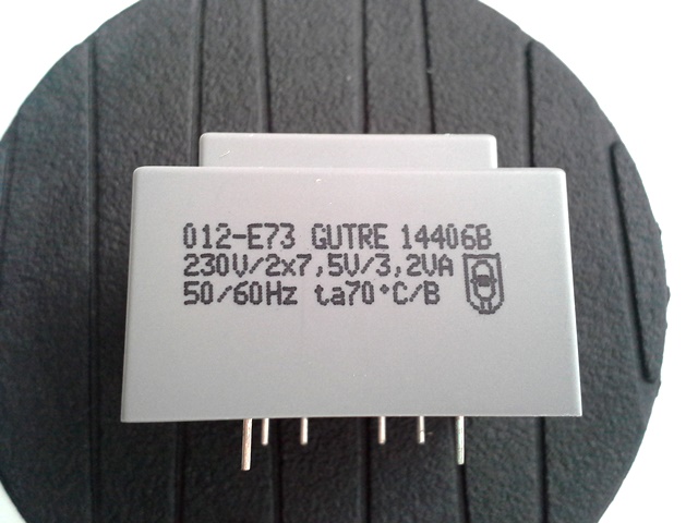

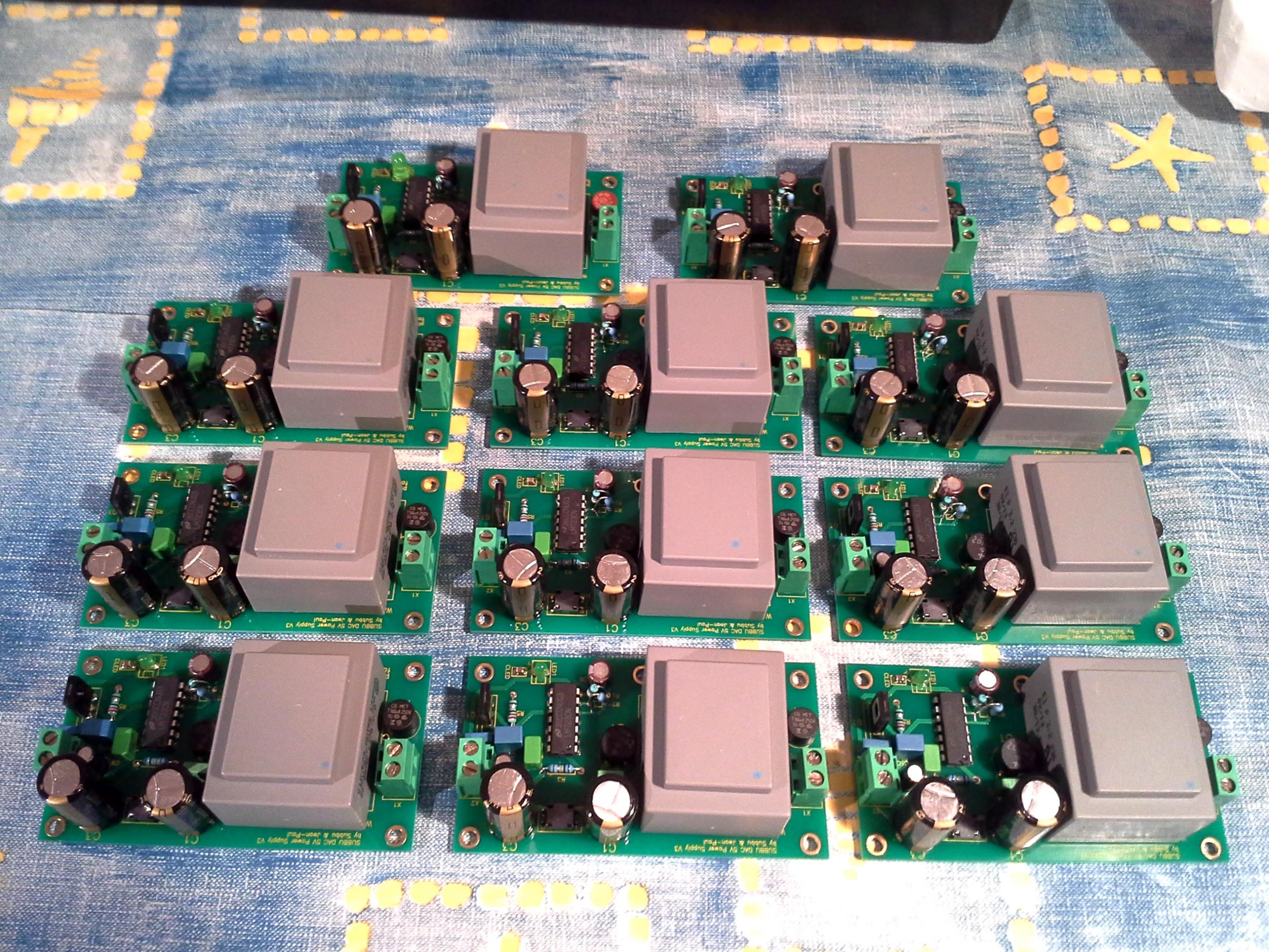

We talk about jour suggestion on not using 2*9V transformer because of to big secondary winding voltages...
Because of high number of pcbs to solder, I didn* wont to risk so i deceided to buy this ones.
GUTRE 230V/2x7,5V/3,2A
Spec are here http://www.neuhold-elektronik.at/datenblatt/N7045.pdf
Ac volatge on recetifer at no load is about 9,3V and dc on first 2200Uf/16 Panasonic FM capacitor is 11,8V at no load, so this is perfect.
Just pins must be rearanged for mm or two because of fuse and bridge which are very close to the transformer.
