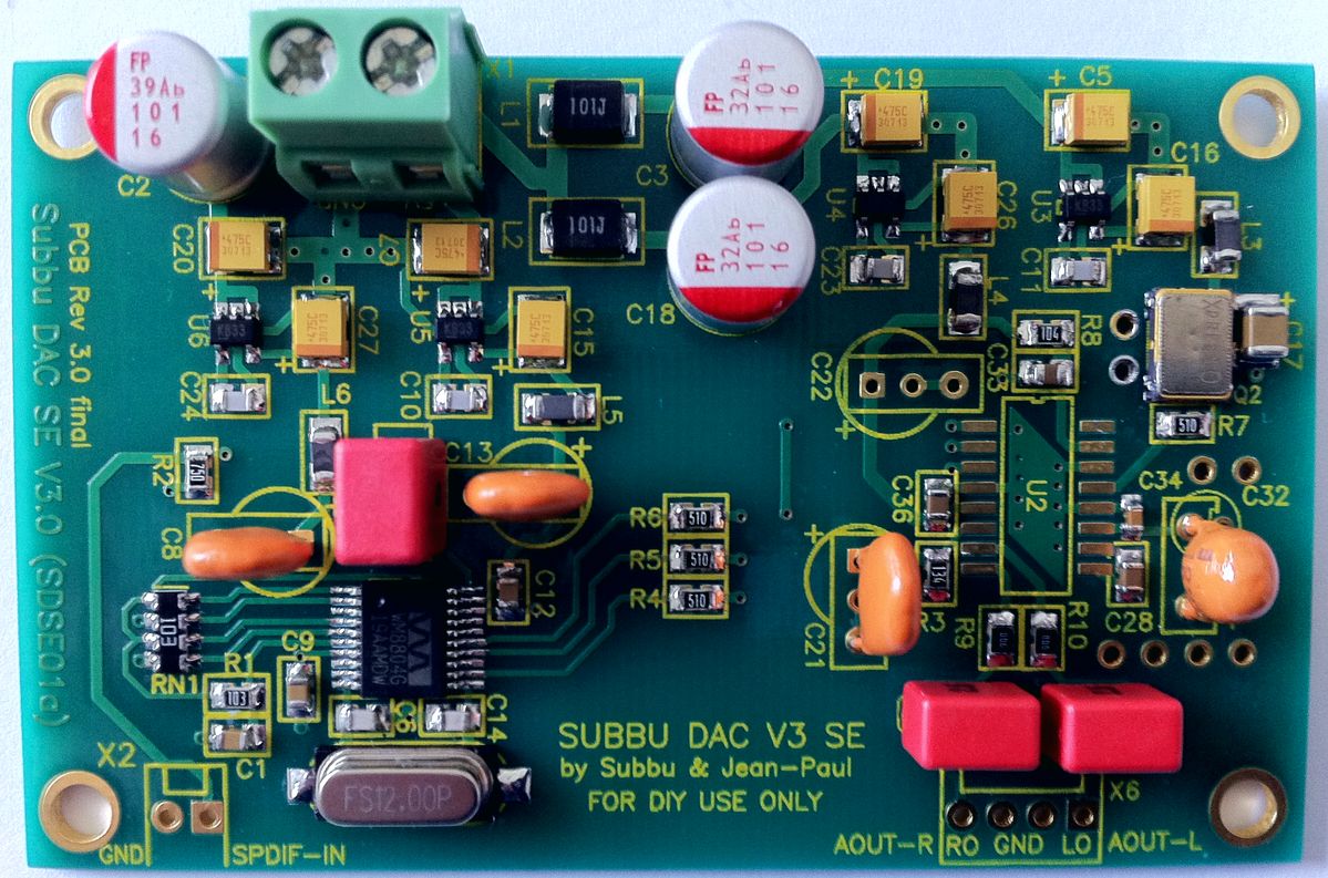

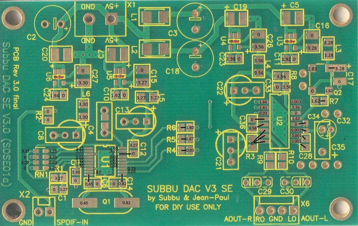

Hi All,
As promised some times ago, pics about Subbu DAC V3 PCB voltage.
Remind : measures were taken without ES9023 DAC chip soldered.
Values shown & measured are relative to this DAC unit.
No wires/connexions/short at the input nor at the output. (Left & Right I/O and SPDIF unwired)
From what I've noticed previously, consider those values as average.
Your values may vary from those reported here.
I'll post another set of pics with ES9023 soldered soonly.
Hope this helps for troubleshooting sessions 😉
Regards
Phil

Hi Darshanjoshi,WM
1 3.280 1.640 20
2 3.280 3.290 19
3 0.000 0.000 18
4 0.039 0.026 17
5 3.280 0.000 16
6 3.290 3.520 15
7 3.290 3.520 14
8 0.000 0.000 13
9 1.700 0.029 12
10 0.550 0.770 11
Your WM8804 values from pin 13 to 16 seems to be faulty to me.
Please check R4/R5/R6 values whose should be close to 0.029/3.52/3.52 according to your measures.
I suggest you to clean the right side/section of WM8804 using flux and desolder braid.
I suspect a short, but can't understand where and how do you pick a 3.52v value there....
Maybe I'm wrong and I'll complete my input with ES9023 soldered values soonly 😉
Would you please check again and report ?
Regards
Phil

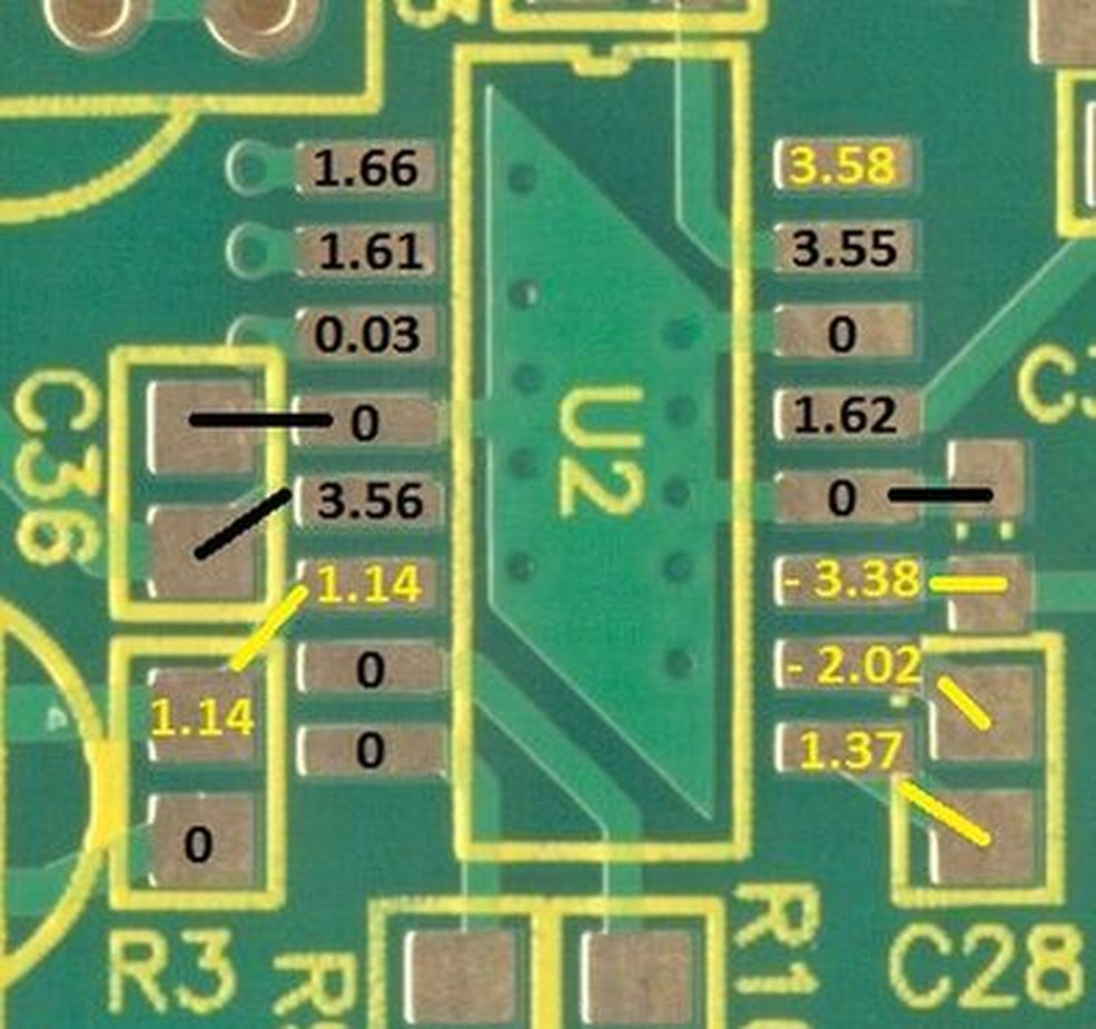

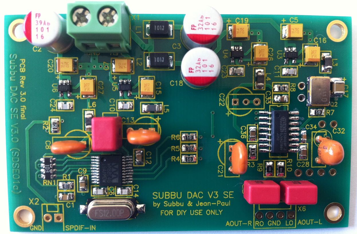

As promised this morning, measures with ES9023 DAC chip soldered.
I've only reported about voltage read on ES9023 pins.
Black : no changes - Yellow : changes
As expected, other values aren't affected.
Forget to mention : the DAC is working fine 😛
Remind :
- Values shown & measured are relative to this DAC unit.
- No wires/connexions/short Left & Right I/O and SPDIF unwired.
- Your values may vary from those reported here.
- Consider those values as average.
Regards
Phil
