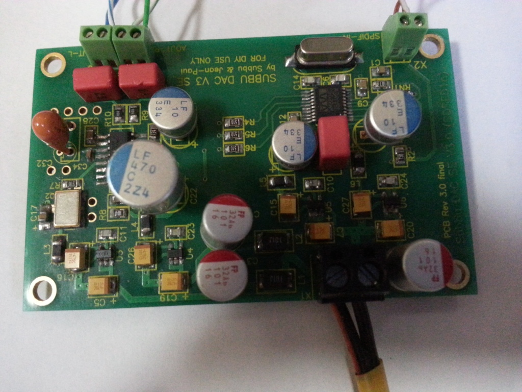

Finally after the first failure my 2nd attempt at the build paid off and I got the taste of sweet music to my ears. And sweet it is.
A big thank you to Subbu and JP for initiating this build. A big thanks also to all those who built and shared their experience and made this happen.
Initial impressions:
- Wide Sound Stage
- Good detailing
- Clean, Deep and Tight base (something that was lacking in my old setup)
- Dead Center Vocals.
Definitely a big improvement over my old setup. Things will improve after burning in for sure. And yes this DAC is addictive 😀
PS: Pic is not the greatest. Didn't get time to click a fancy picture. SMD Soldering is not the best but a big improvement since my first build. I have yet to clean the board but that can wait for now 😀
Better ! Still buy the right SEPC caps (that fit on the board) and push them to the PCB and solder them. Lead wires should be short. Now they are way too long. The DAC will perform even better if you do.
Clean the board with cotton tabs and isopropyl alcohol 99% 🙂

I have lifted the C22 Caps but no output as yet. Hence C22 seems okay.
I have taken some readings at U1 and U2. All readings are taken at 20V DC on DMM.
L1, L2, L3, L4, L5, L6 showings correct Volts.
Also Capacitors before and after U regs are also showing correct Volts.
I can also assure that I did not burn U1 & U2 since I completed them very fast and effortless.
U1 Inputs Values at Position 4 and Position 20 looks off. Could RN1 be problem here? Position 6 at RN1 looks off as compared to other build readings which is Input in Position in 4 of U1.
Can someone please suggest how can I resolve my problem.
Thanks for all your help and Input.
Tried reflowing at C4 and Position 20 but still no luck. In fact also did reflow R2.
Any more suggestions.

I finally got some music after reflowing U1 and U2.
However, I am still facing some difficulties. Sometimes it works and sometimes it doesnt. DAC was operational for 2 hrs then it stopped automatically. Inspite of reflowing U1 and U2, it did not came up. Next morning, when I started DAC, it works fine. Again in the evening it stopped working.
When the DAC is functional :
1. Pin 16 of ESS (ZD) shows 3.57V
2. Pin 1 of ESS shows 1.54V
3. Pin 2 of ESS shows 1.66V
When the DAC is non-functional :
1. Pin 16 of ESS (ZD) shows 0V
2. Pin 1 of ESS shows 3.27V
3. Pin 2 of ESS shows 3.28V
Any pointers where am I going wrong.

On Pin 13 of 9023, you get 1.65V if the crystal is connected properly. If it is not, then you will get 0V. I saw this during my build. I dont know if this is suppose to happen. Check if this is the case with your build too. The crystal is difficult to solder. The method I followed was what was highlighted on this thread. You tin the pads and then place the crystal and reheat it. But in my second build, I put more solder when I tinned the pads. Then the crystal sits on 4 pads as on table and you will have enough gap to get the soldering iron and heat the pad easily.

I get 1.64V constantly at Pin 13 irrespective i get music or not. All other values from Pin 9 to 15 are correct irrespective music comes or not.
Only Pin 16 is zero when music dont work.

I am skeptical if my Crystal is creating problem here.
If there would problem wid Crystal all the values of Pin 9 to 15 go haywire.
My values with pin 9 to 15 remains constant. Only 16 values goes to zero and values at pin 1, 2, 3 changes when 16 pin is zero. As soon as pin 16 values are correct i.e.3.57v values at.pin 1,2,3 also gets corrected and music works flawless.
Even today when i started my dac it ran nicely. Almost 4 hrs i played and there was no problem at all. All parts seemed cool and even no signs on transformer getting hot.
As soon as i switched it off and switched on music was gone.
This happens everytime. I switch it on next day it works flawless. As soon as i switch off and switch on immediately , it doesnt work.
