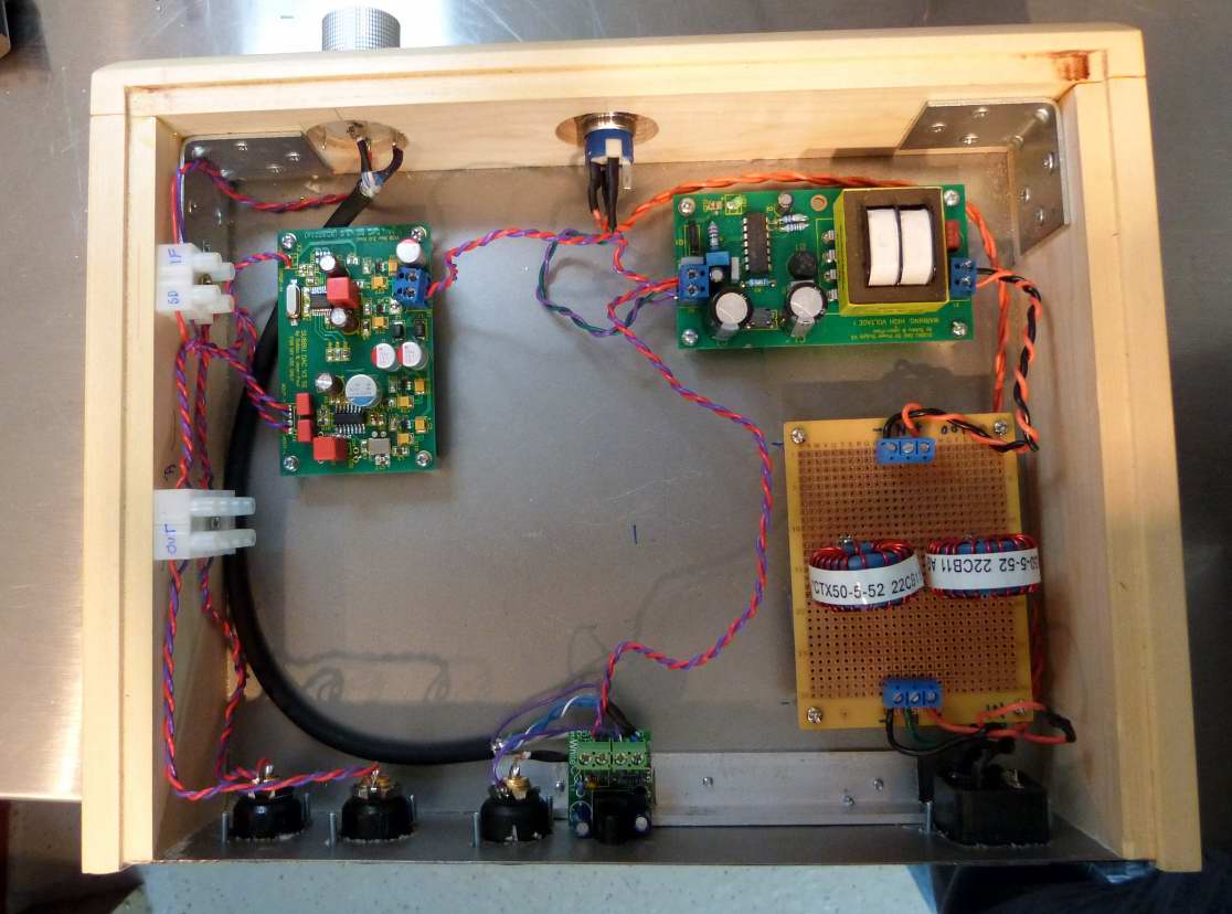

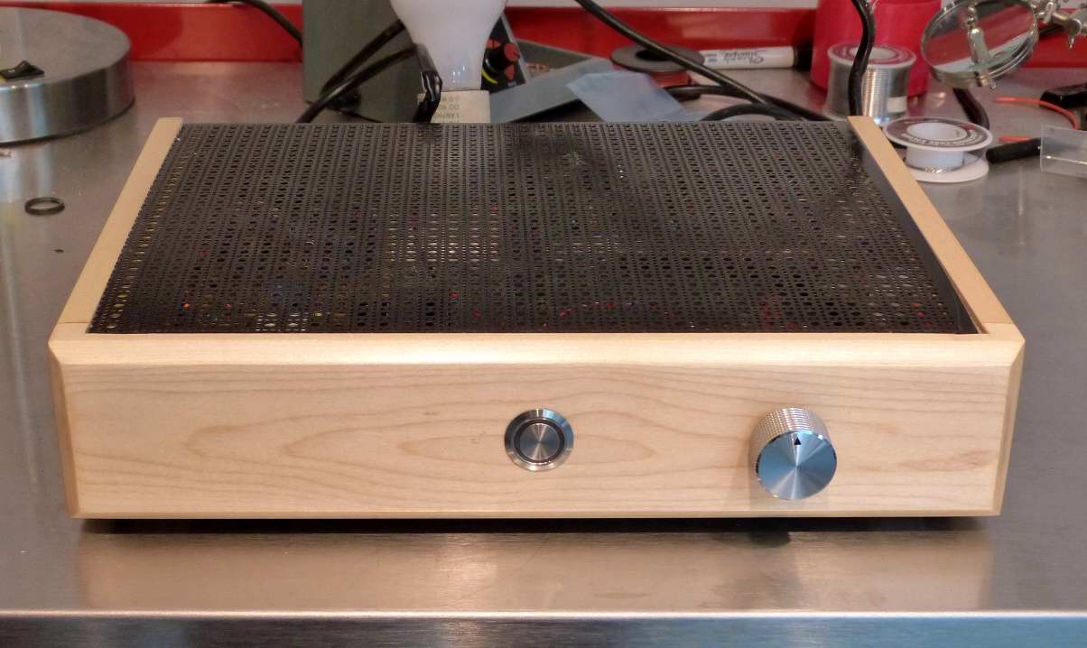

A new Subbu Dac is born. After much trouble with bad parts, either that I messed up soldering or were just defective I finally got my Subbu DAC V3 up and running. After the initial build I found several shorted capacitors and resistors, but after following the circuit diagram I managed to work it out. I've burned it in for a few hours in my garage workshop, but haven't put into my main system for a serious listen yet, I'll do that tonite. But at first blush it sounds very good, clear, open, detailed and dynamic, congratulations to Jean Paul and Subbu. I'll be comparing it to an EZ DAC, and a dual mono twisted pear Opus DAC that I have built earlier. Here are some finished pics, the donut thingy is a power filter. The input selector switches between coax in, optical in, and eventually USB in when I get the chance to put the adaptor into the case.

Congratulations on your build !
I like your case.

Nice build but it is not forbidden to take away the sharp edges after drilling holes (don't know the english word for it but could it be "deburring" ?). A file does wonders there. You won't cut yourself now but you will when you are changing something in the device.
Also some of the connector blocks you choose are not necessary, you have some superfluous connections at the outputs. Better wire the outputs directly to the RCA connectors.
I take the toroid line filters are for taking away RF ?
Bob et al,
The power filter is a Jon Risch design, the capacitors are under the board. I've used it before on past builds and in my situation it has provided some benefits with consumer based gear. It might be superfluous with Jean Paul's excellent PSU, but it is cheap insurance. As for Jean Paul, yes you are right there are extra connections, but since I needed to take things apart so many times to track down problems they were very convenient. I did get a chance to listen on a worthy system tonite and was very pleased. It replaced a dual psu EZ DAC, I have found the EZ DAC to have a lot of detail, space, and to have a punchy character, but always felt is was a bit sharp and aggressive. The Subbu Dac has a the same level of detail, a great sense of space, and is more relaxed. Definitely somewhat warmer. All in all I prefer the Subbu Dac.
