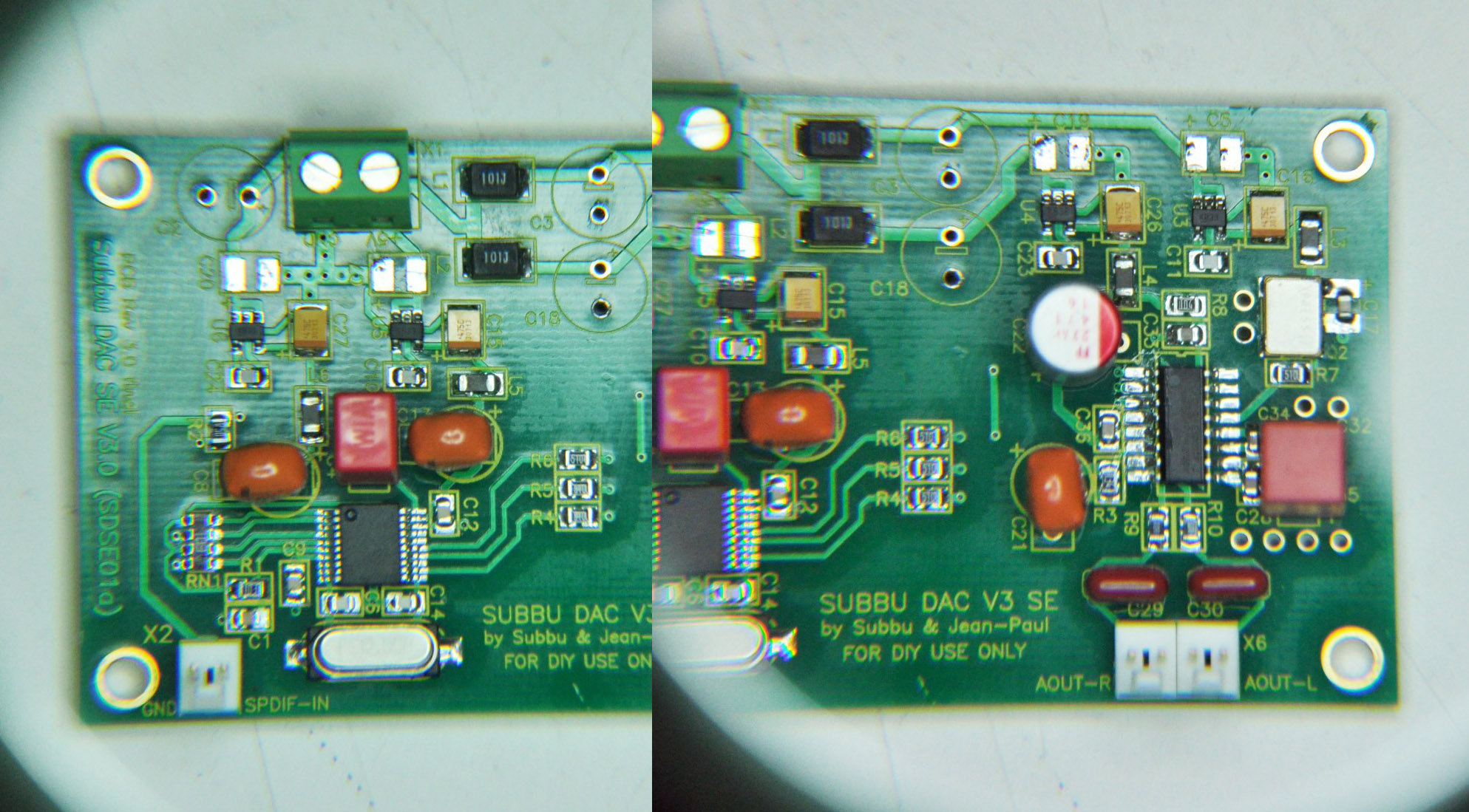

Despite having a perfectly working V3.0 DAC and a spare board I recently scored a built Subbu DAC in the Swap Meet section. It was advertized as lovingly built with perfect spec parts etc ...
but is not working due to a massive short somewhere.
I assumed that it was working and since the soldering looked quite good... but once connected to the psu the voltage of the power supply dropped to zero and the transistor heated up big time.
Luckily the psu survived.
Measuring I quickly discovered that I have full continuity across X1 so started to investigate down the way of power. Eventually I had all caps until the regs removed but still have continuity across X1 and all cap positions?? The caps (C16, C26, C15, C27) after the regs seem to be okay as well as the regs themselves (with DMM --> very high resistance).
Now with basically only blank pads staring at me I still have continuity... which leaves me puzzled. Please see the pics... any thoughts on that?
I hope it is just the described section... when anything further down is defective it goes in the bin (and so does my money 🙁).
PS. Pic composed from two shots through my magnifying lens.

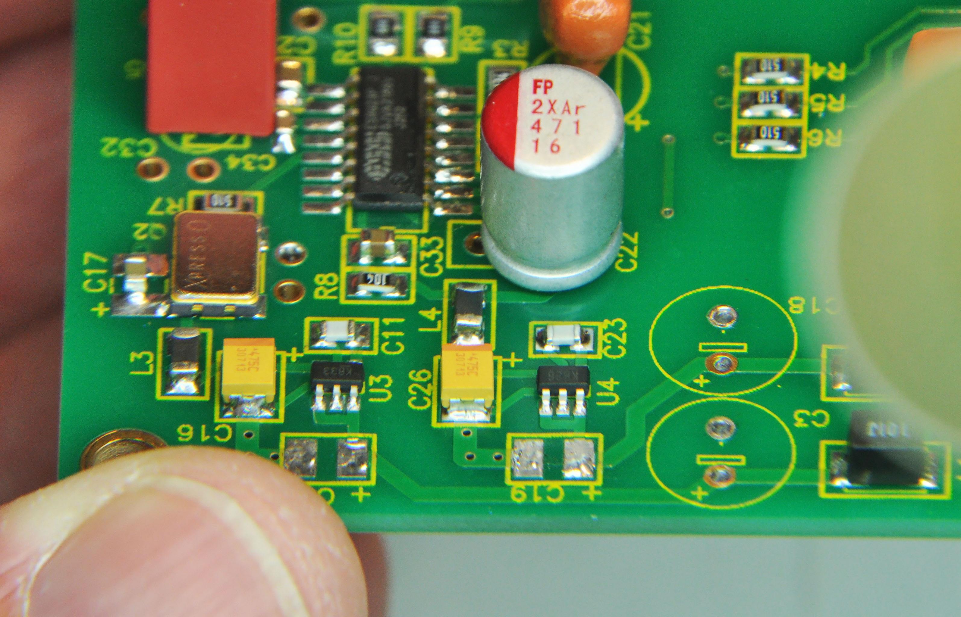

I would remove the beads and coils L1 and L2 and then test if you no continuity on X1 and if you have output voltage on the regs for the WM8804. If so then solder L1 and test again. Again OK then solder L2 etc.... Also checks the MIC regs with a magnifying glas and reflow if necessary. Soldering on the ES9023 is sloppy but I would reflow that one if you have dealt with the short.

No Marce, just one level of squeaking.Does your meter have a short squeak function (ie the squeak gets higher pitched/louder nearer the short)?
I checked ALL soldering joints with the magnifying glass and they look fine... even the ones on the ES9023 seem nicely flowed.Also checks the MIC regs with a magnifying glas and reflow if necessary
What troubles me is that I have continuity with 7 caps removed... I wonder where is the path of continuity? Also I can't power this thing up sans capacitors...
would it be safe to populate all new caps with those symptoms?
You probably have a short between pads of the MIC regs. Wait with the caps till you got it sorted out. It is not only caps that can cause shorts.

I'm with JP. MIC's pin 3 tie to pin 1, pin 2 connect to ground, pin 1 or pin 3 short to pin 2 will have continuity at X1. Pin 5 and pin 4 on the other side and with wider space, unlikely will short to other side of pin 1,2 and 3.
One of my friends had similar problem. Problem was MIC only.
Removing, cleaning the pads and resoldering helped him solve the problem.
I had a similar problem with the U6 reg. One leg was bridged and was just barely noticeable. I ended up removing L1 and L2 and the beads but still the problem persisted. Continuity was present.
Next I started with removing the U6 regs, cleaning the pads and then resoldering the reg with just the right amount of solder required solved the problem.
Looking at the schematic I already investigated in this direction. But will check again. All MIC's are nicely soldered but maybe s'thing is hiding underneath...MIC's pin 3 tie to pin 1, pin 2 connect to ground, pin 1 or pin 3 short to pin 2 will have continuity at X1. Pin 5 and pin 4 on the other side and with wider space, unlikely will short to other side of pin 1,2 and 3.

I fully agree with JP, syyma, darshan & Thecoolestone position.
Go investigate all MIC5205 regs soldering pads.
Soldering job is very good, using a thin amount of solder. 😎
I'm wondering about solder used, it seems to be unleaded, is it ?
Do you have a pic from bottom side, and have you removed X1 ?

Checked all MIC's with a 8x magnifier and tested them with buzzer function. All have continuity which cannot be true. None of the parts are looking abused or burned. All tant caps 4.7uF before the regs buzzed (and were removed probably unnessecarily), all tant caps AFTER the regs are fine. To continue the story I removed U3 -> pads underneath clean and no bridges. The desoldered U3 on my desk has no continuity between pin 1 and 2... so no short here although it buzzed before. X1 is removed, no traces of solder. I am at a loss.
What if shorted at U4, U5 and U6? Power tee off at pin 1 of X1, power route to L1, L2 for U3 & U4 respectively. I see L1 still in the board but not sure about L2. If short somewhere at U4 continuity will present at X1, assumed L2 not remove from the board. Try remove L2 and re-check continuity at X1 since you already have U3 removed.

What I will do are:
1. Remove L1 and measure. If the continuity is gone, then you know the issue is from the down stream of L1. If situation doesn't change, then
2. Remove L2 and measure. If the continuity is gone, then the issue is from the down stream of L2. If nothing is changed, then you can focus on the circuitry on WM side.
This approach should help narrowing down what to check next.
Good luck!!
