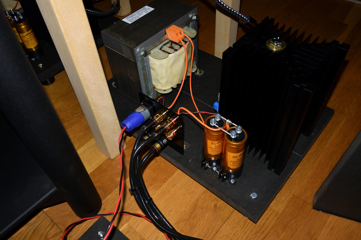

I have had good results with Dell branded power bricks. I'm using a 19v 12A Dell brick for my MoFo amp and it works great. Same with my ACA amps. I've purchased a few $10 power bricks from China that have long since been tossed in the trash for too much physical and electrical noise. The key is to purchase SMPS that are known to the audience here, otherwise you are on your own in terms of quality and problems. The more recent Meanwell supplies seem to perform well.
There is much less guesswork in a linear supply. It always works and is nice and quiet.

It's a Dell GA240PE1-00 that is rated at 19.5v, 12.3A, 240w. My MoFo draws about 120w and it gets only mildly warm. It is also nice and quiet.
The plug is a 7.4 x 5.08mm male jack. You'll need the appropriate female jack to accept this plug. I purchased a few of these:
7.4 x 5.08mm Female Jack. The fatter end fits into a 1/2 or 5/8" plastic wire clamp that can be fastened with a screw.
An image of my build is here.

Yup, no problems at all using one PSU for both channels. Of course, you can splurge and get one for each channel. Either way, it'll work great. I was skeptical at first that the wire from a single female jack would handle the current draw from both channels but it's fine. The wire doesn't get warm at all.

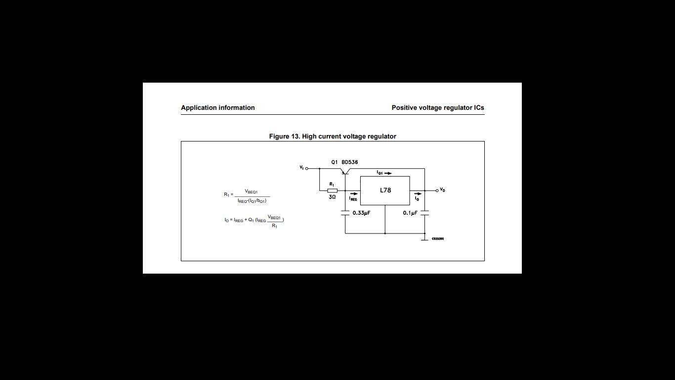

regulated dc power supply
i am thinking of building this circuit.
One TIP 2955G enough for one channel to regulate from 23 v to 20 v?
use TIP in place BD transistor

Eric where did you purchase those great heatsinks?
Pass DIY Addict
Joined 2000
Sorry that I don't have a source for you. I found three of them at a local flea market over the span of about 3-4 months. They were originally 10" long and I cut them down to 5" chunks. Two for my MoFo, four for my Aleph-J. I keep looking, but haven't found any more lately. With 3A bias on a 19.5v supply for the MoFo, those sinks bake off ~60w of heat each with only a ~30c temp rise. I'd love to get my hands on more!
