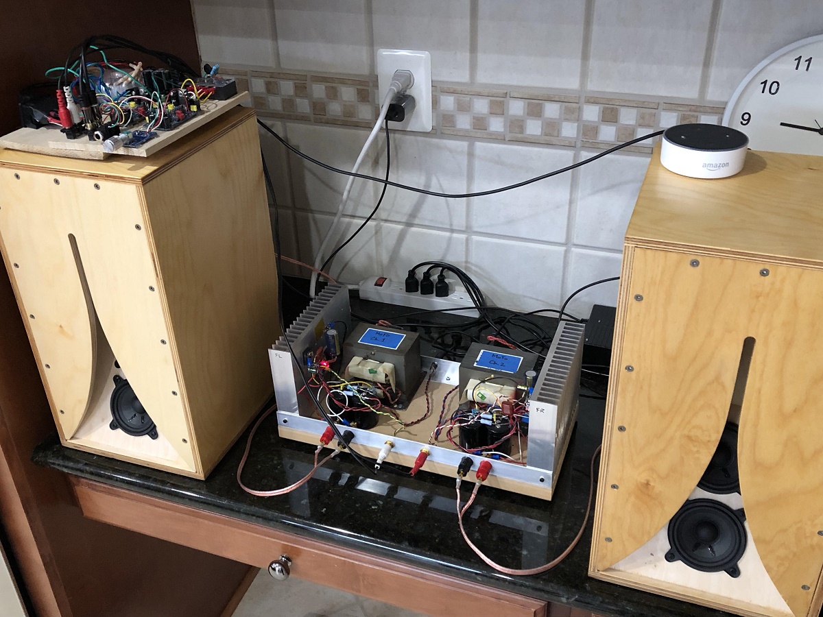

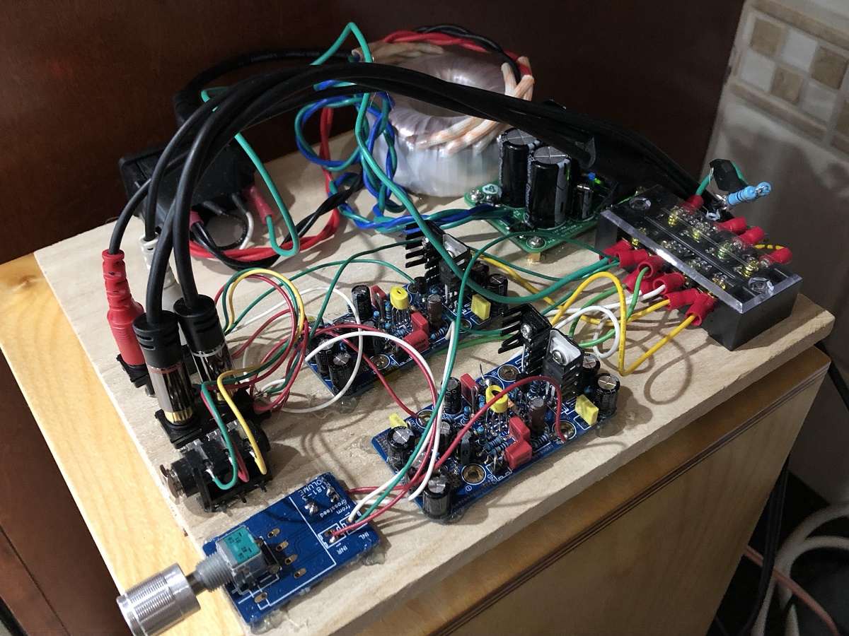

MoFo with Melbourne preamp
I finally connected my MoFo (which has been in storage for over 5 months) to my new Karlsonator speakers (~93dB/2.83v 8ohms). I decided to test my new Melbourne preamp (Aksa Lender with mu-follower output and dual rail supply and DC-coupled output) to drive it. Wow, what a fantastic combo! Sounds heavenly, absolutely stunning resolution and bass authority. No noise hiss or hum whatsoever. Source is Amazon Alexa Dot and works well for a superb kitchen radio.
attachment.php
For Melbourne, I am using a 20VAC 15v toroidal to power a Mark Johnson BJT cap Mx (Prasi SMT layout with TO-220 BJTs and BC850/860's). I only had my nice 2SA1837/2SC4793 Toshiba's on hand for TO-220's, so it is kind of a waste on a cap Mx, but works. Power is very clean and noise free.

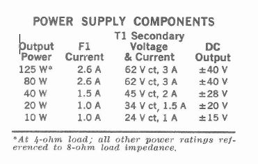

I have a pair of transformers from a pair of SWTP Univeral Tiger ampliers, I am wondering if the transformers can be used as chokes for Mofo amplifiers.
I think they are the 62v versions from the chart. I measured 85v across the + and - outputs of the power supply. Any ideas on if these could work as chokes for a MOFO? Would it work to simply wire these into a Mofo and see if it performs well? If that route is possible would the primary or secondary side be the best side to use?
Thanks, Jim
Thanks Zen mod for the advice, I suppose there may be a market for those Tiger amps, especially working ones. Still trying to be cheap and hoping for a lower cost alternative to the big Hammond chokes.
Since I first enquired, I see that microwave oven transformers may be the among the most readily available low cost chokes. From the last few pages of the forum it looks like MOTs have an inductance of around 60mH and can handle around 9-10 amps. They can handle enough current for the 24v version of the MOFO, but is the inductance enough at 60mH? Does the 24v version of the MOFO need more inductance along with current capacity, or is the larger Hamond 193V choke used just to handle the higher current? Still trying to find a cheaper substitute for $80 Hammond chokes. (and that doesn't count shipping them)
Thanks, Jim.
60mH is 8 Ohms at 21.2Hz.
For any commercial recordings (many low-cut at 50Hz), this is more than ample.
If the inductance were lower, the frequency response would still be "flat" (the MOSFET Source is far under 8 Ohms) but the amount of clean power possible at 20Hz would be lower.
Since few of us have enough cone area to pump audible amounts of 20Hz with the dozen+ Watts of this amplifier, it doesn't matter.
The primary of the larger Tiger PTs may pass 1 Amp DC without overheating, but the inductance will fall way off. The microwave transformers are different because the cheapest (thus only) way to feed a magnetron is a quasi half-wave circuit which puts large DC in the core. The core is "gapped"... not like audio chokes but by laying a thin weld along the non-interleaved laminations.
