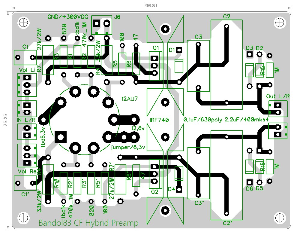

I will try a Bandol83 Pre with 12AU7 + IRF740 as follower, next.

I’m now using the MooseFET which is a SS preamp (by Geek) with a gain of 15dB.
I will soon be building the Bandol83 Hybrid preamp w 6N1P and Mosfet to drive any load.
