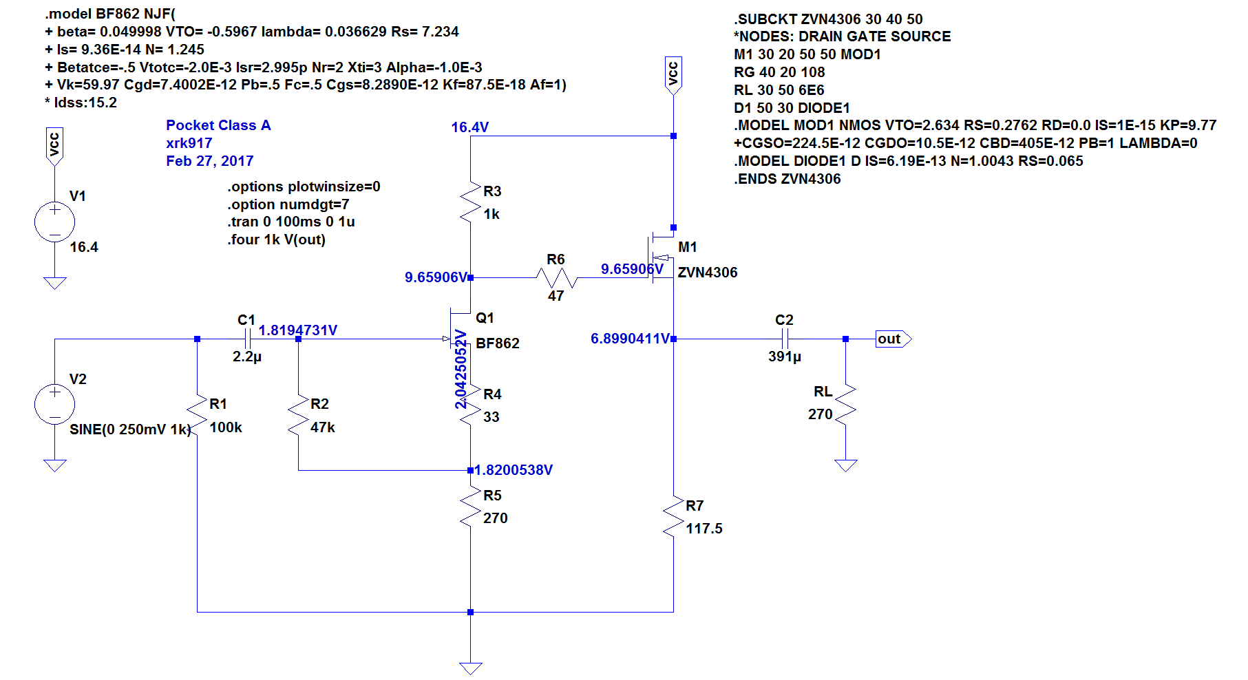

could a jfet preamp stage be added to the MoFo as it is in this amp?

Sure you can, if you are satisfied with what the jfet preamp gives you.

I don't know much about design, but I don't think 16v is enough to swing enough voltage to drive the MoFo properly. Again, I could be wrong.
Yes the Jfet preamp inside the MoFo
If tuned for low gain and suitable current the Jfet preamp can give a good amount of 2nd harmonic pleasant sound

My question is if the BF862 or any other Jfet can drive the low impedance capacitive gate of the IRFP140?
I'm driving a huge Ixys part with a tube. No issues. Capacitance isn't that high with a follower.
The Mofo needs over 15V peak, 30V peak-peak, drive to get all the power you paid for.
The plan you show has a 16V supply, so at a glance it can't make 30Vp-p. You probably need more like 32V-48V or +/-24V supply.
If it is inside the case, there is little need for the M1 buffer. (In fact conceptually the MoFo "is" the same function as the M1 buffer, just bigger and choke-loaded.)
In fact I don't need another buffer but only the jfet imput preamp stage to have some gain. 4x is good for me because 6w are plenty for my98 dB speakers.
I don't need the full swing of the mofo

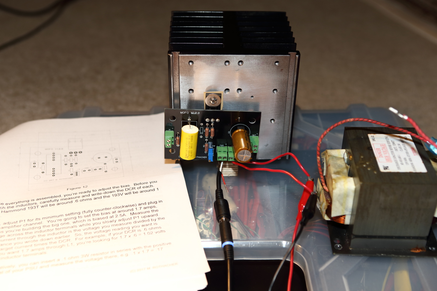

I'm obviously doing something wrong with my MoFo testing, but I am not quite sure what it is, so I'm hoping someone here can provide some insight for me.
I am using the MoFo boards from the store, a 19.5v Dell laptop power supply, and a 5"x5"x5" sink that is sufficient for dissipating about 50w. The output inductor is a mains transformer from a microwave oven - I'm using the primary winding which measures about 0R54 DCR, ~58mH, and is wound with 15ga wire.
Starting up the amp, all goes as expected. Not much voltage across the inductor until I get a few turns on the pot. Voltage across the inductor comes up as I continue to turn the pot. I set the amp to about 2.5A bias (2.5A * 0R54 = 1.35v across inductor terminals) with a 19.5v power supply, so the mosfet is burning off about 48w.
The sink warms up slowly and after an hour measures about 47c (ambient is 21c). The highest temp I can find with the thermocouple probe on my DMM is about 55c on the mosfet mounting screw. Nothing is connected to the input or the output.
After powering down, the amp won't bias up again - the IRFP250 transistor is fried.
Is this just too much power/temperature for the mosfet? Why does it keep frying?
