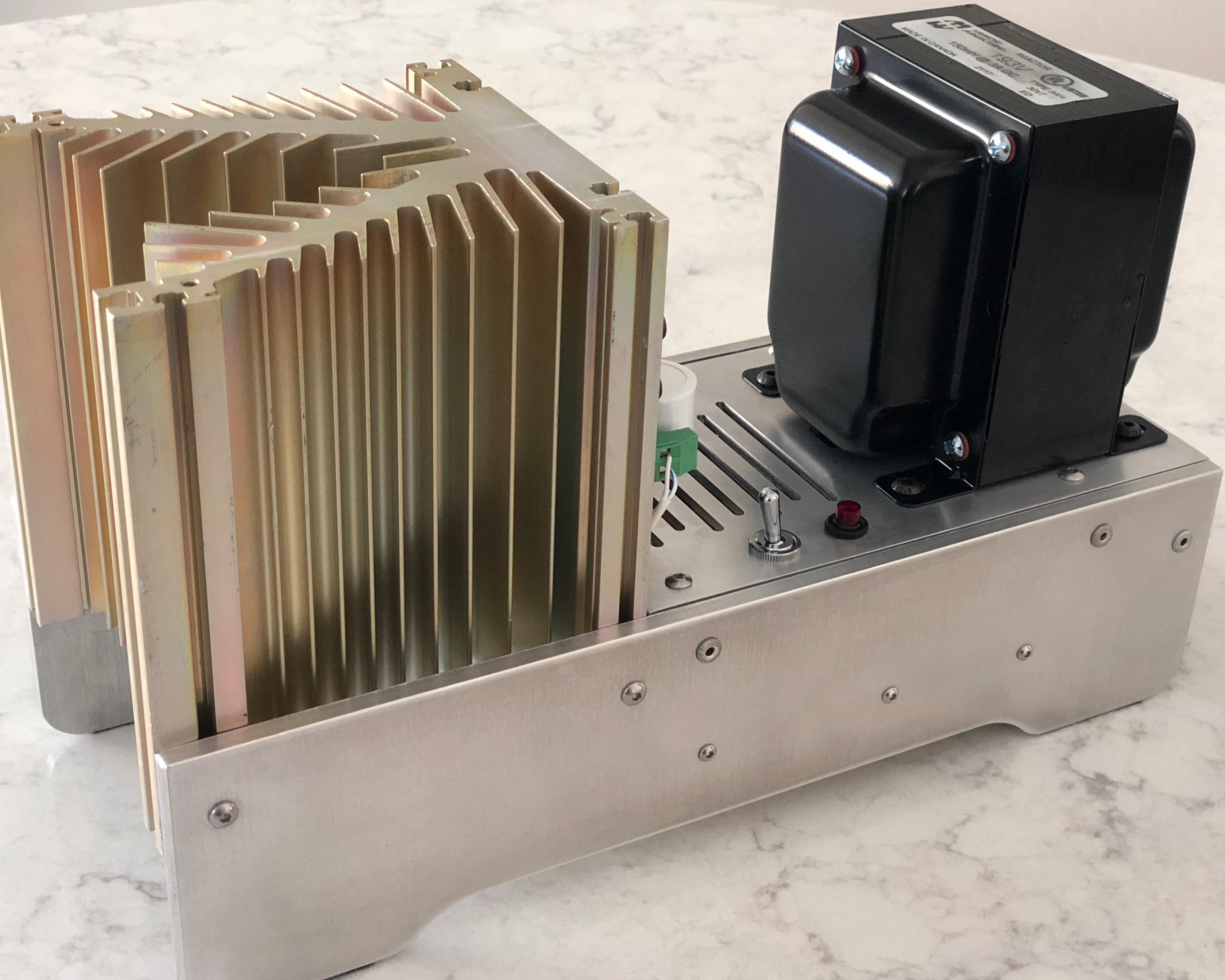

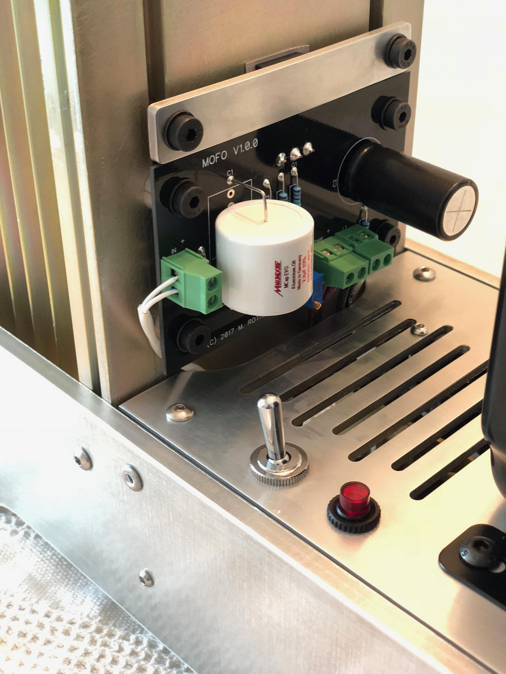

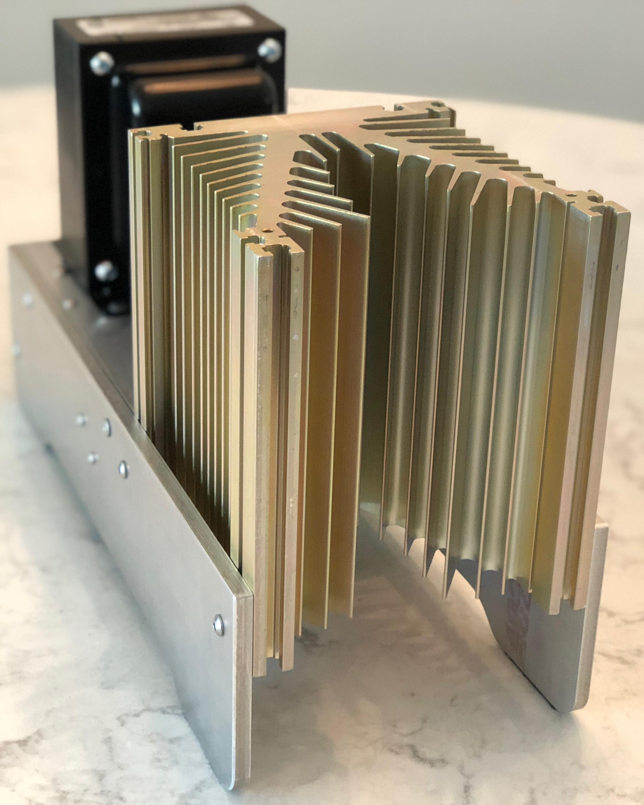

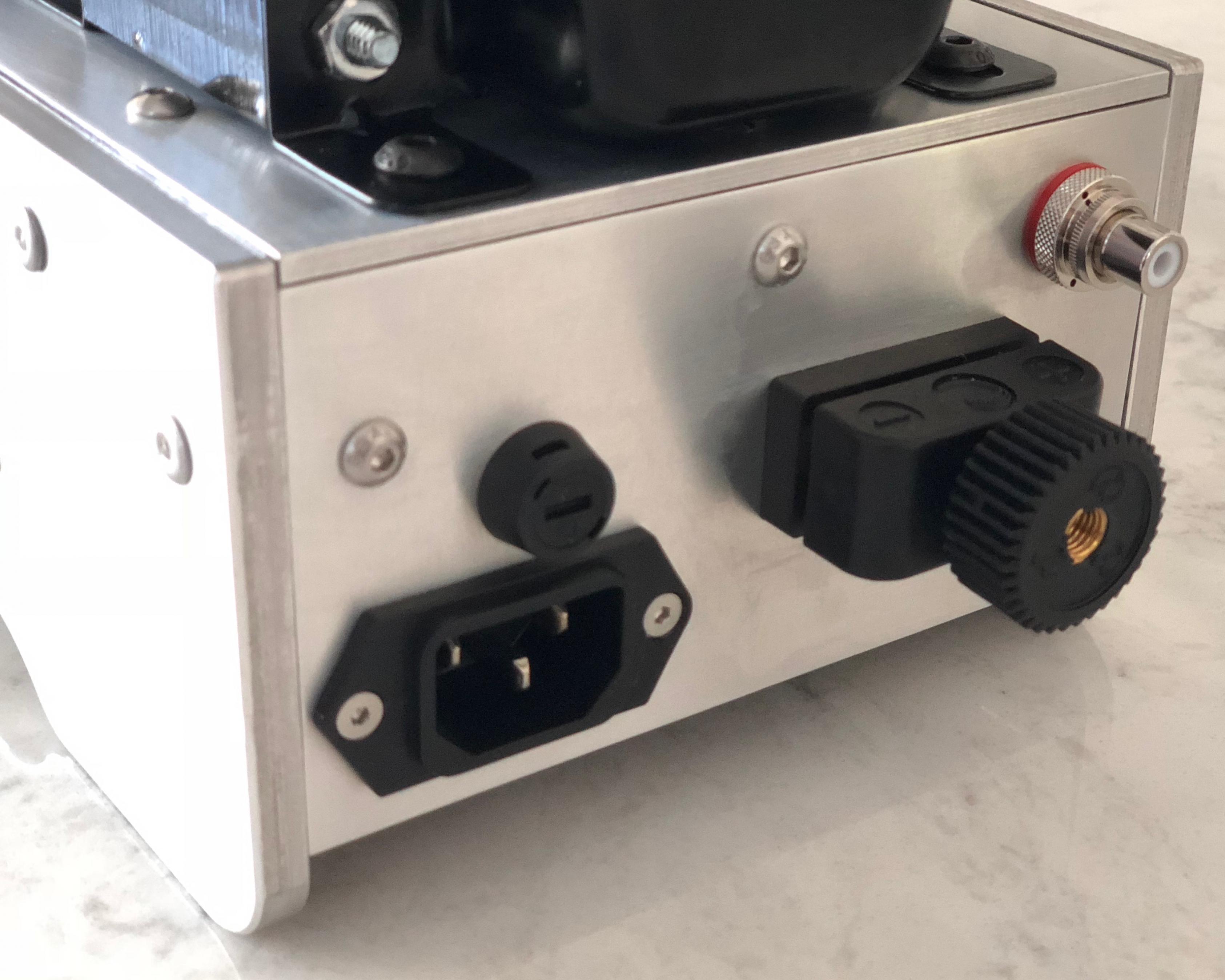

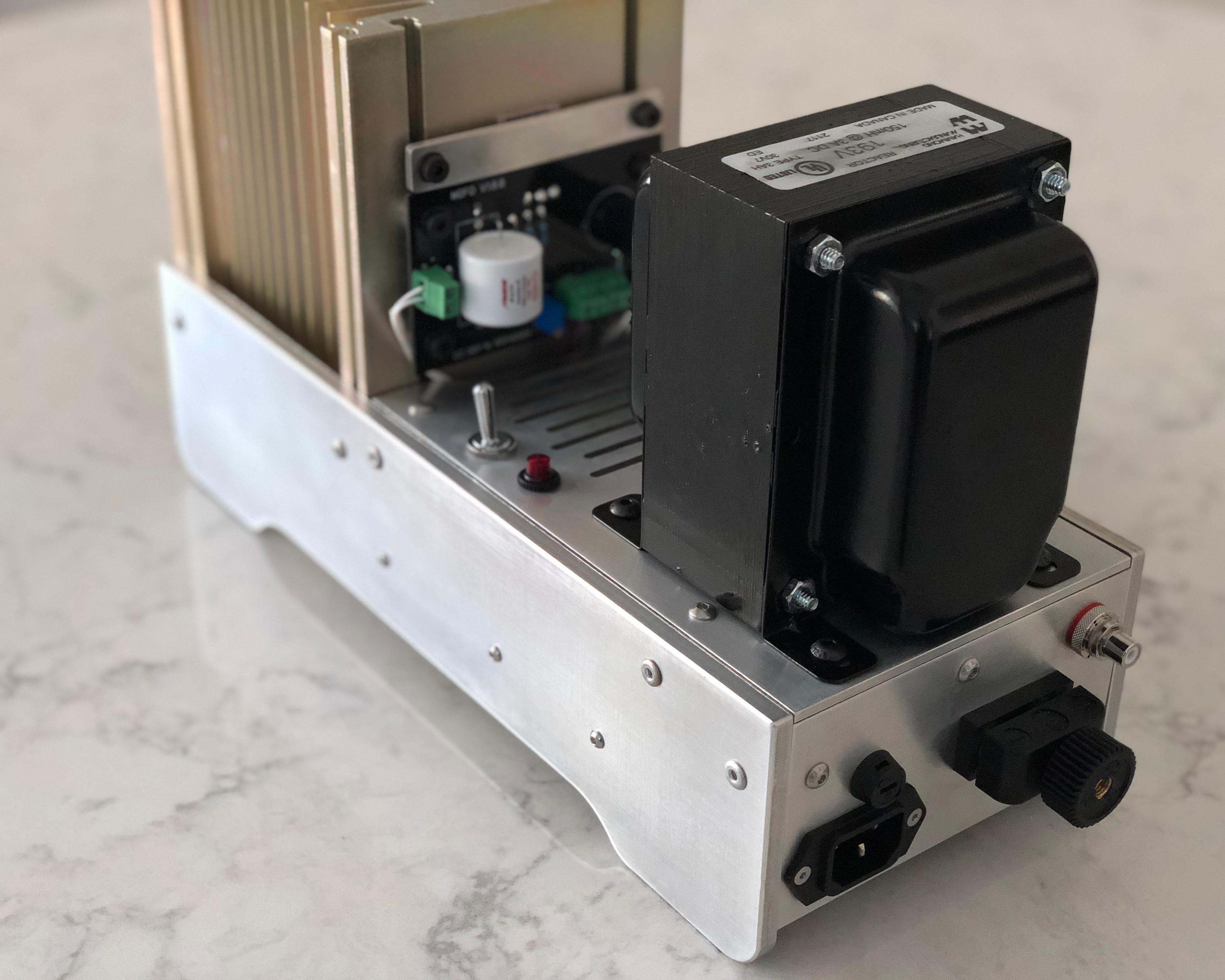

I wanted to share the completed build of one of my Big MoFo channels.
I'm using a 250w 24-26v chassis mount SMPS (VF-S250-24A CUI Inc. | Power Supplies - External/Internal (Off-Board) | DigiKey) and an adjustable single rail capacitance multiplier which I laid out at and has been discussed at http://www.diyaudio.com/forums/soli...sy-capacitance-multiplier-48.html#post5508260. Binding posts are a Cardas CPBP that I got for a "good" deal on eBay. Mundorf MCap EVO aluminum / oil for the input cap.
I designed and machined the case based around a heatsink extrusion with a similar profile to the original one used by Michael. The entire build uses pop rivets, lock nuts, and t-slots to avoid all tapping - I hate tapping... Heat at a 2.5A bias seems to be handled sufficiently, raising to around 51c on the base of the heatsink after a few hours of use. I think it helps that the entire chassis is a mix of 1/8 and 1/4" 6061 aluminum which helps dissipate some of the heat as well.
I've only listened in mono, but even so, I've been super impressed so far. There is a slight mechanical / electrical hum from the SMPS, but none of it seem to be reflected at the speaker output. That said, the mechanical and speaker hum is less than the power transformer / output hum of my M2. I am also surprised by the volume I could get out of my ZRT 2-ways with the MoFo and a Salas DCG3 set with 3x gain. After building this channel's twin, I plan on building the Aksa Lender to get the full voltage swing needed.
I'll post more details and impressions once both channels are completed, but until then, I've attached are some pictures of the finished channel.

Now that is one nice MoFo. Very trim. I like how you used the heatsink as an integral part of the chassis. Really simplified the build

Super clean build! I like the look of the finished project! I've been on the fence about building a pair of these - I so many amp projects that I have all of the parts for and just haven't stated to assemble them yet...

Can I ask you what is the height of your heatsink ?
It is the 300mm length version of the extrusion at http://www.wakefield-vette.com/Portals/0/resources/datasheets/392.pdf. I found one used on eBay for $50. I brought it to a local metal shop and had it sawed in half, so about 150mm high each.
