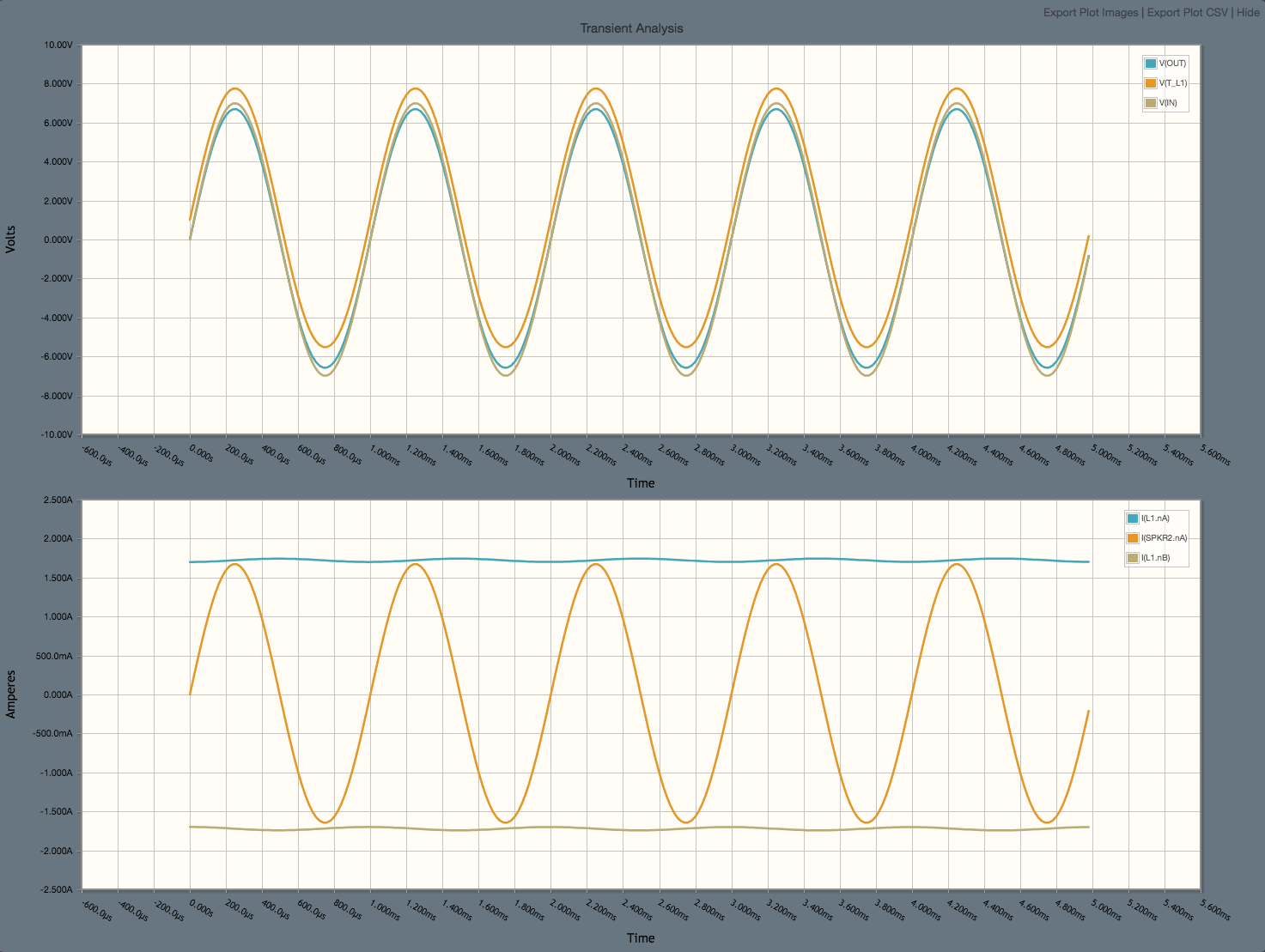

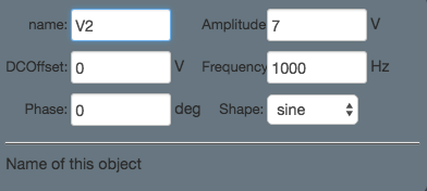

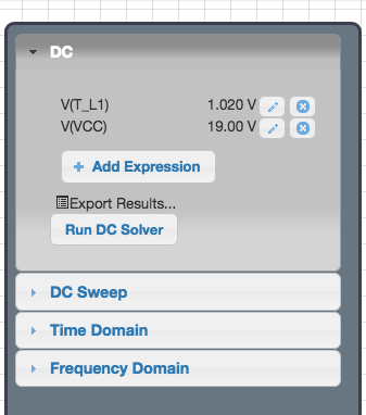

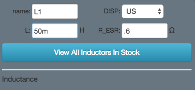

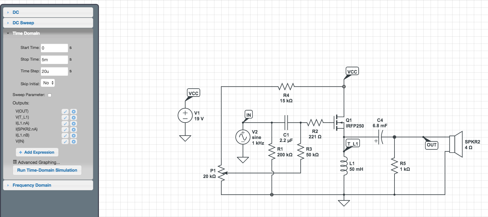

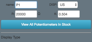

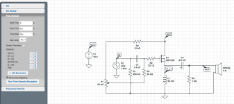

About driving a 4-ohm speaker: IF I'm doing this right, it looks like it's OK with up to 7 volts peak (4.949 RMS).
Is that correct? Or am I missing something?

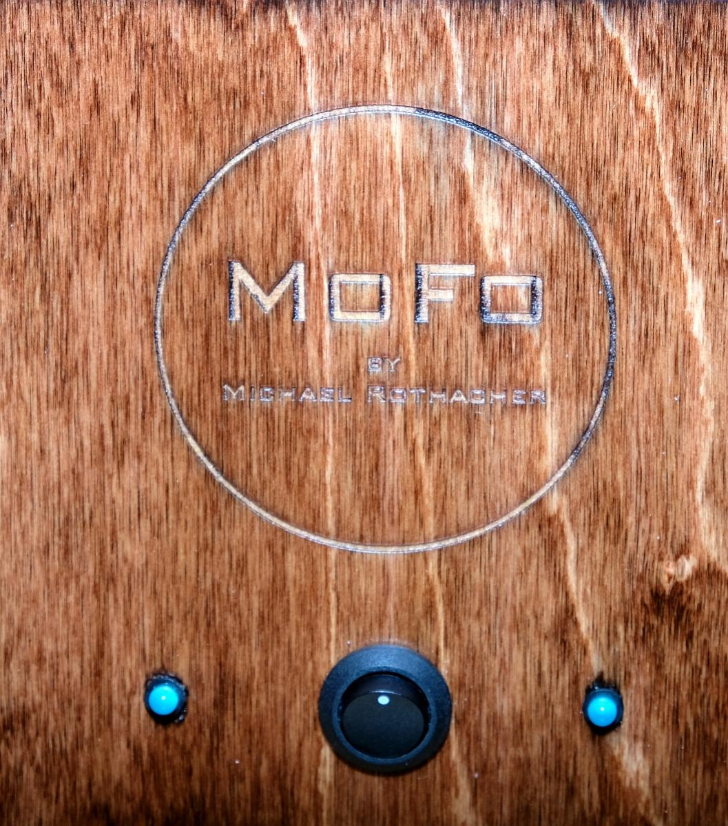

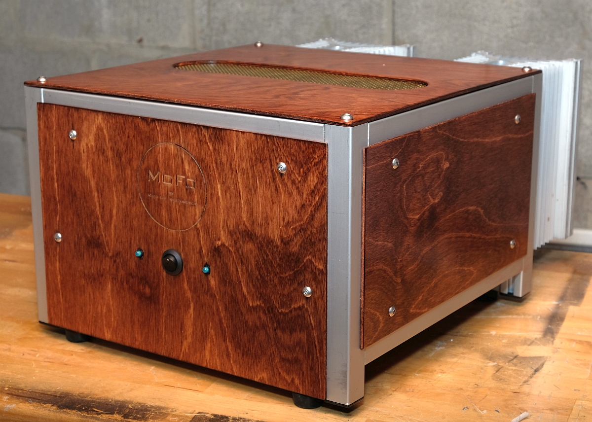

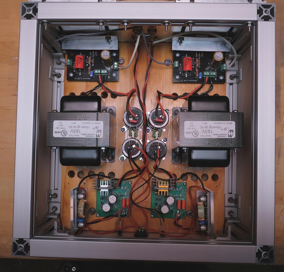

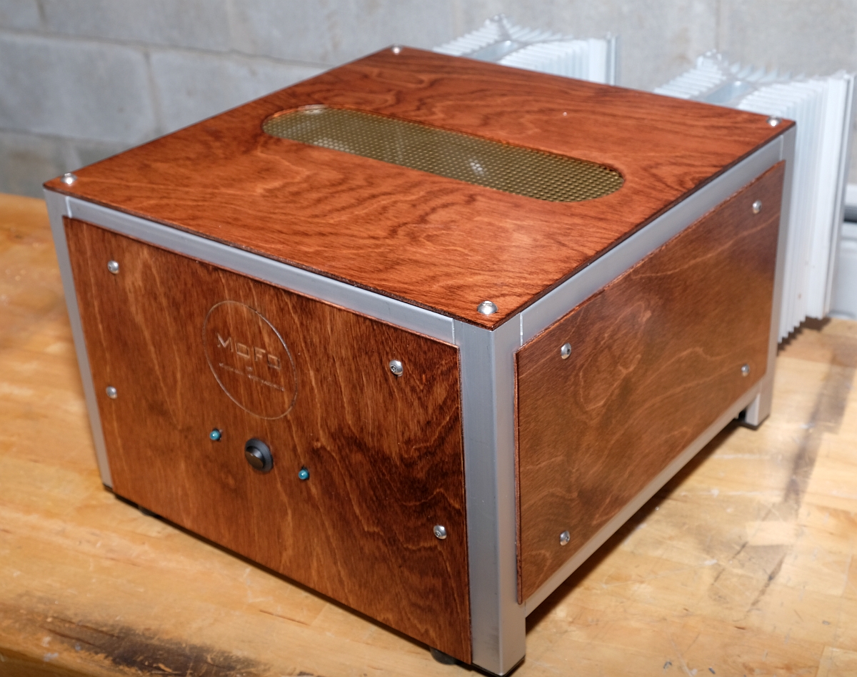

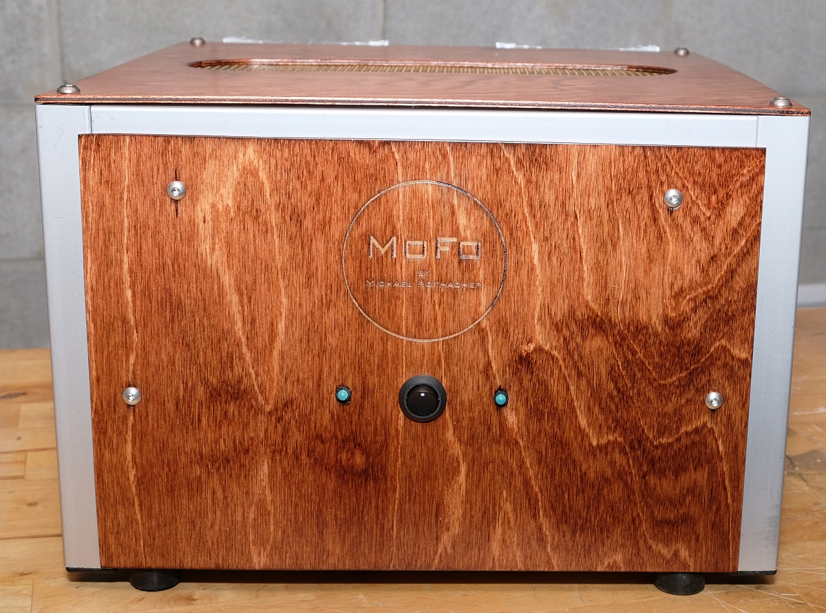

Finished my take on a wife friendly MoFo. So far thumbs up. We shall see. A fun build.
Thanks Michael.
David
