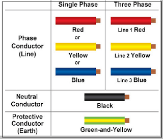

JDG, what about the mains input, I assume it is right side. Three lines. colour code= black red blue ?

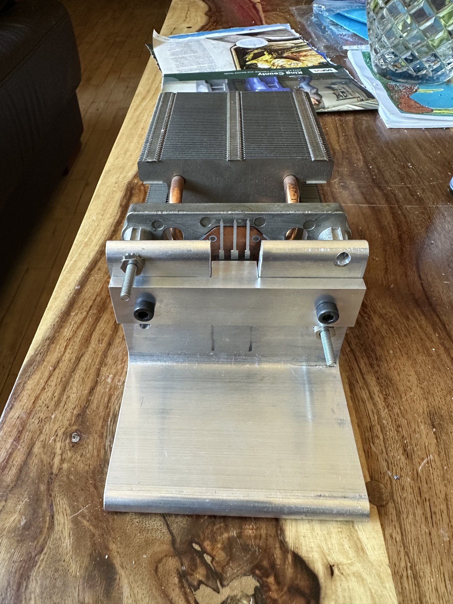

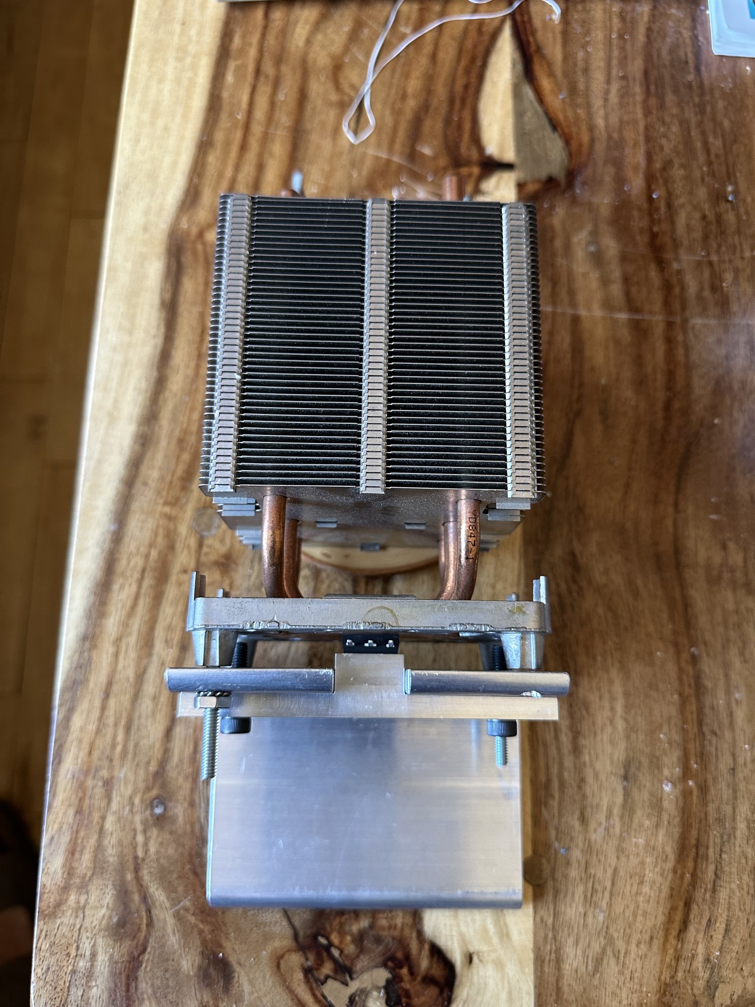

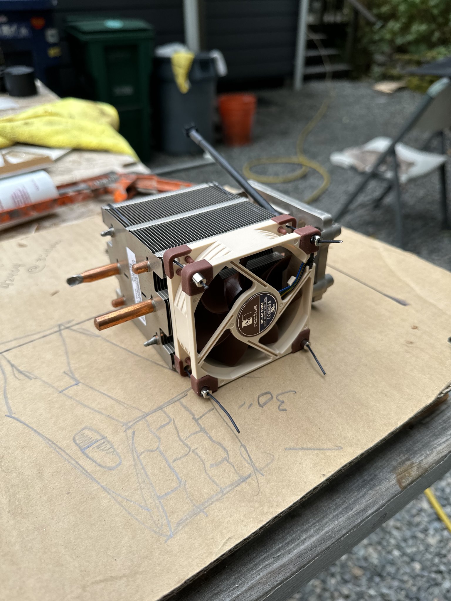

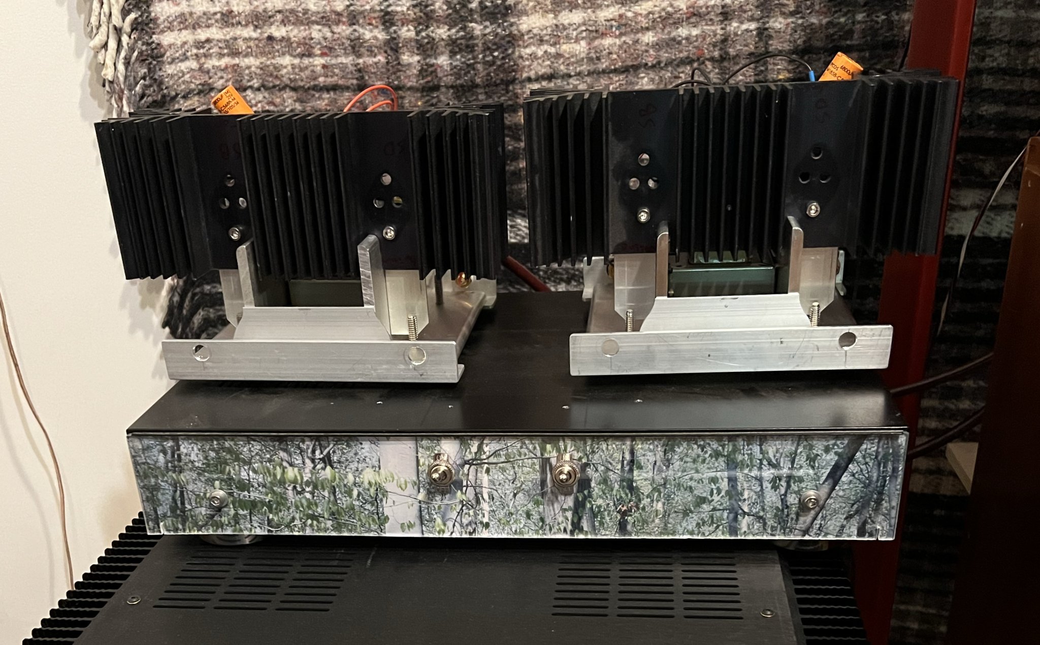

The cpu cooler w/fan works great for cooling class A amps, nice Monk!
I would recommend mounting the fan on the adjacent side, it fits and works better on the flat side of the cooler 😉

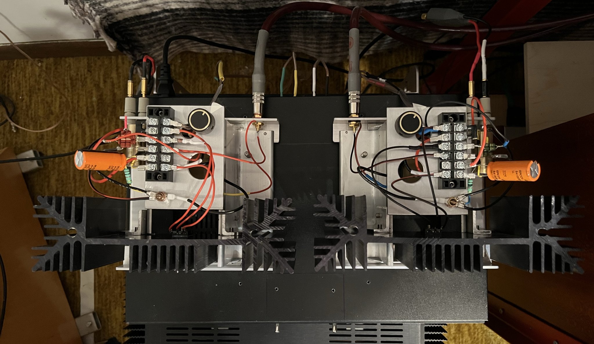

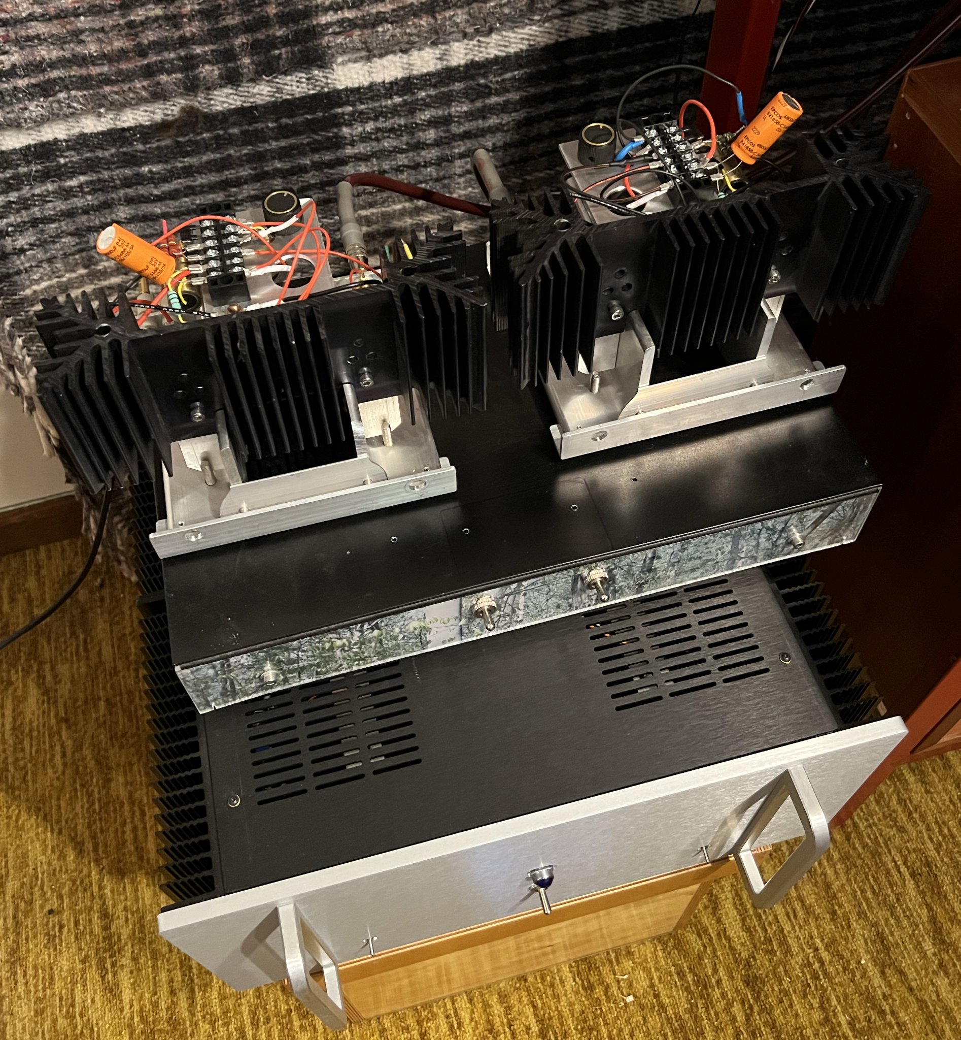

Here is my MoFo from spare parts, P2P, linear supply underneath. I bought the wrong bricks 😛
I am listen to it now, it is biased at 1.18 with Hammond 159ZC chokes, sounding very nice as it warms up.
Thank you all for this opportunity. It is good fun, with a little help from my friends 🙂
Whoa, from the inventor himself! I'm really honored 🙂
I took your advice about extra heat sink, these puppies barely get warm. BIG THANKS!
