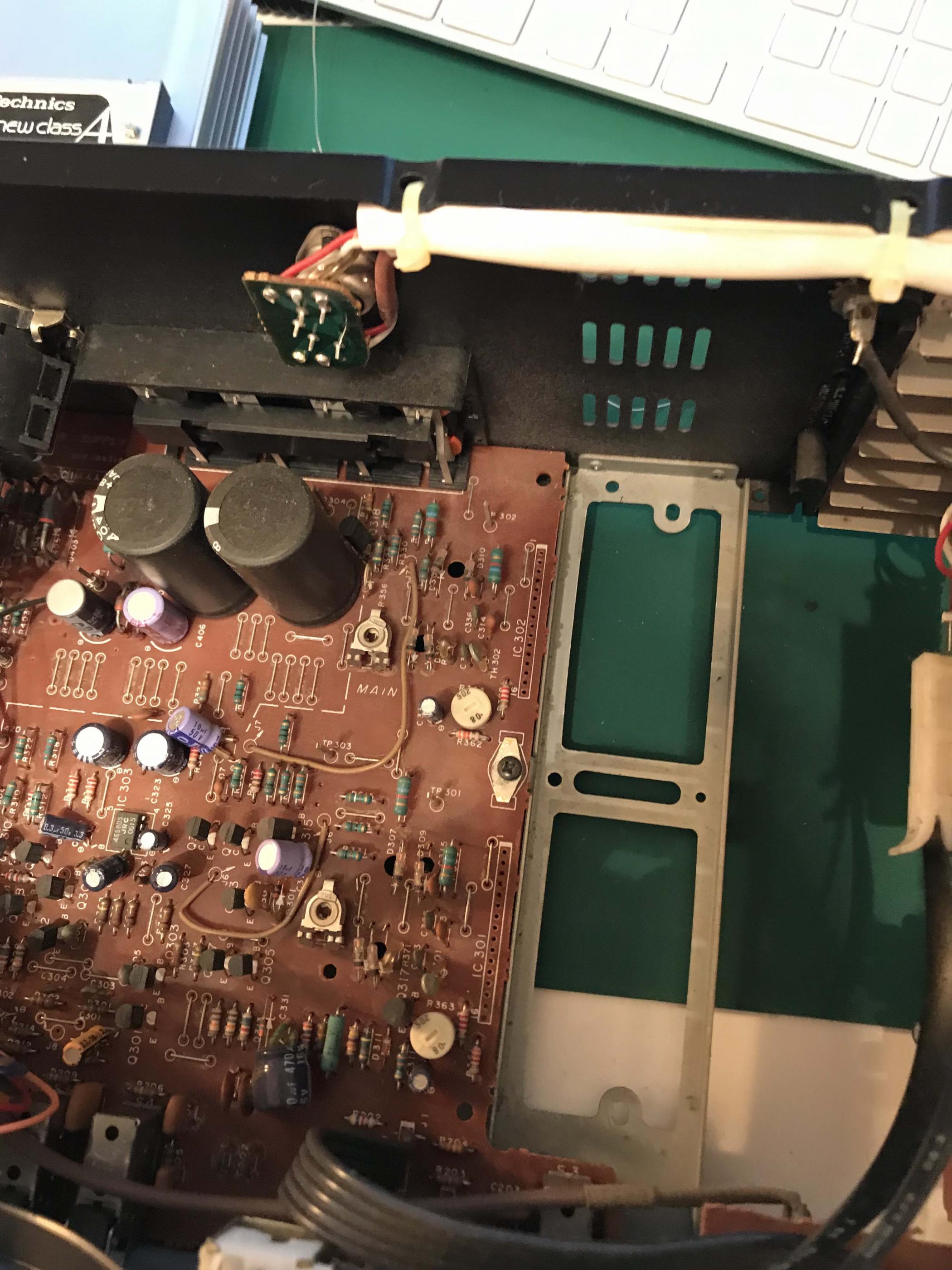

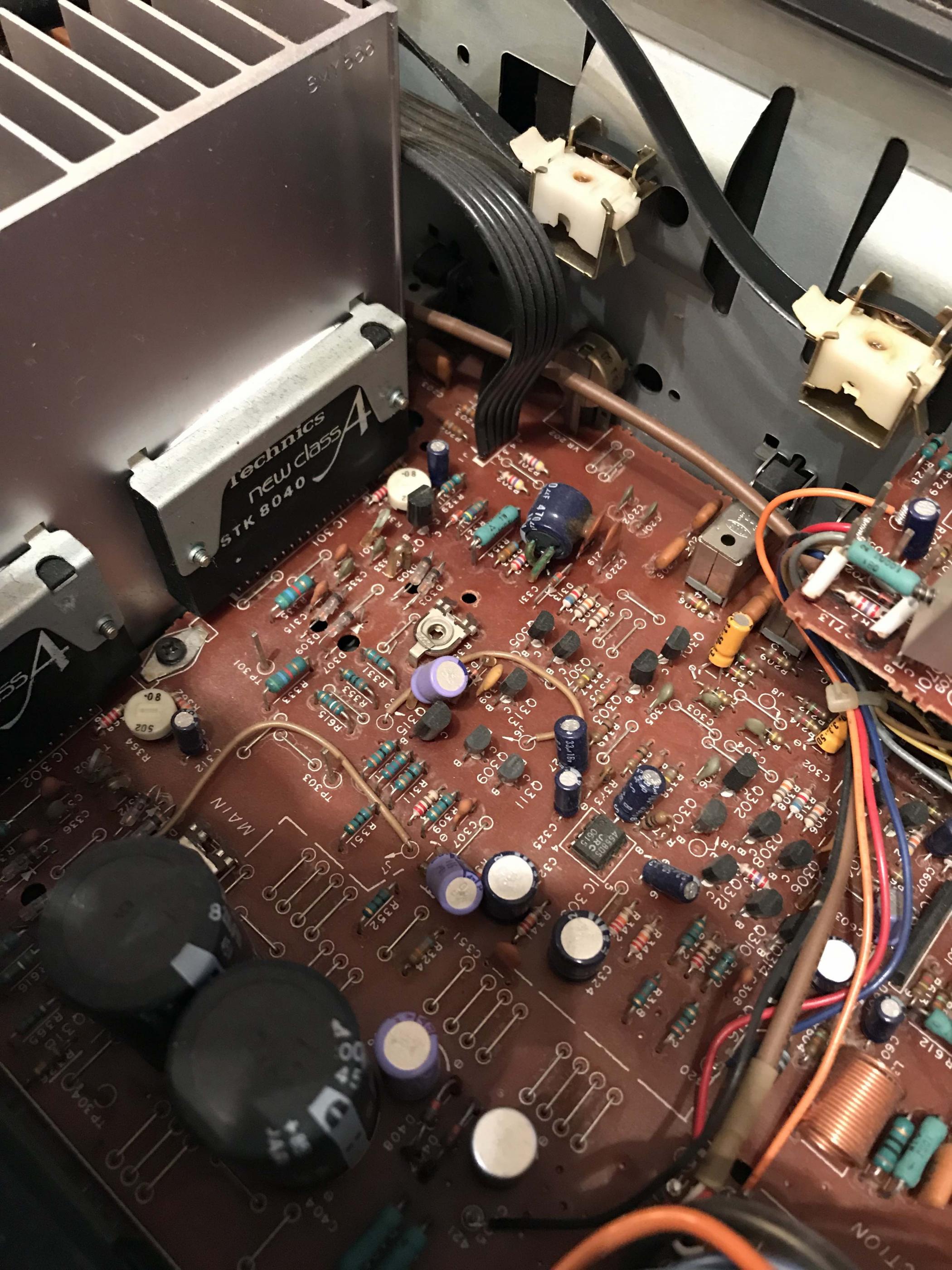

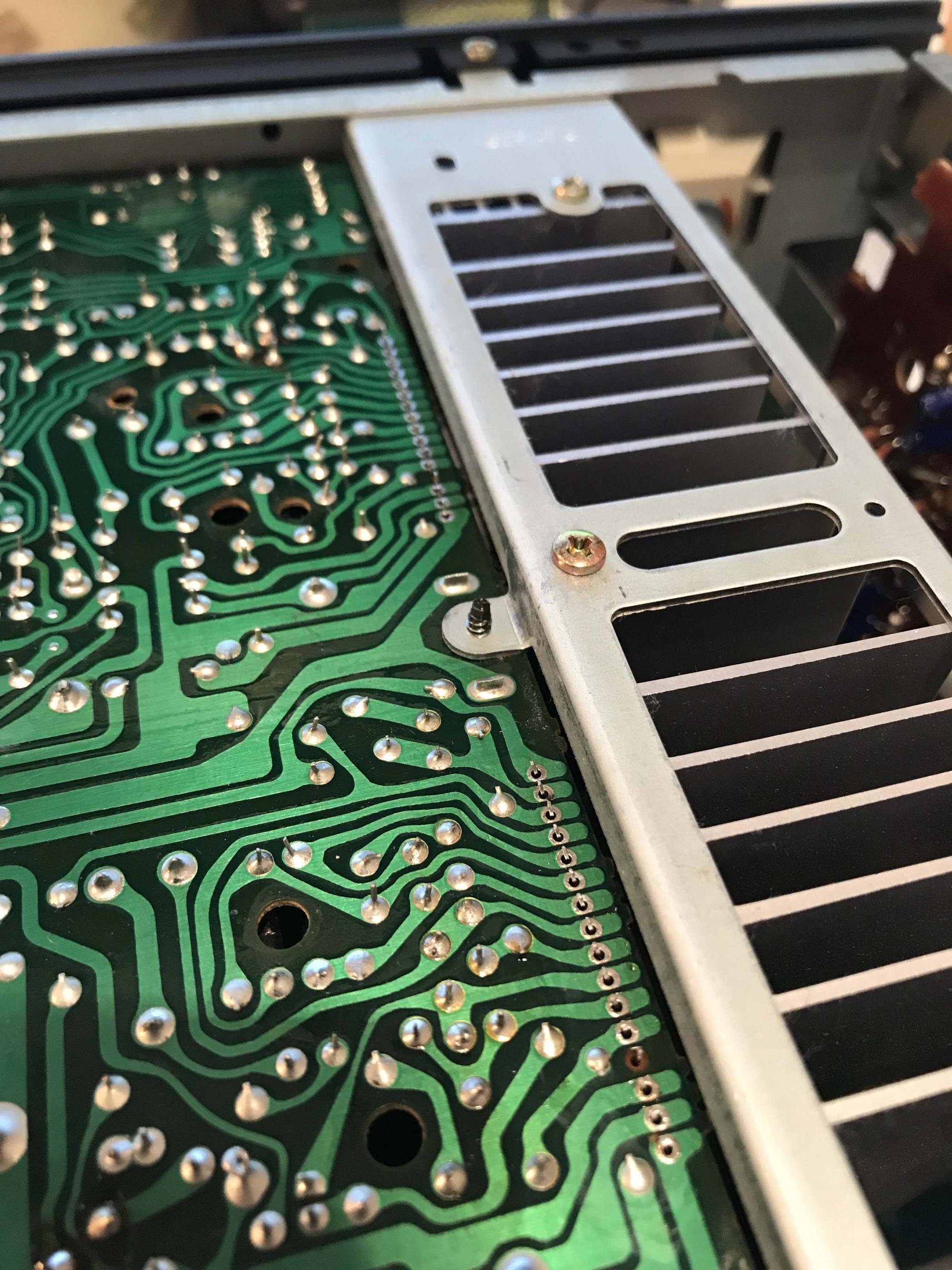

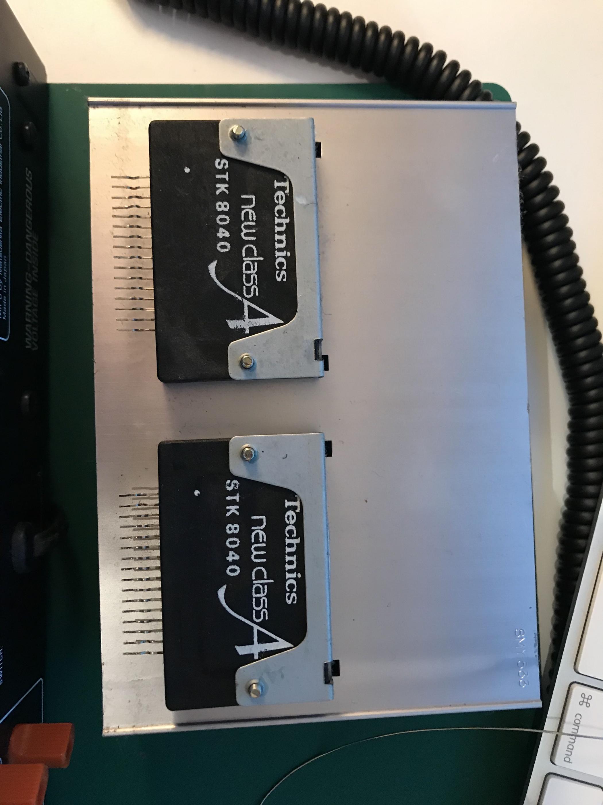

Based on the results and feedback from Depaj, I've decided to replace the STK8040s in my SU-V2 with the remanufactured discrete modules. Only 1 channel is dead, but because these modules inevitably die from heat, I've decided to replace both. I'm also doing a complete recap of the unit. I've attached some pictures of my progress so far.
The replacement modules and mounting plates have been ordered. I'll be making a large Mouser order tonight for all the components and replacement capacitors.
I'm also in the process of identifying all the synchro bias circuitry which will need to be removed. I assume they parts and locations will be similar to the SU-V4, but I'll need to trace and confirm with the service manual.
More to come,
Chris

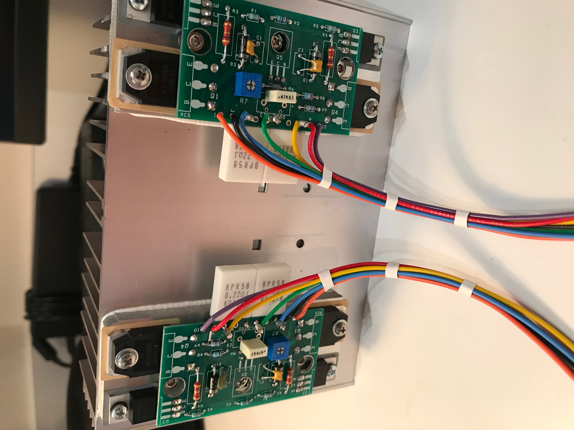

Here is a picture of my completed and mounted modules.

Your pinout is correct.
From what I see the circuit is exactly the same as the SU-V4. You can actually leave the components in there because they don't connect to anything that will be used by the new modules (except R361, R363 and R367) but I find it to be cleaner with them removed and it eliminates the possibility of connecting things wrong (that's just my opinion).
If you want to remove them here's the list for the left channel (R333, R335, C313, C315, R367, R363, R361, R355, R331, C335, C333, D303, D305, D307, D309, TH301, R371).
I don't now how much experience you have with this but I suggest you power the amp up with a dim bulb in case something is wrong.

Going left to right when facing the module (emitter resistor on the bottom side) connect as follows :
  • Left channel : first wire goes to where pin 16 of the stk used to be but you can also connect it to the (-) of C307 that was removed.
  • ... CUT...
  • Finally the last wire goes either to pin 14 or the positive side of where C307 used to be (according to how you connected the first wire).
Correct me if i'm wrong but it seems like you inverted pins 16 and 14 it should be: first wire goes to pin 14 or (-) of C307 and the last wire goes to pin 16 or (+) of C307 ?

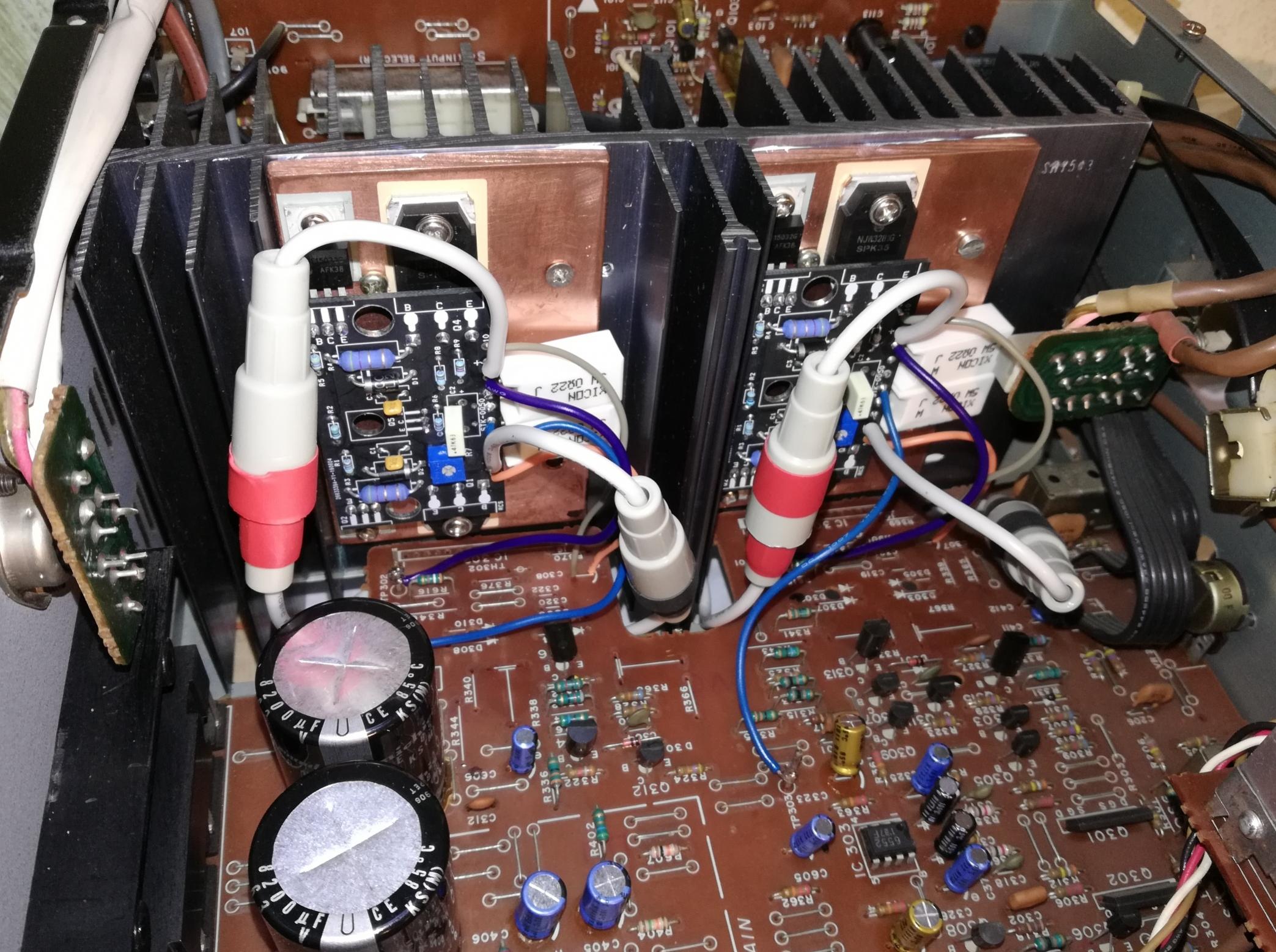

I sorted out the problems, it was an fail in GND connection(screw that connects mainboard to chassis) changed burned resistors everything works fine. BTW for bias regulation i have to turn the resistor completely clock wise for 0mV on emitter resistor ant hen slowly turn counter clock wise till 7,2 mV.
Glad for bringing back to life my old Technics. Thanks for sharing the knowledge.
