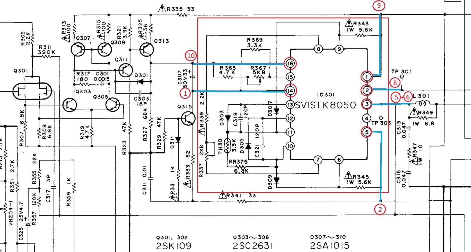

Hey all, this is an amazing thread and I'm in the process of restoring a mint Technics SU-V4. I have read all of the posts here, and the posts over at Audiokarma and am still a little confused. I've built my STK-0050s and installed per the threads, but am undecided about what, if anything, I need to remove from the SU-V4 board. Depaj recommends removing a bunch of components related to the bias circuitry, but I've also seen some posts saying that nothing needs to be removed. Any consensus on what needs to be removed for a SU-V4. Thanks!!
Using STK-0050s in Technics SU-V4, no need to remove any parts from the board, you just connect the STK-0050 to the right pins on the board, you need the extra output emitters resistors connect together.
Thanks. I made my board per the pictures in the thread with the emitters on the pcb at holes 3,5 and 6,8. I then jumpered holes 7,8 together and 3,4,5 together to complete the circuit. I've installed and tested on a dim bulb, but my voltages on the stk pins are way off. Rails are good but i have rail voltage at other pins as well. more likely problem with my stk or with rest of amp?
Please show your board picture(or your STK schematic), it is a little bit hard to read it in the thread.
You connect the STK as below diagram, connect your STK pin number to old IC pin number(pin to pin), your emitters on the pcb at holes 3,5 and 6,8. you join 5,6 and connect to the board old IC pin3(output), STK pin 8 to old IC pin 2, you can count your STK board connected total 6 pins(other pins no need connect them) to the old IC on the board.

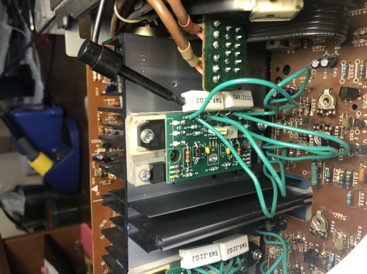

I have recently and successfully restored my SU-V4 using the Canadian modules.
My approach was to remove the minimum of components to isolate redundant circuitry.
Components removed:
Left channel - R343 R345 R365 R369 C307 (either R365 or R369 could remain)
Right channel - R344 R346 R366 R370 C308 (either R366 or R370 could remain)

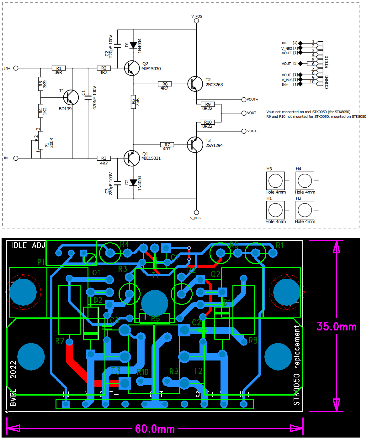

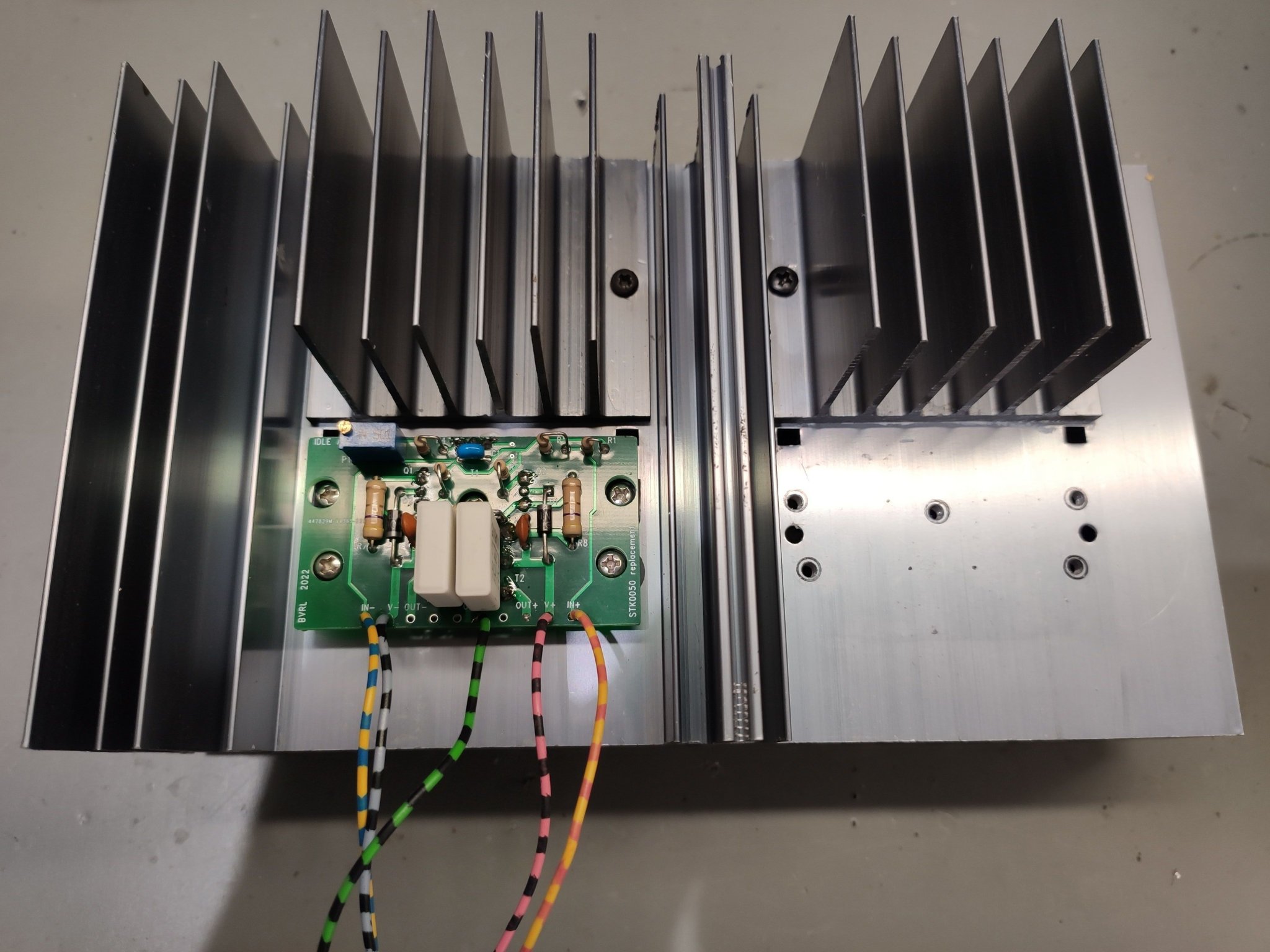

I also successfully restored my SU-V4a, using the given schematic.
But I redesigned the PCB layout.
So here my contribution:
schematic:
PCB-Layout, transistors mounted on the backside, blue= tracks toplayer red=bottom layer
R6 = 75R (placed here two 150R in parallel)
Holes are provided to allow the bolt head and screwdriver to pass through.
Foreseen M3 screw taps...
Used then an empty PCB, and placed dots, where the transistor leads should be bent.
Then fixing the transistors on the heatsink, and placing pcb on top, that was the most tricky part, to get all leads through at once.
First I used TTA004B & TTC004B transistors as predriver, that was not working, it believe the hfe factor wasn't high enough of those transistors.
MJE15030 & MJE15031 works fine, but must be fixed isolated on the heatsink using mica plate.
Final result:
In attachment the gerber file. This layout is more compact.
I spend a lot of hours working on this project, however I'm happy with the result.
Bart
Belgium

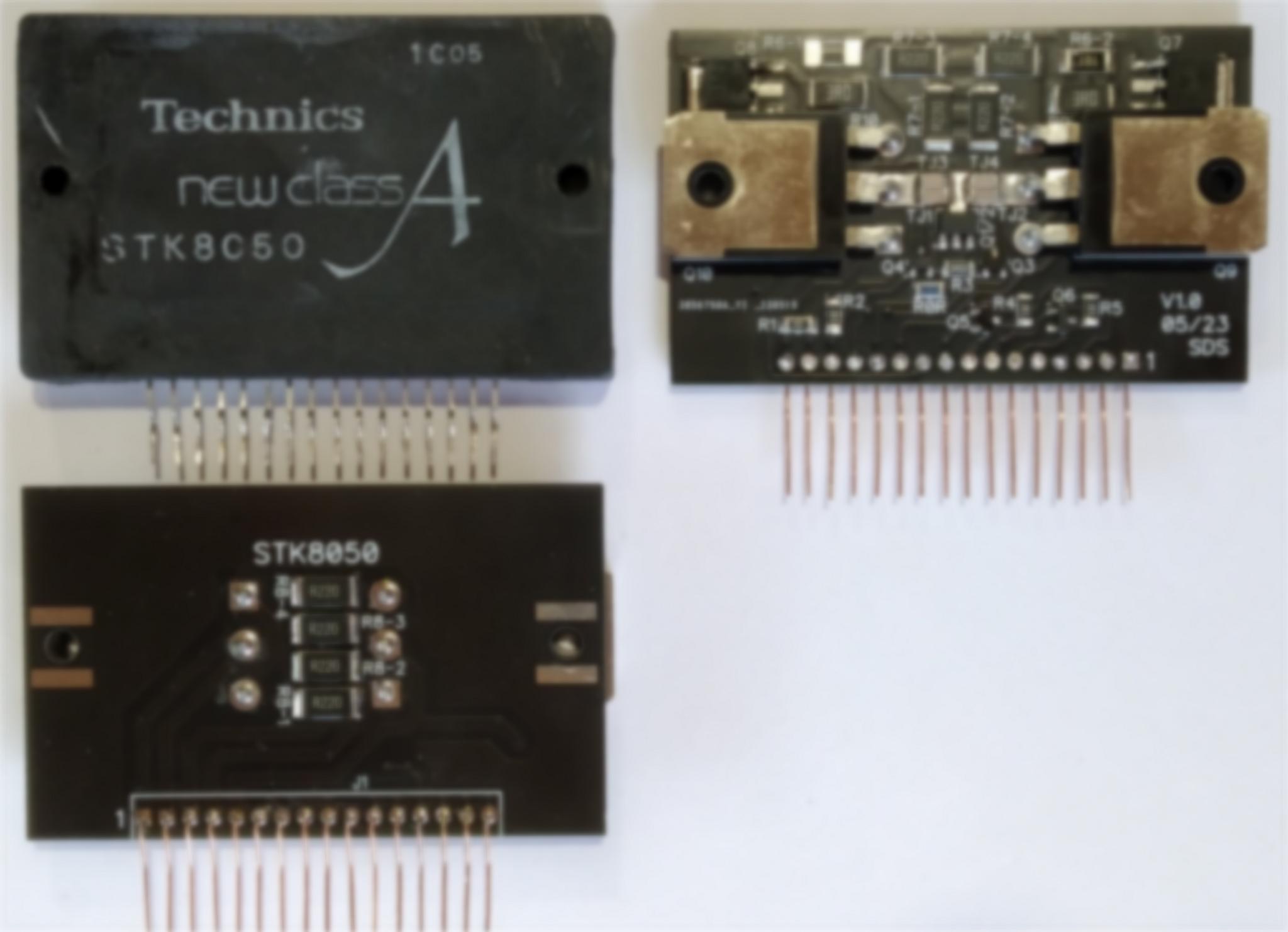

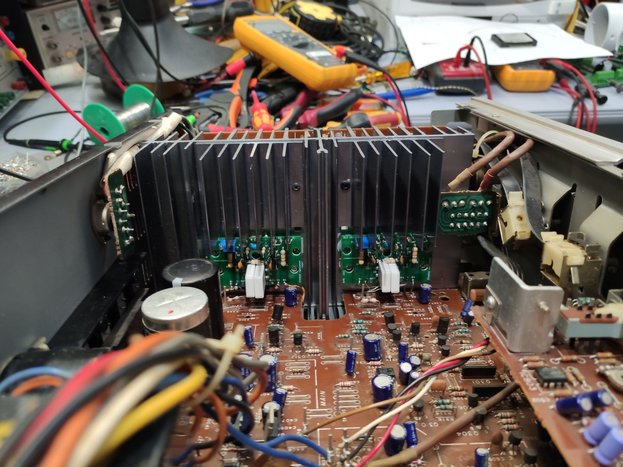

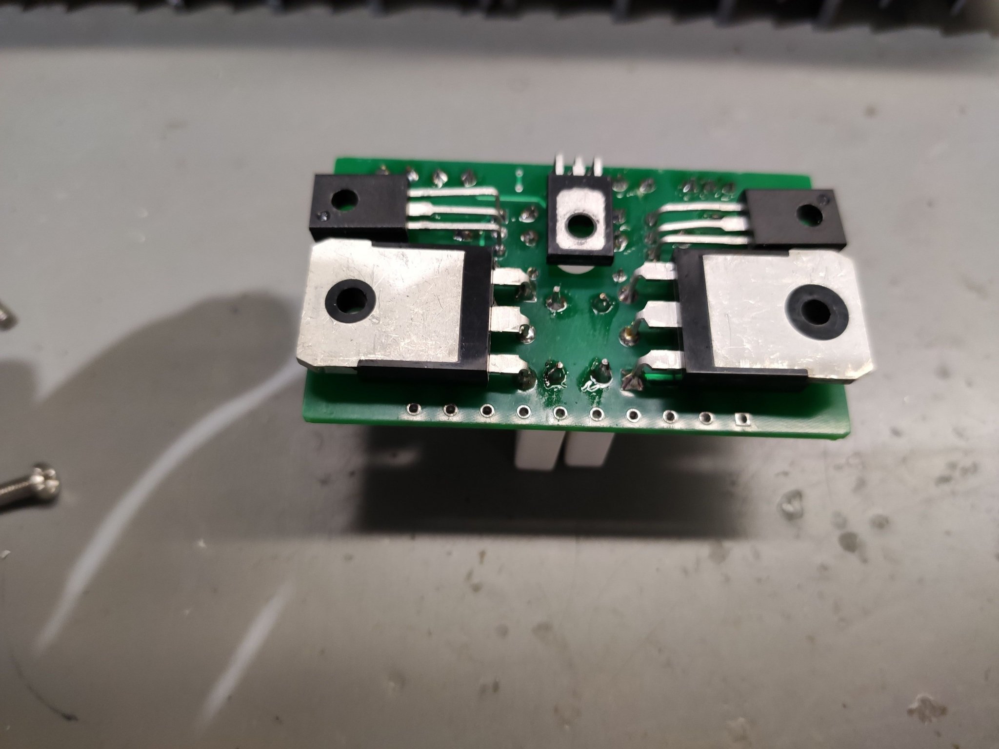

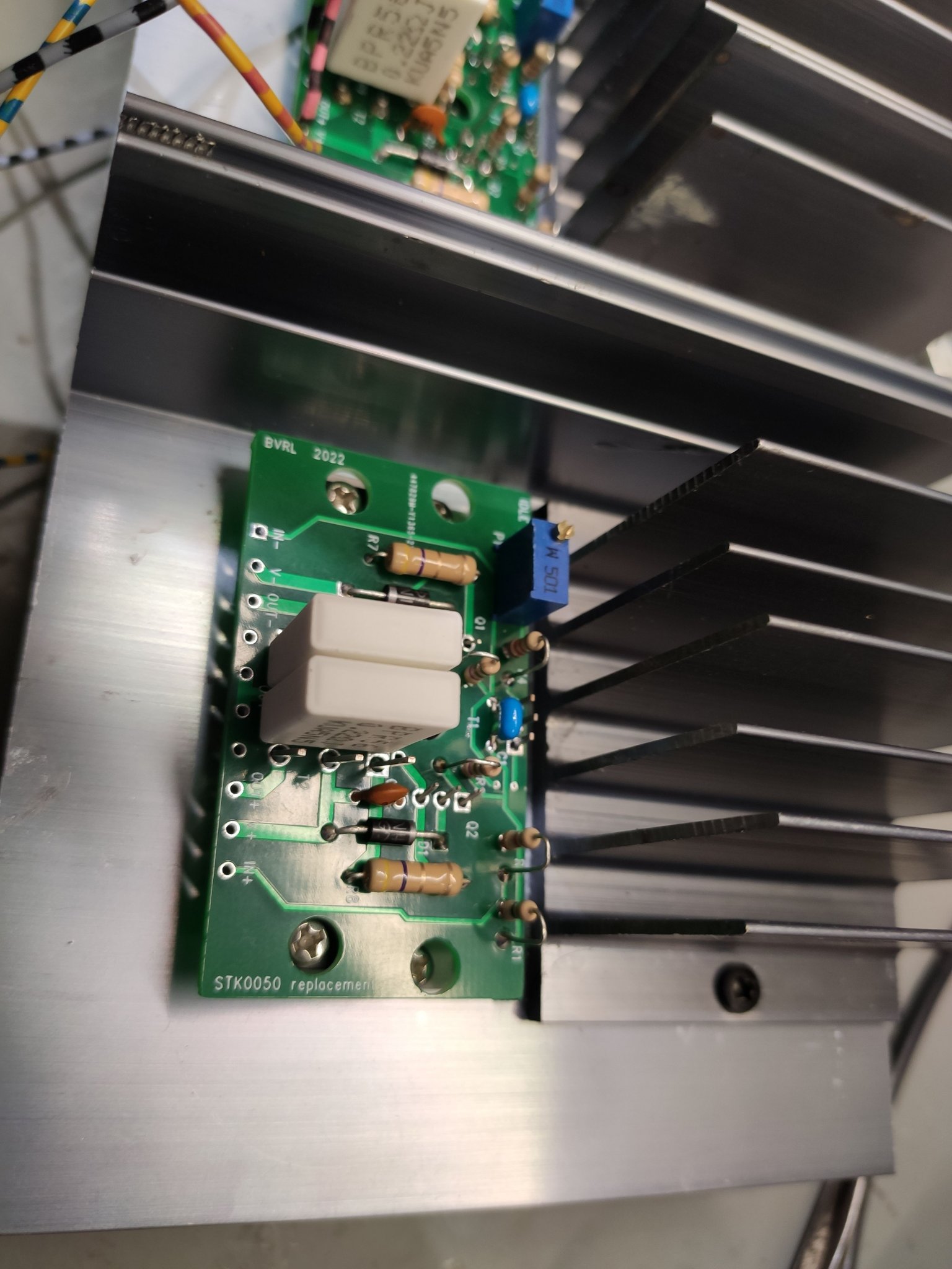

Not entirely satisfied with other DIY solutions found here and on other forums, I've routed my version of the STK8050.
It's almost plug and play:
No extra drilling, needs the output transistors isolating when mounting which is a small annoyance.
Electrically compatible: Although it's necessary to go through the Vclamp and Icq adjustments, the trimmers will set to positions similar to those seen with original hybrids.
Thickness is slightly less than original component, still it can be mounted with the original mounting tab that will bend a little because it rests on the heatsink first.
I have a few spare PCB's.
I have the Gerbers but I'm waiting to sell a few modules to cover the time investment and first PCB / components order before sharing them.

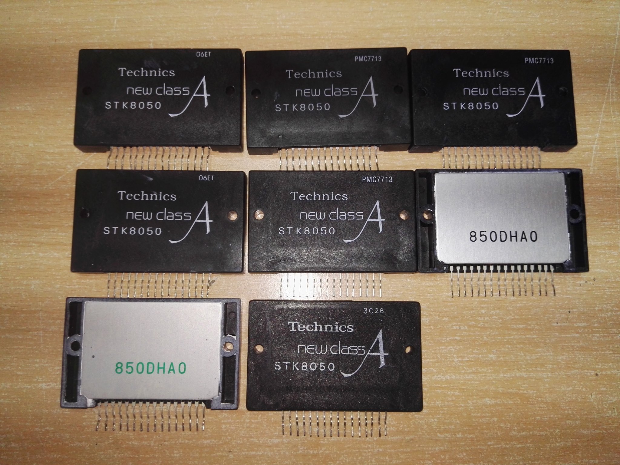

ok grazie, ho ancora un SU-V4 da riparare, 8 pezzi di moduli nuovi che funzionano ma non regolano il clamp e il bias, infatti funzionano ma dopo pochi minuti si apre la protezione perché sono finti.
PS: peccato che le fotografie siano sfocate, aspetto comunque, se i vostri moduli funzionano risolveranno non pochi problemi a molti possessori di questo amplificatore.
Translation said:ok thanks, I still have an SU-V4 to repair, 8 pieces of new modules that work but don't adjust the clamp and bias, in fact they work but after a few minutes the protection opens because they are fake.
PS: it's a shame that the photographs are blurry, I'll wait anyway, if your modules work they will solve quite a few problems for many owners of this amplifier.
