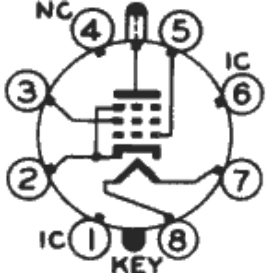

Need some help here.
6LW6 tubes, all NOS.
630V to the plates
140V to screens
6.4V heater voltage measured at the tube
I have to adjust the bias to near 0V before I see any current through the tubes. I figured I’d need a lot of bias, so it’s an 80v supply, and worked fine with 6HJ5 tubes.
Really not understanding what I could be missing here. I can only get one tube per side to conduct at all by turning the bias all the way (up?) and turning the balance pot all the way to one tube.
I thought about something like that. I only ran 3 wires to the tube sockets, plus the plate wire and the two heater wires; pins 2, 3, 5.
I’ll have to check I didn’t get the screen on the wrong pin or something.
Is it possible they have a "secret" internal connection like the 35LR6 tubes that George mentioned? Just throwing that out there. 🙂
The pin 7 thing is documented on the 6LR6 / 35LR6 data sheet as an internal connection (do not use) pin. I have ignored these warnings in the past if I didn't actually see anything connected to the affected pin. In this case SOME 35LR6 tubes (Sylvania I think) do have a connection from pin 7 to the mid tap on the heater. The toasty looking used GE 6LR6's that I had previously tested the amp with had nothing connected to pin 7, so I was quite surprised by the exploding cap until I measured B+ on the heater circuit.
I have seen several different sets of internal guts and two different bulb sizes on the 6LW6 tubes that I have. Pin 6 is connected to the cathode on a Sylvania 6LW6 that I have laying around. It could be connected to something else, or not to anything on another tube. It wouldn't surprise me to find pin 4 connected to an element inside the tube on some tubes, though it goes to nothing in this tube.
In another unfortunate experience, I learned that having the plate supply voltage go away while the screens are powered will instantly vaporize the screen grids as they will try to eat all the plate current. I saw two new Electro Harmonix KT88 flash like old school photographic flash bulbs when I accidentally pulled the banana plug for the plate voltage out of the power supply. They draw very little current at zero bias now.
I managed to get out to the shop for a few minutes and check the wiring, and the socket wiring is all correct. I doubt I have 4 bad tubes, but I guess that’s possible. Nothing has smelled bad or made any noises other than the screen mosfet when I first shorted that, but I didn’t have tubes in at that time.
I may try some more tubes, as I bought 10 of them, but I’m doubtful this is the solution.
I think I figured out the problem. All voltages were checking out fine, nothing fried. Couldn’t be all four tubes I put in were duds. Had to double check what I was actually double checking; has to be something with the screen. I checked things out this morning, and it looks like I may have made a bad diagram - I drew all the wiring changes and the pin out on a piece of Mdf and have been referencing that. I think I connected the screen to an unconnected (thankfully) pin. More to come after work today.

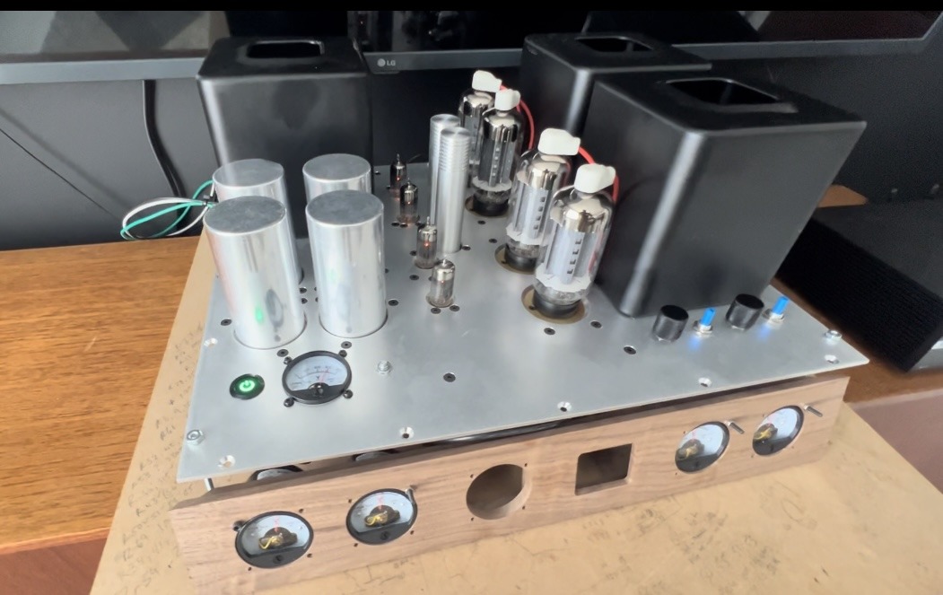

Thanks for the tips, got it working (using that term loosely) last night. I did have the sockets wired incorrectly. Massive 60hz hum on the right channel, left seems to sound good, but hard to tell with all the hum on the right. Driver tubes balanced fine, but 15 more volts on the right channel than the left. Should have some time this weekend to figure that out.
Went for 45mA idle current. Anyone know if the 6LW6 likes a different current?
Horrible hum cause found to be a bad driver tube. I thankfully had one spare. The amp is near silent now. Hooked up to my Yamaha garage speakers and my Eversolo DMP A6 it is sounding extremely good right now! Can’t wait to finish the chassis and get it hooked to the big JBLs.
Reactions: vinylkid58

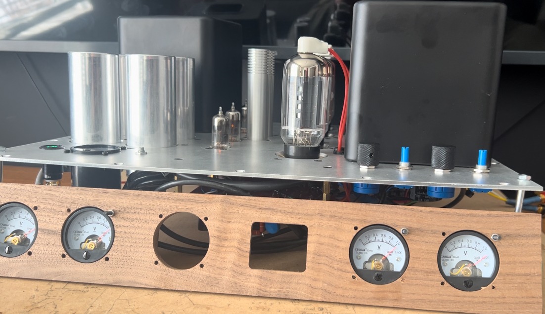

Counter productive, but I couldn’t help myself to take it to my basement and try it out. Absolutely in love with it, although there’s still much work to be done:
-NFB isn’t hooked up yet - that’s getting a pot and a disable switch
-Master volume isn’t wired in yet
-Chassis sides and back need to be finished
-Magic eye VU meter tubes need to be mounted in front panel
-Chassis plate needs to be anodized
-Transformer covers need tops made and need to be secured properly to the chassis

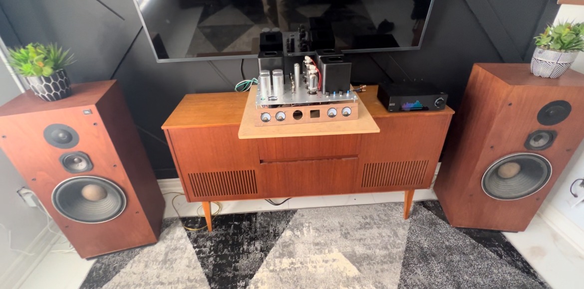

Testing on the big speakers (JBL L100T) went exceptionally well. I did peg the bias meters well past 1V on some heavier bass notes at -16 db input from my music streamer; so I may need 2V meters, or just not worry about it.
Attached are some pictures from the listening session
