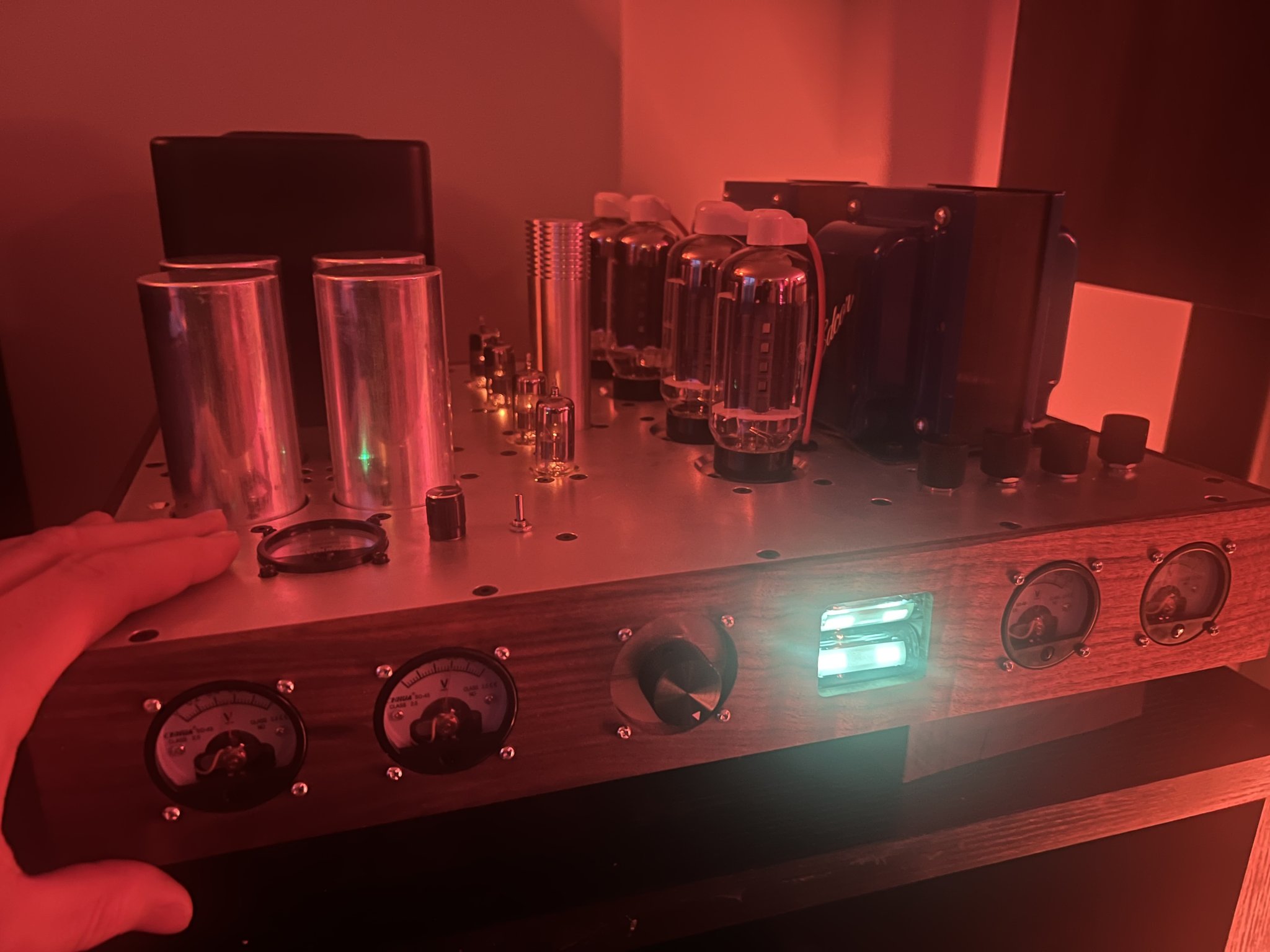

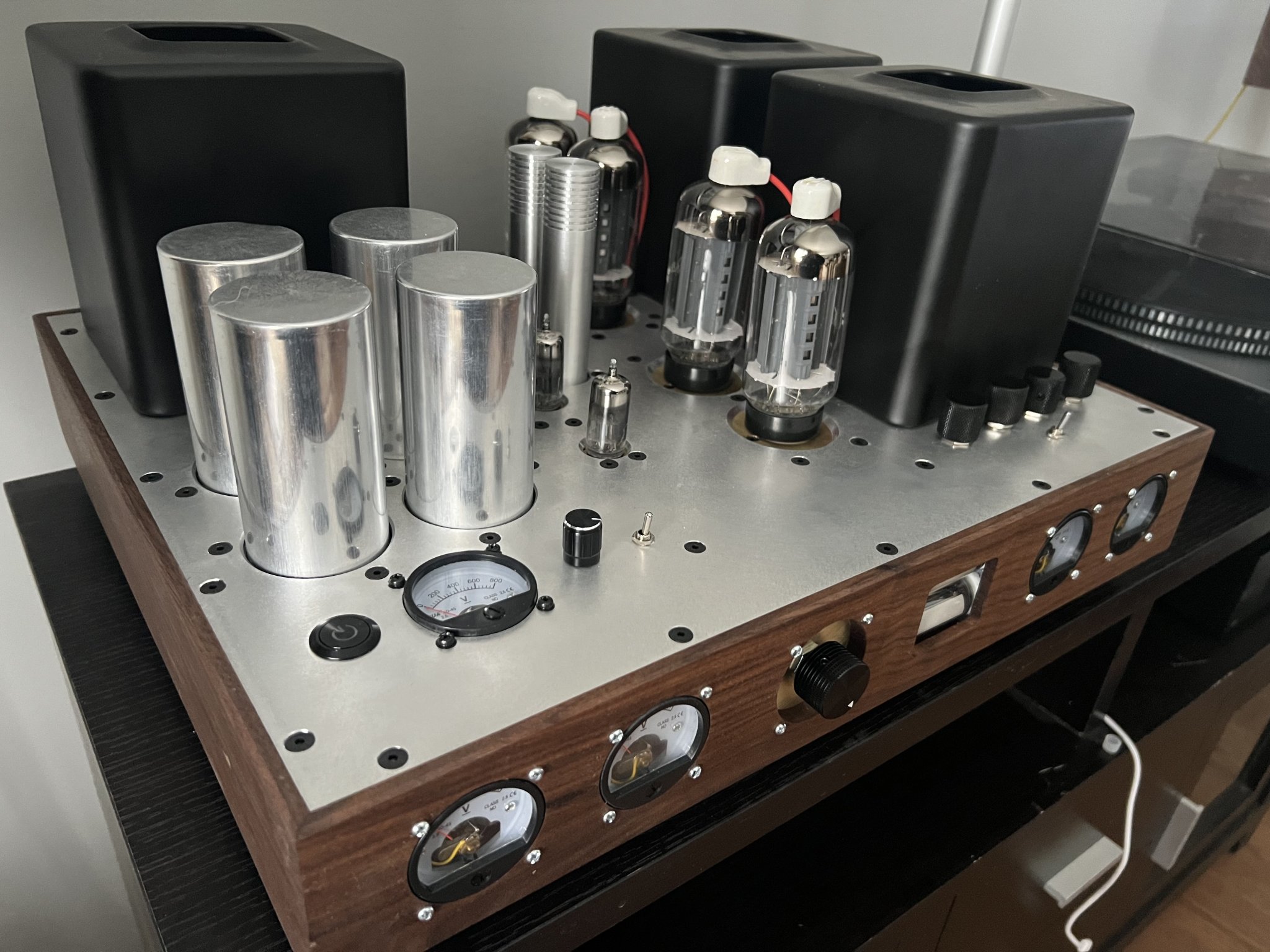

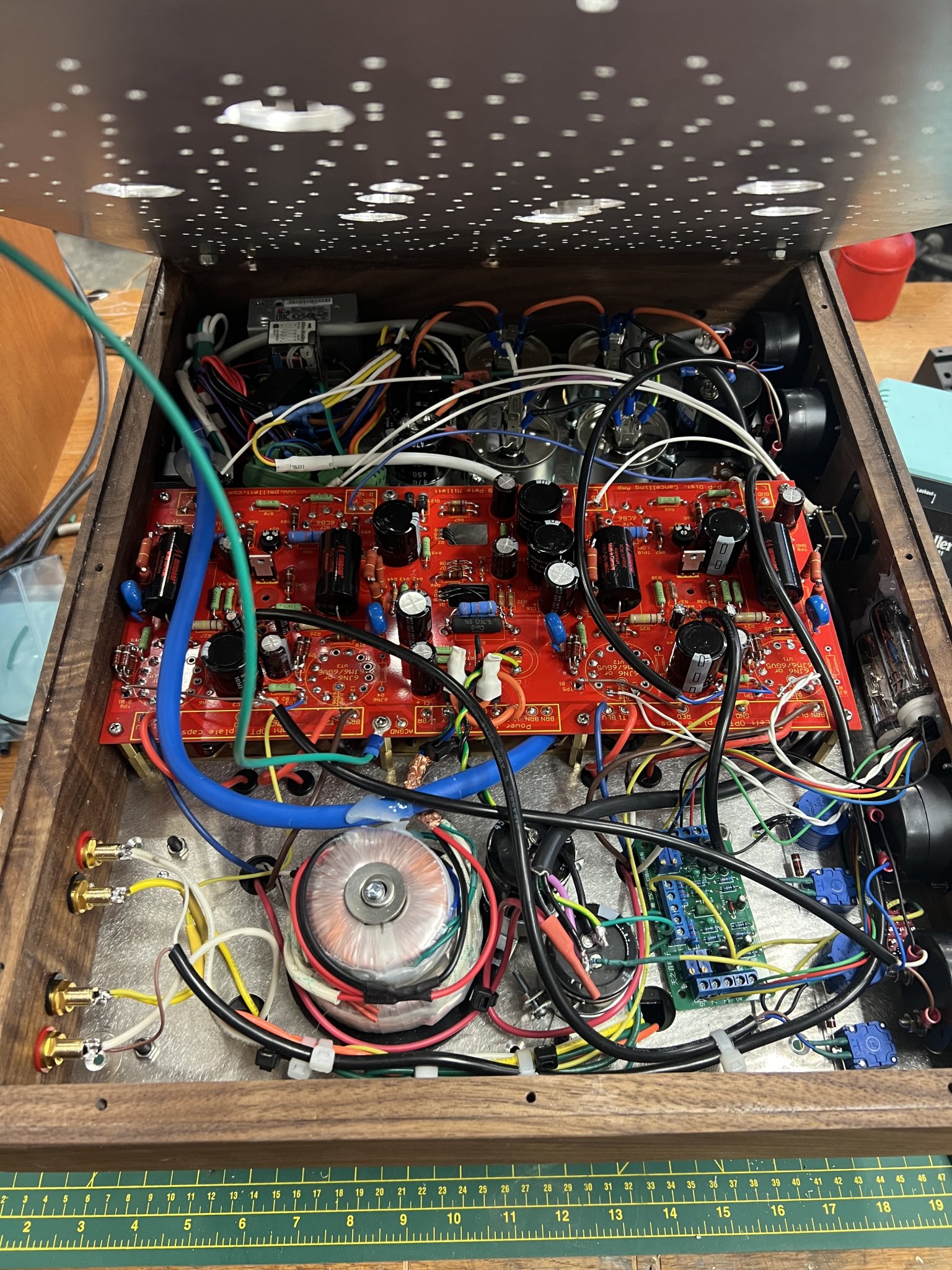

Been travelling for work, so couldn’t work on the amp for a bit, but I’ve been back a few days and I got it mostly finished. Still need to dissemble it to anodize the top plate. Need to finish the transformer covers, and I need to add feet. Thinking about some back lights for the gauges and dimming the power button light as well.
Here’s a quick video of it in operation. Just hooked into my small speakers right now, but they sound pretty nice.
YouTube video
