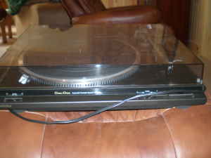

Is there a section on this site to discuss turntables and other sources for music? There is a Technics Turntable on Craigslist, don't know the model number but thought I remember high praise for this brand in the turntable department. It looks to be really clean, might just fit in the area the micromatic vacated but even if it don't, at $75 it looks like a deal.
Duh, here is the link.http://knoxville.craigslist.org/ele/1244085199.html
that looks like a full unit (as in has its own power cord) so if your going to mod this thing you can mount whatever will fit then drop the cables. or you can set it on top your choice.

901Fixer said:Technics Turntable on Craigslist
$75 seems steep. I've not paid more than $10 for similar (and am usually only interested in the head-shell, maybe the arm). You can do a lot better.

I have since found the "Source" section, amazing what you can find if you look. I'll keep an eye out for some of the models I've seen recommended there.
You prefer the belt drive approach, what models would you consider acceptable at the low end of the price range? Do any come to mind that have a smaller footprint than most?
Depth should be doable with most I've seen dimensions listed for but they all might be too wide. I do suppose I could redo the area under the lid as it won't be seen and I am not keeping everything original anyway.

I'm getting better with my search criteria. Turntable or turn table. Brand names etc. Click on electronics or collectible or whatever and it will give you the newly listed items for that day.
I'll definately keep the drivers and the tube amp in this console but am not sure what I will come up with for a source(s). MP3 can be tiny and adding a tuner shouldn't be hard.
901Fixer said:You prefer the belt drive approach, what models would you consider acceptable at the low end of the price range? Do any come to mind that have a smaller footprint than most?
Small footprint -- see if you can talk Stew Nelles (Nanook) out of one of the Connisours i gave him (then make your own, to fit, plinth). You
d also need to scare up a tonearm.
Otherwise i'd be looking for a manual or semi-auto Japanese made CEC table with an S arm and removable headshell. My favorite is the Pioneer PL512/514. I've probably 15 that fit into that category... if you could drive by, i'd be happy to give you one (all need belt & cartridge)

Dave suggested going with a more modern turntable and phono preamp if I wanna actually use this to play 33 vinyl, which I do. I hope this phono preamp can also integrate an MP3 input as well as maybe a tuner that I could fit into the console.
It doesn't have much value in its current condition and is not some rare piece of history so keeping it looking like it does but reconfiguring the internal workings for great sound and easy use-ability is my goal.
