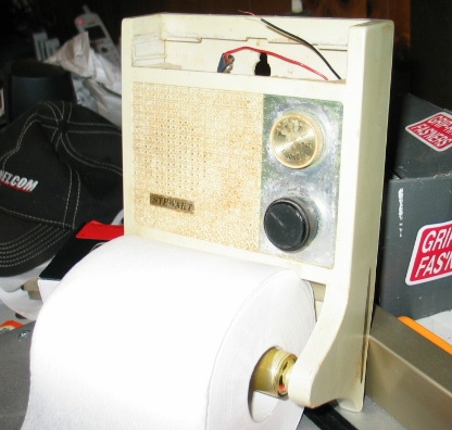

I'm also working on another Hi Fi console for the bathroom. This gem was already installed when I moved in but has a power supply issue I need to fix. You can see where the negative power conduit is missing its connector. I should have this up and running soon.
Well of course you haven't, its very high end. Its a Stewart which we all know is quite rare. It's only AM because I'm not wealthy. Some day I hope to acquire an AM/FM but for now only a dream. If you have the means I highly recommend you pick one up.

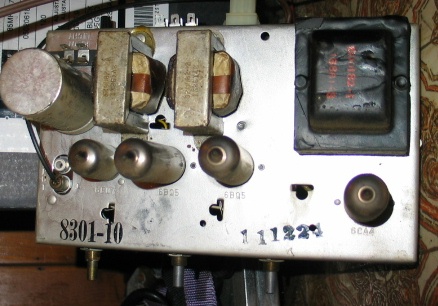

I do not have the equipment to do an impedence sweep, I don't think anyway, what is needed? I'll get a pic of the amp and tubes. Any idea what year this thing is? What would you need to see to tell? Camera charging.
901Fixer said:I do not have the equipment to do an impedence sweep, I don't think anyway, what is needed?
A computer, a jig, and WInISD? (i use fuzzmeasure on the Mac) or manually, a signal gen (i always used free sw), a couple resistors (same ones you'd use in the computer jig), a voltmeter and an amp. You can likely get away with a signal gen & a voltmeter if all you need to figure is Fs (which is sufficient here)
A number of ways. A patent plate (usually built 1 year after the highest year). Date codes on the tubes or speakers (what are the numbers on the speakers?). Kinds of tubes in the amp. Mono or stereo.

The numbers on the speakers are:
4" - 584028
137207
8" - 581001
137152
Maybe Bacon665 has this equipment as I only have a multimeter from that list.
The tubes are:
6EU7 - Magnavox Made in USA
6BQ5 - Magnavox Made in Japan
6CA4 - Magnavox Made in USA
Thats all they have on them.
No patent plate anywhere I can find but there is a wiring diagram.

6bq5 are not original (i'd guess). 1 or 2 output transformers? 6EU7 could be voltage amp + phase splitter in a PP or could be 2 gain stages in an SE.
There are no other tubes? Is the tuner SS?
dave
Is CTS a brand of speaker? Is Alnico a brand or type of speaker?
There is no tuner, only the turntable. This thing is small, 39" wide x 17" deep x 26" tall.
The 2- 6BQ5 tubes fit into sockets marked "6BQ5" in the case.
There two smaller transformers, one larger (painted black) transformer, 4 tubes, and a capacitor. Thats all there is on the surface of the amplifier.

2 output transformers, stereo, SEP amplifier... that amp is screaming out to become an RH84.... i've never seen one without a tuner, that is novel.
