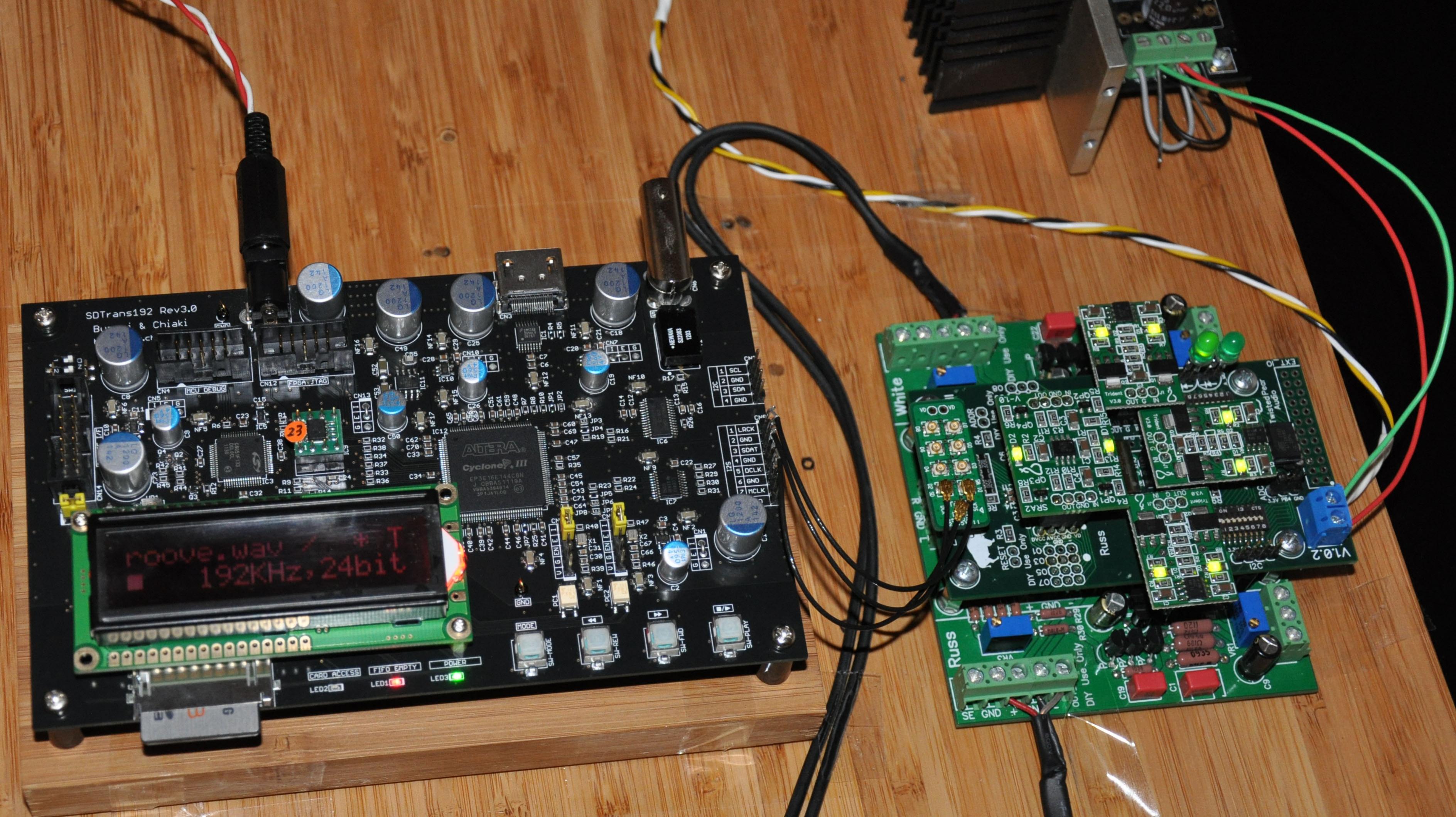

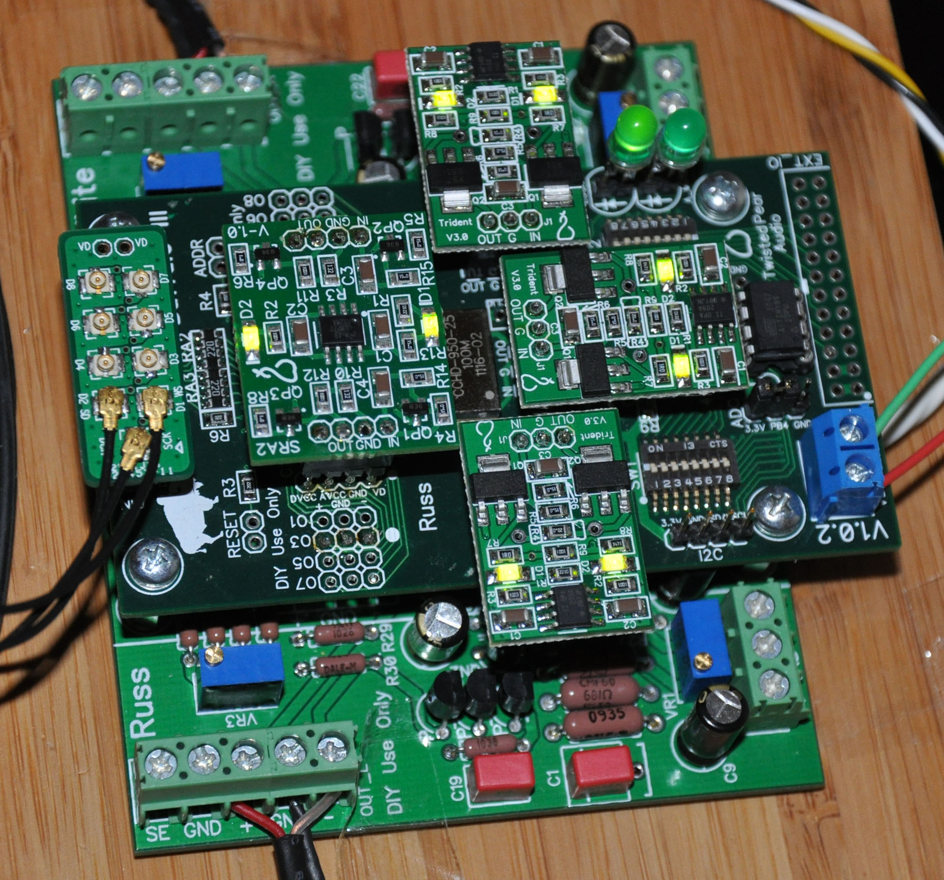

Need a bit of help...
Put together my BIII with Legato 3.1
Tested voltages before connecting...all ok:
5.25 V for BIII rock steady.
+- 12 V for Legato 3.1.
SDTRANS had been playing for ages with SPDIF and a TDA1541 DAC so ..tested!
Now connected i2S via UFl cables...mute and lock leds cycle once on boot up them lock remains on when SDTRANS is connected so...ok.
Connected so :
SDTRANS BIII
LRCK D1
SDAT D2
DCLK DCK
GND GND
But... all i get is dead silence.
I did check balanced output Dc offset...adjusted ok to 0V.
I have set up the underside straps according to Bunpei's suggestion to emulate BII:
1 . shunt JDSD1 and JDSD2.
2 . Wire D4 to D6 on card edge.
3 . set SW2-8 ON.
I should now be able to play PCM and DSD tracks with BIII detecting automatically.
I did put the strap on ADC to connect 3.3V to PB4 not to use internal volume control.
All switches on SW1 and SW2 are OFF except SW2-8 ...that is ON.
Also soldered straps J1,J2,J3,J4,J5,J6,J7,J8,J9,J10,J11,J12
But as i say...all i get is perfect silence except tiny "pop" when lock cycles on and Off.
Since this is the first time i test a BIII i tried to research as much as possible but...no dice.
Any help welcome.

New Firmware
Just a note.
Anyone who got the latest firmware update needs to know that the switch states are reversed in this release to work around a bug related to the port expander.
Otherwise the setting are the same as the integration guide.
This makes it work more like the B3SE which also used the reversed switch states for the same reason.
Sorry for not mentioning this earlier on the site.
Cheers!
Russ
