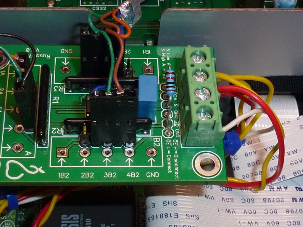

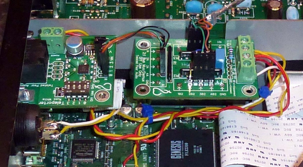

I have an OTTO II and Teleporter in a modded Denon 3910 that exports I2S/DSD. (OTTO corrects the R and L channel reversal of DSD output as it shares two circuits with PCM). I snagged 5v off one of the existing boards in the Denon, which I presume would be clean power considering the use. It sounds fantastic.
My SPDIF 4 has only been powered by a TP LCDPS set to 4.75 w/multiple outputs connected and no issues with SQ there either.

Aha I see no ceramic cap on that Otto II ?
